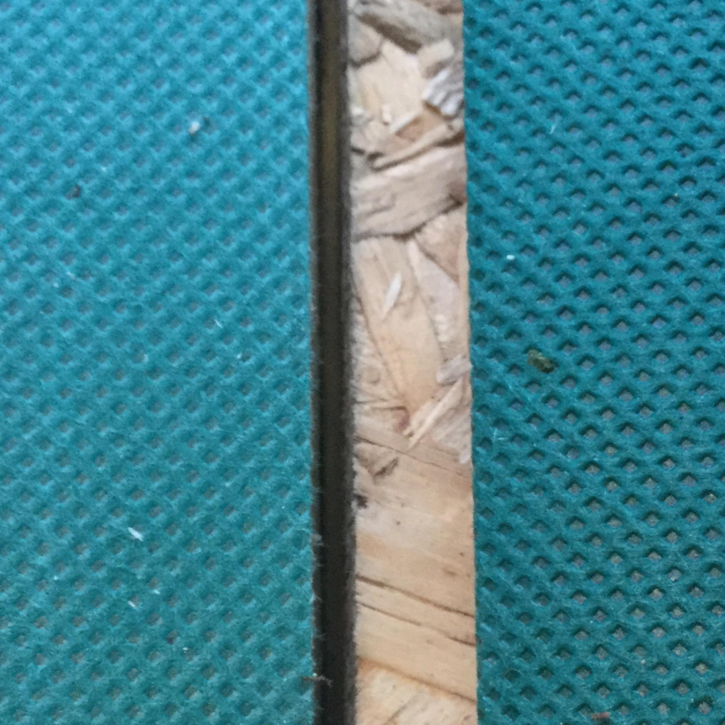

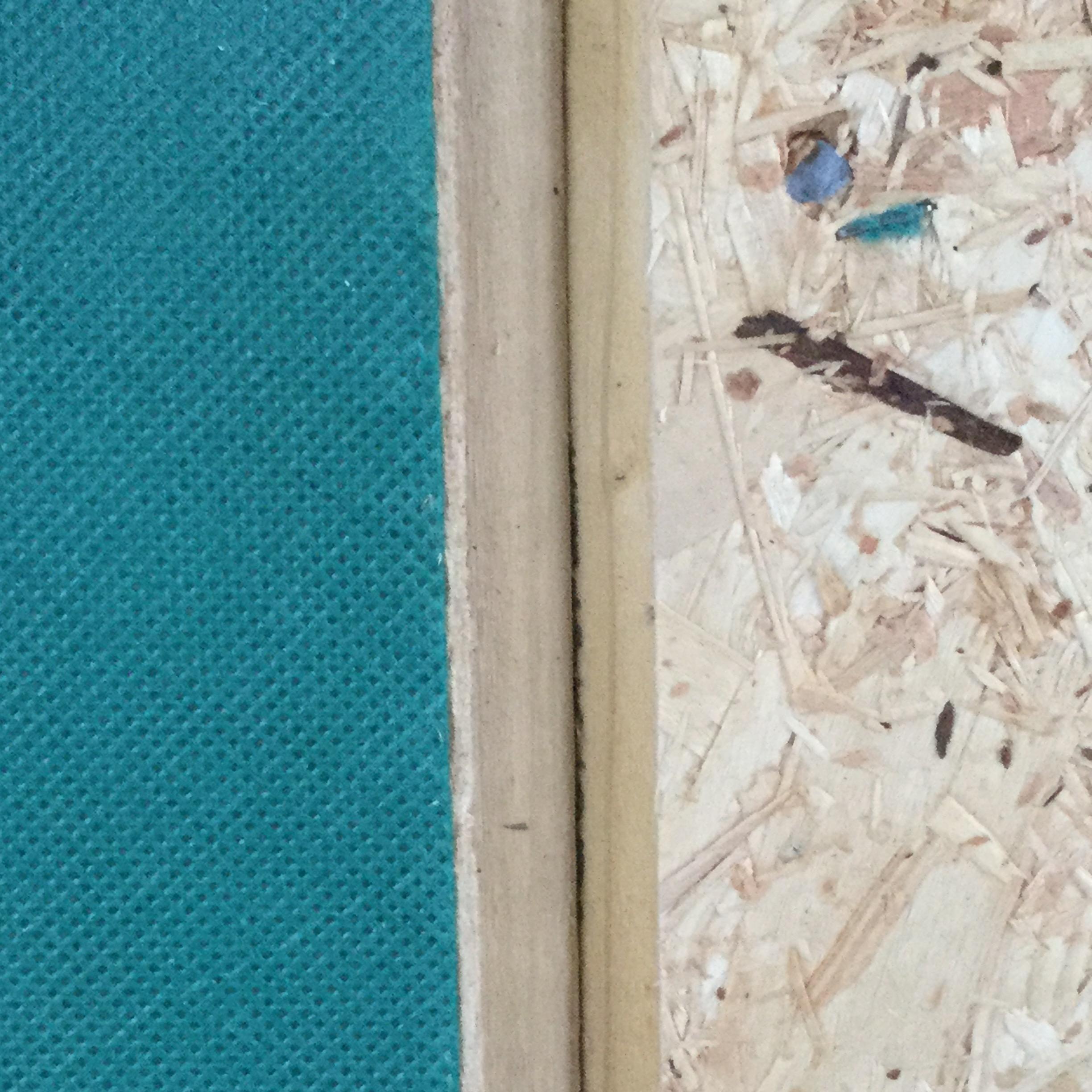

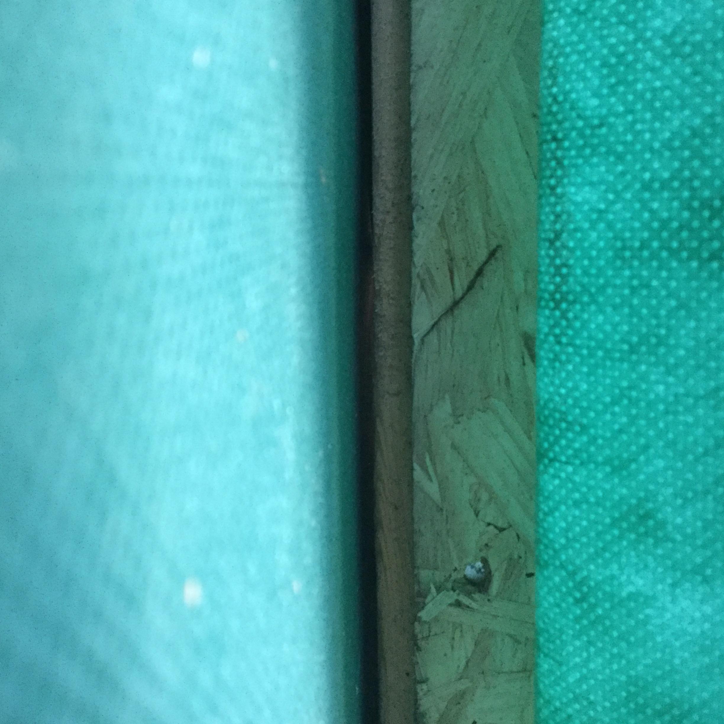

Triassic Posted February 25, 2019 Share Posted February 25, 2019 (edited) So the timber frame is up and I need to start my air tighness regime. So where do you start? Is a simple as making sure the house wrap membrane is neatly fastened down and the internal vapour membrane is complete? Would you, for example, fill any obvious holes in the timber frame and cork any gaps before fixing the exterior membrane down? Here’s a few examples. Edited February 25, 2019 by Triassic Link to comment Share on other sites More sharing options...
Jeremy Harris Posted February 25, 2019 Share Posted February 25, 2019 I went around our frame and sealed up every small external gap I could find with expanding foam. The main areas where I found small gaps were along the eaves and verges, although I'm not sure that they were worth bothering to seal up, really, as the blown cellulose forms a pretty good airtightness barrier. One thing I did add was additional external insulation along the verges, in the overhang ladder frames. I did this to help reduce the natural geometric thermal bridge that is present at any angled junction. Again, I'm not convinced it was worth the effort, but I had some cans of foam and offcuts of foam insulation, plus a week of spare time with nothing much else to do, so had nothing to lose. Well worth stapling membrane over any exposed timber, though, if only to help prevent insects getting in. Link to comment Share on other sites More sharing options...

TerryE Posted February 25, 2019 Share Posted February 25, 2019 5 hours ago, Triassic said: So the timber frame is up and I need to start my air tightness regime. Since you're an old forum hand, then I can afford a bit of gentle sarcasm: well before you erect the frame -- oops too late. ? My underlying point is that your TF company and erectors should have integrated air tightness design features into the erection. In our case the TF supplier wrapped the joist ends with airtightness membrane (see pic below before they brought the top layer back in-front of the next stage cassets); they used a special "green" OSB3 which has a high-spec airtight surface, and every joint was properly taped. You can do the same in retrospect but it's a lot of work, especially around all fenestration and joist-ends. Link to comment Share on other sites More sharing options...

Triassic Posted February 26, 2019 Author Share Posted February 26, 2019 (edited) 8 hours ago, TerryE said: Since you're an old forum hand, then I can afford a bit of gentle sarcasm: well before you erect the frame -- oops too late. ? My underlying point is that your TF company and erectors should have integrated air tightness design features into the erection. In our case the TF supplier wrapped the joist ends with airtightness membrane (see pic below before they brought the top layer back in-front of the next stage cassets); they used a special "green" OSB3 which has a high-spec airtight surface, and every joint was properly taped. You can do the same in retrospect but it's a lot of work, especially around all fenestration and joist-ends. Being an old hand, my floor cassette was installed correctly. It’s the expansion gaps in the OSB on the outside of each panel I’m pondering calking up, before fixing the flap of external membrane in place. Edited February 26, 2019 by Triassic Link to comment Share on other sites More sharing options...
scottishjohn Posted February 26, 2019 Share Posted February 26, 2019 (edited) think its as simple as you suspect it is ,but are wanting someone to tell you it don,t matter .LOL bung up every gap you can see and wrap it all and seal or staple it all down with decent overlaps you will never get at these bits again Edited February 26, 2019 by scottishjohn Link to comment Share on other sites More sharing options...
Triassic Posted February 26, 2019 Author Share Posted February 26, 2019 19 minutes ago, scottishjohn said: think its as simple as you suspect it is ,but are wanting someone to tell you it don,t matter .LOL bung up every gap you can see and wrap it all and seal or staple it all down with decent overlaps you will never get at these bits again It’s always worth checking ! The next question is what sort of sealer to use to fill gaps in wood? Link to comment Share on other sites More sharing options...
TerryE Posted February 26, 2019 Share Posted February 26, 2019 We did a lot a hammer stapling and tidying of our external tenting layer and made sure everything was correctly overlapped and fixed, but this was more to do with vapour control and had nothing to do with airtightness as this was achieved by the internal sealing layer. We had a pumped cellulosic filler for insulation and this effectively eliminated the risk of any convention loops / paths within the cassette panels themselves. We didn't bother trying to close any tiny airgaps in the external Panelvent layer. I am really not sure what if anything doing this would achieve. The one thing that we did do was to ban all of our trades attempting to put any services of fixings through the walls: where these were needed, then (as I've posted before) we installed the appropriate pipe openings front to back ourselves and sealed these. These pipes were then foamed and sealed after the wires or whatever have been pulled through the pipe. In the case of the out skin wall-ties, we marked the centre line of the framing on the outer tenting, and all ties had to be screwed in at the lines to ensure that they were screwed into the backing CLS, but this was more a structural requirement than an airtightness one. Link to comment Share on other sites More sharing options...
