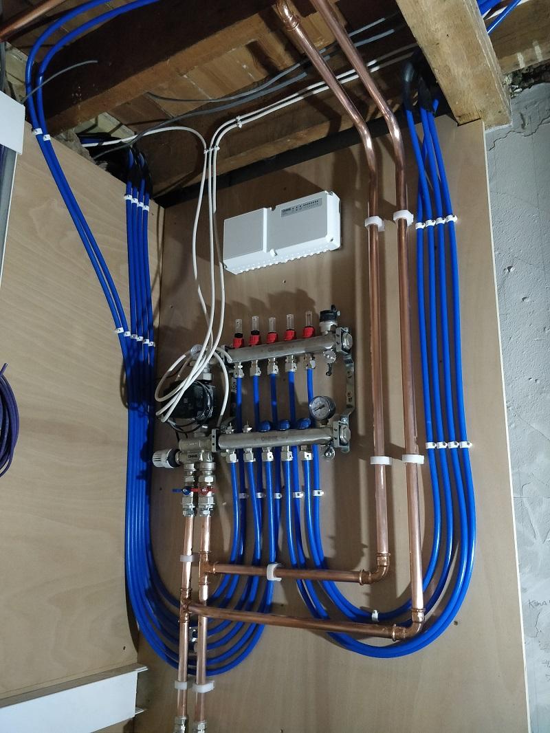

Triassic Posted February 25, 2019 Posted February 25, 2019 All my first floor UFH pipes are in the ceiling spaces of the plant room below. Does anyone produce a top entry manifold, or am I going to have to loop every single pipe through 180 degrees to have them enter from the bottom? Photos of how you did it would help.

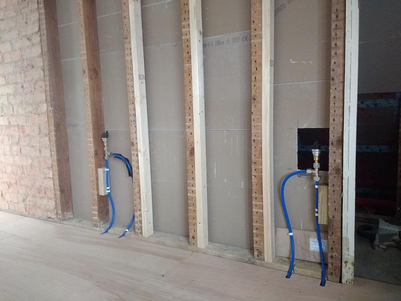

AdamSee Posted March 4, 2019 Posted March 4, 2019 I've got the Omine Torfloor system and was advised that I needed the auto air bleeding vents because of the manifold being downstairs and as others have mentioned, theres not enough of a flow rate to flush out the air. There pretty easy to put in, but in hindsight. I really should have put the manifold in upstairs, which ironically would have been right next door to the new boiler. Live and learn I guess. 1

AdamSee Posted March 15, 2019 Posted March 15, 2019 There actually accessible from the alcove space behind them. At the time of that photo I had only cut the hole for one of the vents. But you can now walk/crouch in to the alcove and open a small hatch and service them. There pretty good the way they work. You just open the side valve and you hear the air escape but it doesn't seem to let the water out with it.....unless you open the bicycle looking valve on the very top. Just finished the entire upstairs UFH installation now and hopefully next week it will be up and running. I know its sad...But I'm pretty happy with how this setup looks, seems a shame to have to hid it in a cupboard.....but if one of my nephews sees that lovely valve and decides to open it, the entire system will get dumped into my living room.
