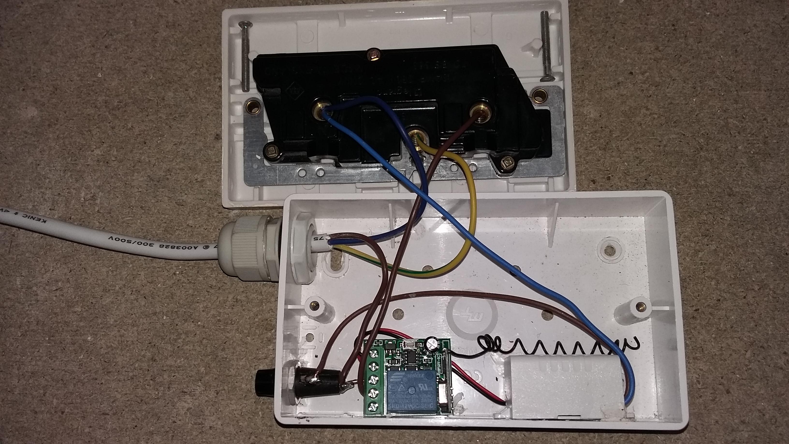

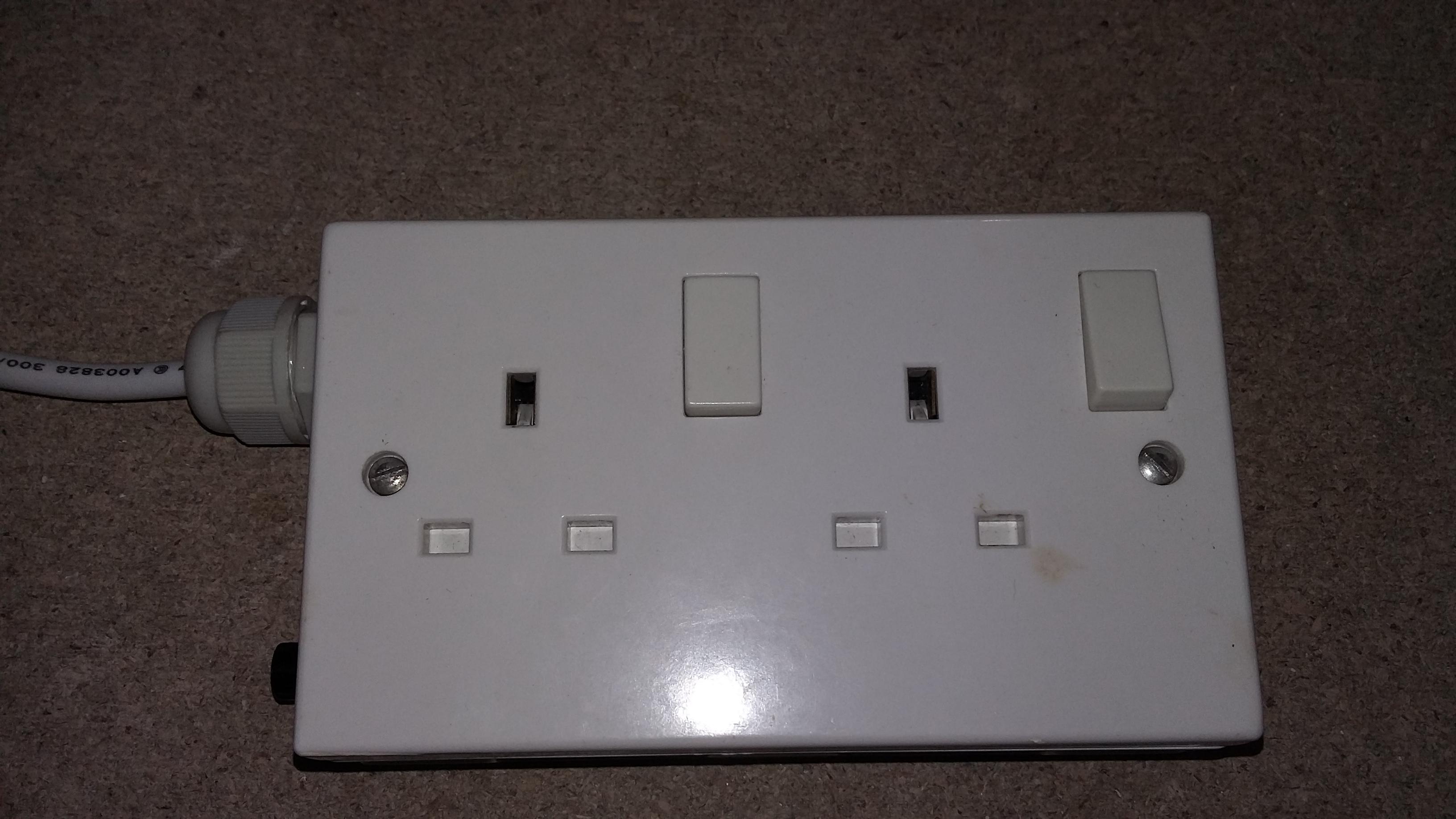

ProDave Posted October 6, 2019 Author Posted October 6, 2019 That's the 433MHz transmitter integrated into the dump controller. I was going to mount the receiver with it's relay into one of my portable convector heaters, but can't see any easy way to do that. Instead I am going to make it more general purpose in the form of a wireless controlled switched extension lead. Simply a double 13A socket mounted in a 47mm deep back box that will have enough depth for the 433MHz receiver module and a small 12V power supply to feed it fitted in the bottom of the deep back box. Of course I didn't have a suitable little 12V power supply so that is now on it's way from Hong Kong. I did the "car test" and find when the transmitter is energised, now it is in it's final location, it does affect my car key fob slightly, but only in so far as I need to be closer to the car to make it work than normal. I can live with that. (When I had it on test on the bench, further away from the car, it didn't make any difference to the car keyfob range) I will need to quietly do the same test with SWMBO's car when she gets back.... EDIT: Tested, hers is not in the least disturbed by this 433MHz transmitter so should not be any "issues"
ProDave Posted November 11, 2019 Author Posted November 11, 2019 last bit arrived from China today, so that's my RF switched 13A socket completed. Bottom left is the £1.54 433MHz receiver with relay output, And bottom right inside the white box is the £1.49 12V power supply. I have tried it and it works, but now the solar PV output is well on it's way down the "winter cliff" I don't think it will switch on in anger now until the spring. 1
