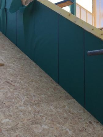

Triassic Posted February 23, 2019 Author Posted February 23, 2019 To which element did you fasten it, the wall as shown above, or did you fasten it to the render board, if so now?

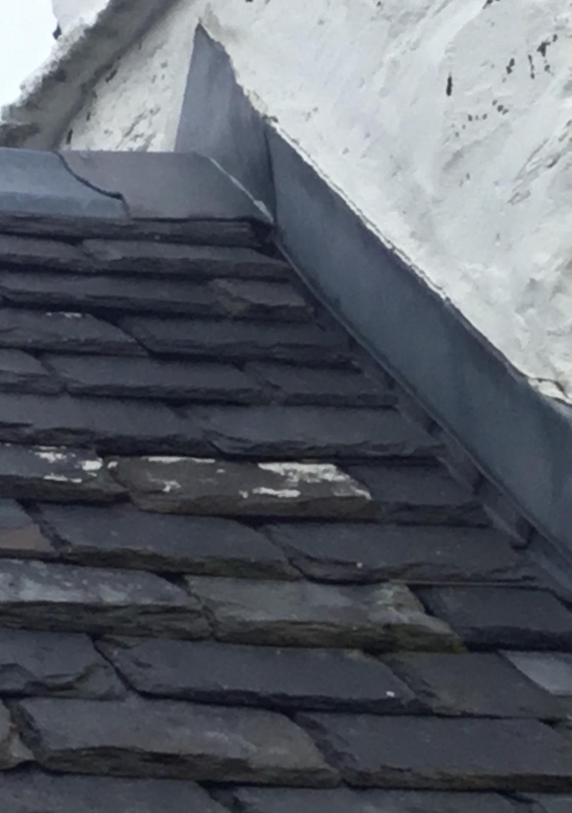

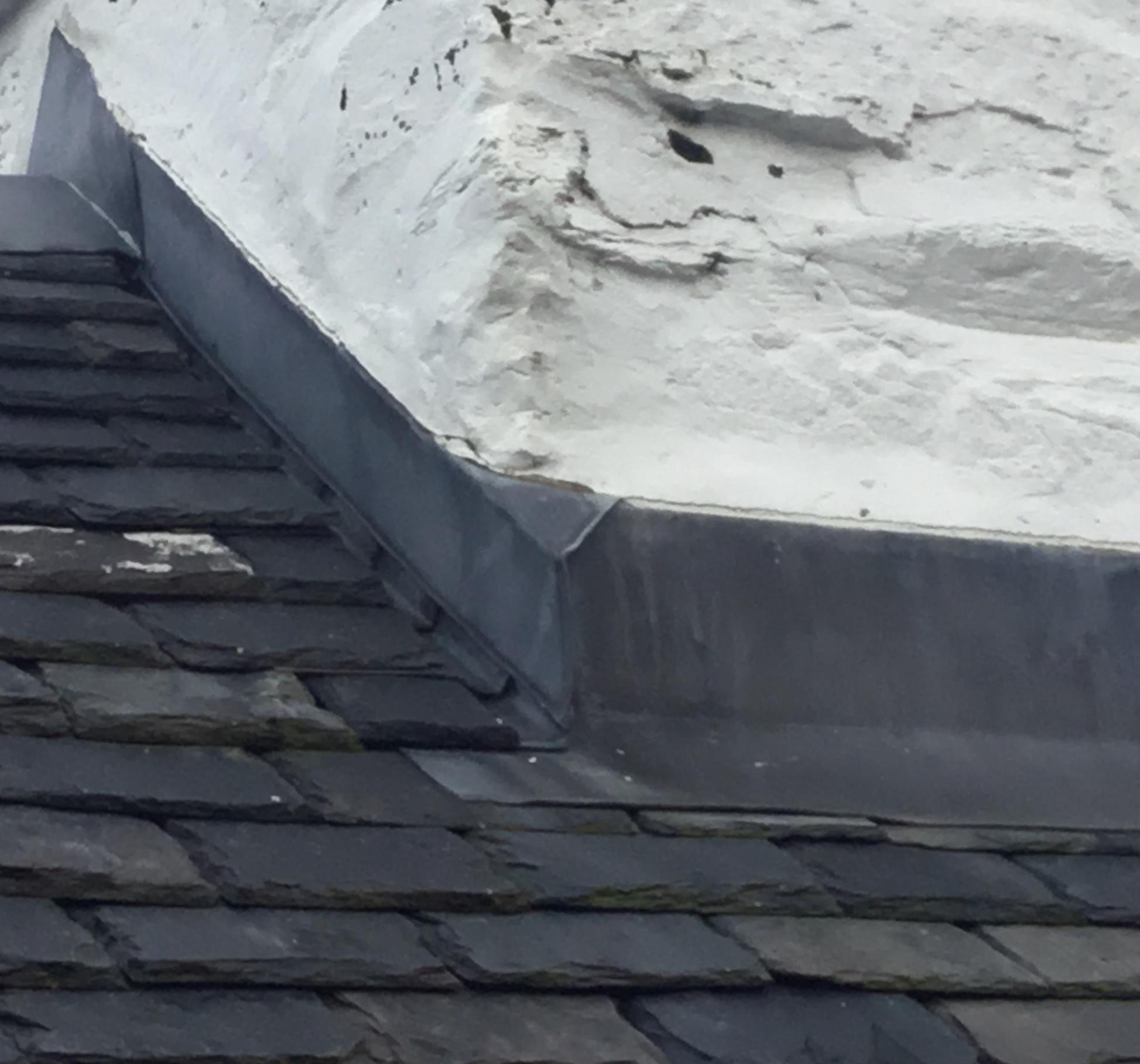

Cpd Posted February 23, 2019 Posted February 23, 2019 I have not done this on a modern build...... but I used lead. I made lead gullies and lapped them into a cut line on the stone wall. I must say that I am not very pleased with the gullies as they can get leaves and moss stuck in them and the water can track back onto the roof membrane. was I doing it again I would use soakers. So to answer your question (non expert) i would use high quality (probably not lead) soakers and attach them to the wall and then Use some sort of cover strip that you render down to to get a clean crisp edge. Your fixing points are all covered and sealed and it will look great. I look forward to hearing how it’s “properly done “ !

Cpd Posted February 24, 2019 Posted February 24, 2019 What I call soakers..... are single L shaped pieces of thin metal that slot under each slate and go up the wall, they then have a cover strip over them to prevent water ingress from above. This is my chimney where I used lead as I needed to mould it round the tradional slates as you can see the piece under the lead extends quite a way so even if you got a moss or leaf build up in the corner water would not be able to back up and cause any problems,

Cpd Posted February 24, 2019 Posted February 24, 2019 23 minutes ago, Ed Davies said: Thanks @Cpd, very useful description. I guess the key is that the metal is mailable enough to conform reasonably well to the bottom of the slate so provide enough of a seal that water does run under the slates much? Russell’s description is right. However because I am using very traditional slates they can be up to 15mm or more thick and when you’ve got them all overlapping it can soon add up to a thick layer of stone.... I also live in a very windy location and if I did not have a malleable material there would be a big old gap below each soaker and therefore I use lead as I can form it up and around the slates and then run it under the slate to beyond the next slate joint or wherever I feel is appropriate. The Lower part of lead you see in my photo is the chimney breast skirt as shown in the photo below. I like using lead as it’s fun to work with, I have learnt to solder it with very good results, clean joints that have not failed in 6 years so far. On a modern build I really don’t think you would need it as there are great alternatives that and cleaner and will give a much more crisp finish. 1
