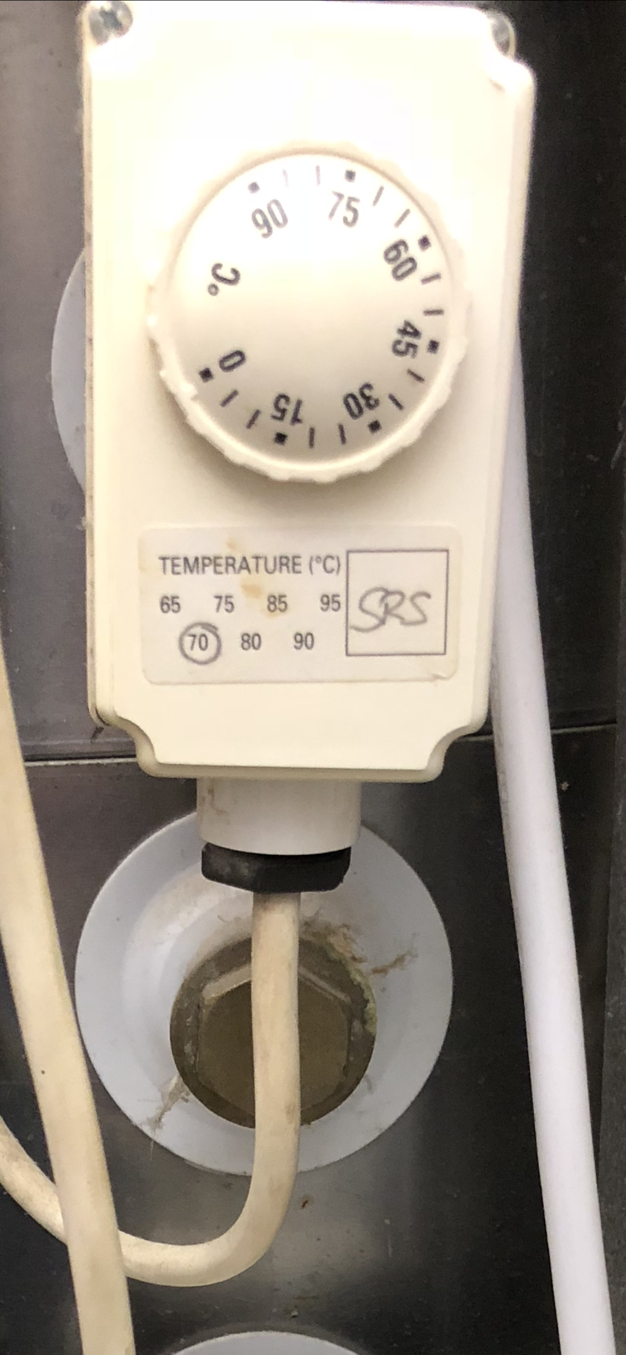

vfrdave Posted June 14, 2019 Author Share Posted June 14, 2019 I eventually ordered my thermal store from Trevor @ cylinders2go. Super pleased and we'll impressed confirmed order Monday received thermal store today in Northern Ireland. Thanks for the recommendation @Nickfromwales One query the aquastat supplied only goes to 65 degrees, surely I will need one that goes higher for a thermal store? Can anyone point me in the right direction, any I have looked at are 65 max. Link to comment Share on other sites More sharing options...
Temp Posted June 14, 2019 Share Posted June 14, 2019 (edited) I have a single mid height stat on my thermal store set to 50C but I only have DHW and UFH (no rads). Seems plenty hot enough for showers and washing up. Edited June 14, 2019 by Temp Link to comment Share on other sites More sharing options...
newhome Posted June 14, 2019 Share Posted June 14, 2019 This is what I have on mine. The top stat is set at about 65 though and does pretty hot DHW (I have to mix with cold when running a bath). I don’t have rads though. Link to comment Share on other sites More sharing options...
PeterW Posted June 14, 2019 Share Posted June 14, 2019 Depends which port it goes into, but at 65c 1/3rd down you will have 75c at the top. Plenty to go at. Link to comment Share on other sites More sharing options...
vfrdave Posted June 14, 2019 Author Share Posted June 14, 2019 3 minutes ago, PeterW said: Depends which port it goes into, but at 65c 1/3rd down you will have 75c at the top. Plenty to go at. Never thought of it like that. I have stat pockets at third and two thirds down. Link to comment Share on other sites More sharing options...
