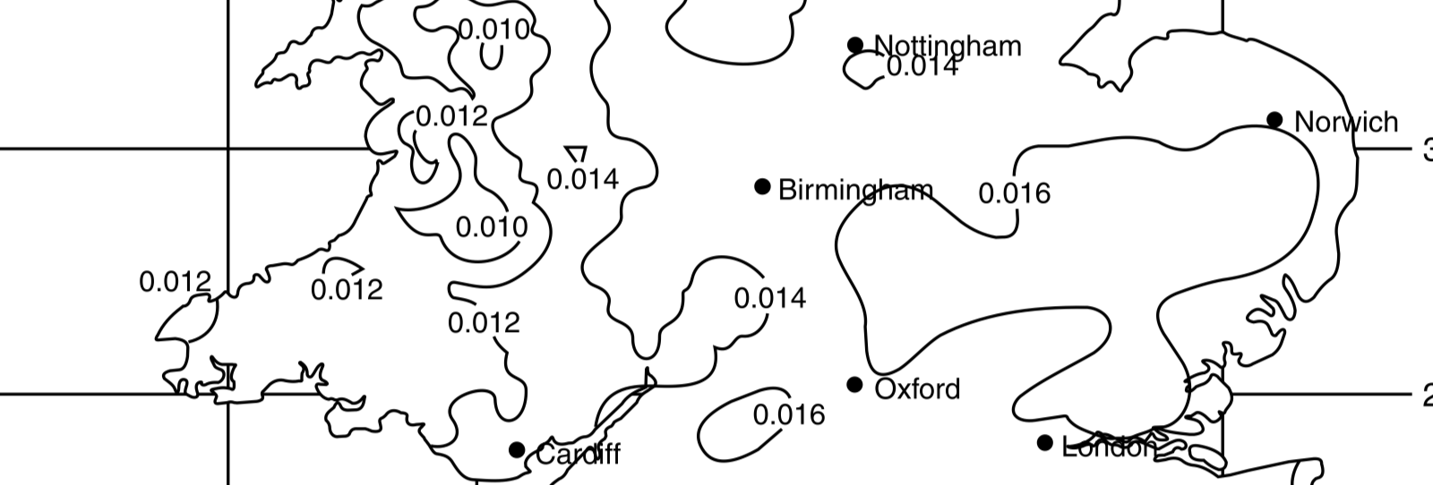

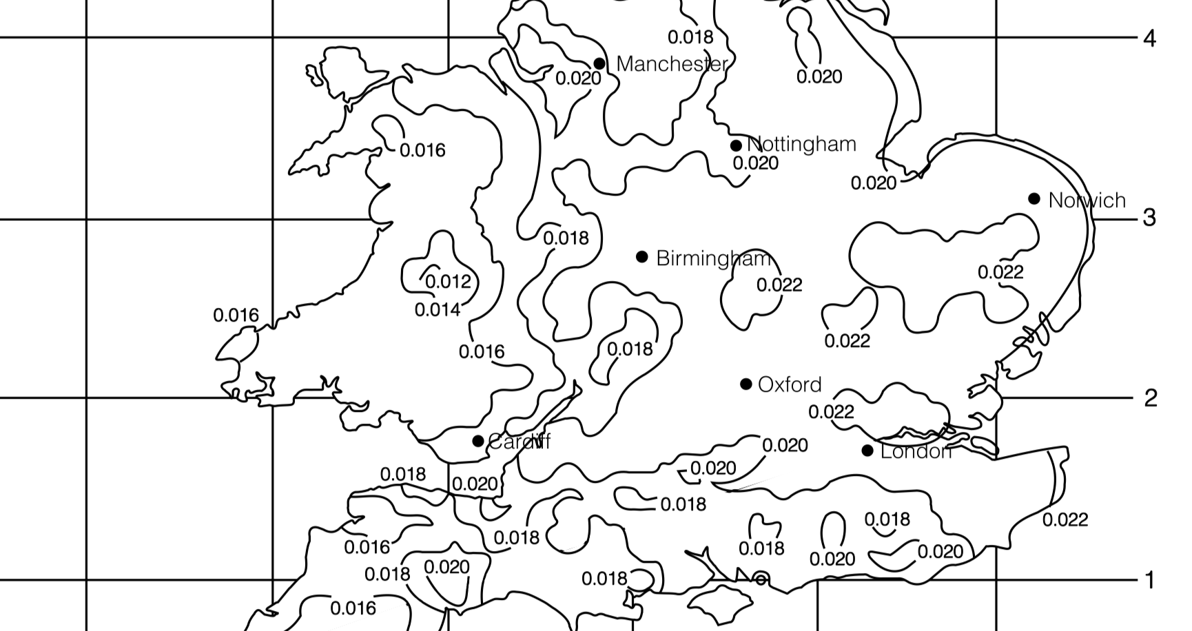

Dreadnaught Posted February 18, 2019 Author Share Posted February 18, 2019 3 minutes ago, Mr Punter said: 0.016l/s/m2 so 0.016 * 120 = 1.92l/s. Thanks! When I look at the map in the Building Regs for Rainfall intensities below for "design of gutter and rainfall pipes (litres per second per square metre)", why is the intensity higher in East Anglia (0.020 or 0.022) than say Pembrokeshire (0.016) when East Anglia has some of the lowest rainfall in the country? Seems counterintuitive. Link to comment Share on other sites More sharing options...

Jeremy Harris Posted February 18, 2019 Share Posted February 18, 2019 9 minutes ago, Dreadnaught said: When I look at the map in the Building Regs for Rainfall intensities below for "design of gutter and rainfall pipes (litres per second per square metre)", why is the intensity higher in East Anglia (0.020 or 0.022) than say Pembrokeshire (0.016) when East Anglia has some of the lowest rainfall in the country? Seems counterintuitive. I agree, every time I've looked at this there seem to be apparent anomalies, but I suspect that's to do with it being an intensity map, rather than a rainfall map. Places on the West coast of Scotland, for example, are well known for being very wet, but they don't tend to get lots of very heavy rainfall, it just rains gently every other day... Link to comment Share on other sites More sharing options...

epsilonGreedy Posted February 19, 2019 Share Posted February 19, 2019 14 hours ago, Dreadnaught said: why is the intensity higher in East Anglia (0.020 or 0.022) than say Pembrokeshire (0.016) when East Anglia has some of the lowest rainfall in the country? Seems counterintuitive. Days of non stop Welsh drizzle does not = intensity. We get more summer tropical downpours in the east I guess. Link to comment Share on other sites More sharing options...
Dreadnaught Posted February 19, 2019 Author Share Posted February 19, 2019 (edited) 1 hour ago, Mr Punter said: Oh dear I was using the paved are data. Should be 2.64! Ah, I think you were right the first time @Mr Punter. Reading through it all, the rain-intensity figures for drainage come from Diagram 2, which also mentions "underground rainwater drainage", not Diagram 1 which is what I showed and is for roof drainage. As follows under "Section 3: Surface water drainage" … Quote 3.8 Design rainfall intensities of 0.014 litres/ second/m2 may be assumed for normal situations. Alternatively the rainfall intensity may be obtained from Diagram 2. From diagram 2… So I should use 0.014 or 0.016 l/s. Now, I just need an exact measure of the roof area including the overhangs from my architects drawings. I suspect it is a bit greater than 120 m². But even if the drainage rate exceeds 2 l/s I suspect it won't do so by much so a little attenuation is all that I will need to hopefully fall into compliance and satisfy the drainage person in the local planning department. The drainage person was adamant that any attenuation device would need to be "permanently installed". I presume they have instances of a modified water butt doing the job which was whipped away as soon as their backs were turned. I am not sure what permanently installed means in this context. And she also said that a water butt would not do anyawy as it could be full on the day of a deluge and so do no attenuating. This has been very helpful. BuildHub continues to amaze! Thanks to everyone. Edited February 19, 2019 by Dreadnaught 1 Link to comment Share on other sites More sharing options...

Dreadnaught Posted February 19, 2019 Author Share Posted February 19, 2019 34 minutes ago, epsilonGreedy said: Days of non stop Welsh drizzle does not = intensity. We get more summer tropical downpours in the east I guess. Good point. As @JSHarris also mentioned. That sounds like the answer. It is interesting to consider why the figures in Diagrams 1 and 2 in the Building Regs are so different. Both measure rain intensity but one is for gutter sizes and the other for underground drainage pipes. It is unclear to me why it pays to oversize gutters but not underground pipes. Link to comment Share on other sites More sharing options...

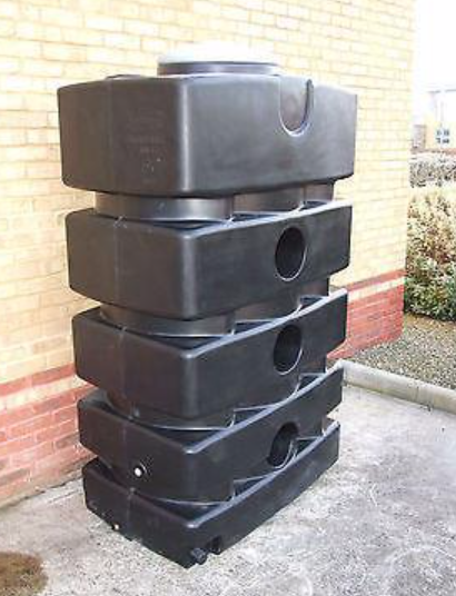

epsilonGreedy Posted February 22, 2019 Share Posted February 22, 2019 3 minutes ago, Dreadnaught said: Thanks @PeterW. That's very helpful information. Am reading it all now Is the type of tank shown in your photo suitable? It is more than a matter of capacity as the tank needs to soak away or drain somewhere at an attenuated rate. Underground crates are often used wrapped in a water permeable fabric. Link to comment Share on other sites More sharing options...
Dreadnaught Posted February 22, 2019 Author Share Posted February 22, 2019 5 minutes ago, epsilonGreedy said: Is the type of tank shown in your photo suitable? It is more than a matter of capacity as the tank needs to soak away or drain somewhere at an attenuated rate. Underground crates are often used wrapped in a water permeable fabric. Good question. I think it is suitable. But I will double check with the supplier. Unfortunately, I can't have a crate-based soak away because none of my site is 5-metres from a building (a building regs restriction I think). Therefore the rain water will go into said tank and then drain slowly (at 2 l/s) into storm water drain in the road immediately in front of my plot and thence into the river just 40m away. Anyhow that's what I hope planning will agree to. Link to comment Share on other sites More sharing options...
epsilonGreedy Posted February 22, 2019 Share Posted February 22, 2019 8 minutes ago, Dreadnaught said: ... Therefore the rain water will go into said tank and then drain slowly (at 2 l/s) into storm water drain in the road immediately in front of my plot and thence into the river just 40m away. Anyhow that's what I hope planning will agree to. Sounds like a plan, I guess you have the gradient to drain from the bottom of the tank into the storm water drain? Link to comment Share on other sites More sharing options...
