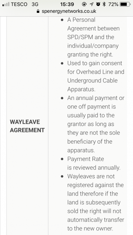

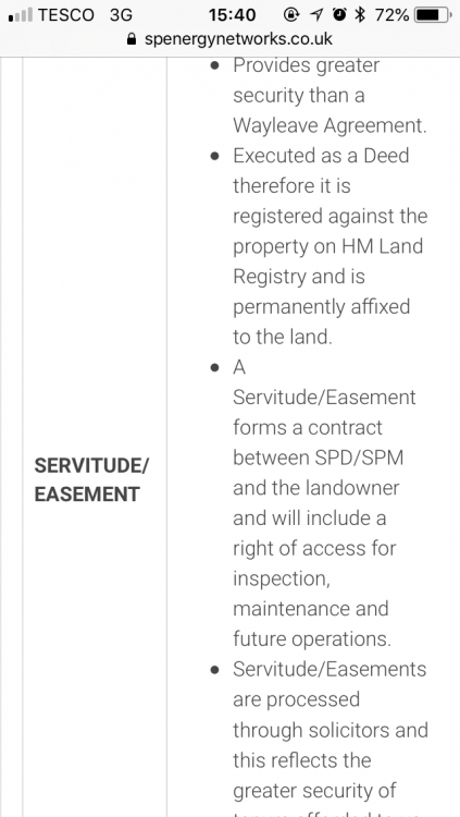

I think that the situation around sales of properties is more ambiguous in practice. When we had electricity cables removed, they were quite happy to proceed on the basis of a wayleave from 1958 and three owners ago.
”Bare Wayleave” sounds like an arsecovering word for “O Fook, we haven’t got a Wayleave”. Or perhaps it may be the legal minimum that automatically exists with a cable and no other documentation or agreement.
Really? I thought it sounded like an arse uncovered word! :D
Must be the legal minimum I guess. 'Implied' may be what it means, after all they gained permission to put the pole up (possibly) way back when.

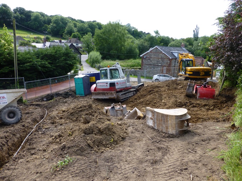

I thought it would be useful to update on this long running saga as there are a few points that may be helpful to others.
I have chased SSEN again for an update on progress with planning the rerouting / undergrounding of the cable.  The response was an email telling me they are really busy and will not get back to me for a long time, for a second time they said in the email if I want it done quicker I can always pay them to do it.  It seems pretty clear to me that they have a clear policy of trying to avoid cost by delay, delay and further delay.
As it is almost 6 months since they applied for a Necessary Wayleave I was thinking ahead to notification by BEIS that the 6 month abeyance period had ended.  I wanted to check that they would write to me at my current address and would not try to send the letter to the plot.  I was really surprised when having left a message for the person I was put through to at BEIS they called me back, I had expected that I would have to keep trying, I could not take the call but they even gave me their direct dial number in the message they left.  I was very impressed.
I called them back and spoke to them yesterday afternoon, there person I spoke to had taken the time to look up my application before they called me so was up to speed with the application details.  They told me the following:
I) BEIS has had a massive increase in Necessary Wayleave applications recently.
II) The application relating to my site has yet to be validated by BEIS because of the backlog caused by the increase in applications (mine is in the next batch due to be reviewed in the next couple of weeks).
III) The six month abeyance period does not begin until the application is validated.
IV) That BEIS will write to me when the application is validated and I can refuse to have it put into abeyance - I did not realise this before.
Given the experience of some people in the past recounted here, versus my and other's recent experience, I get the impression that SSEN and possibly other DNOs are taking a much harder line now and trying much harder to avoid the cost of moving their equipment.  This could also explain the recent surge in Necessary Wayleave applications BEIS has experienced.
As soon as I receive notification from BEIS I will immediately respond refusing to accept the application goes into abeyance given SSEN's lack of engagement over the 9 months since my removal notice was served.  I will then email the legal team at SSEN telling them I have blocked abeyance and reiterate the offer made to their wayleaves team where they move the cable at their expense in exchange for me agreeing an easement.  Given experience to date I will insist that a clause is included in any agreement that they have to carry out the work in a stated period.
Hopefully if anyone else is in a similar situation now or in the future they will find this information helpful
Edited by Randomiser
