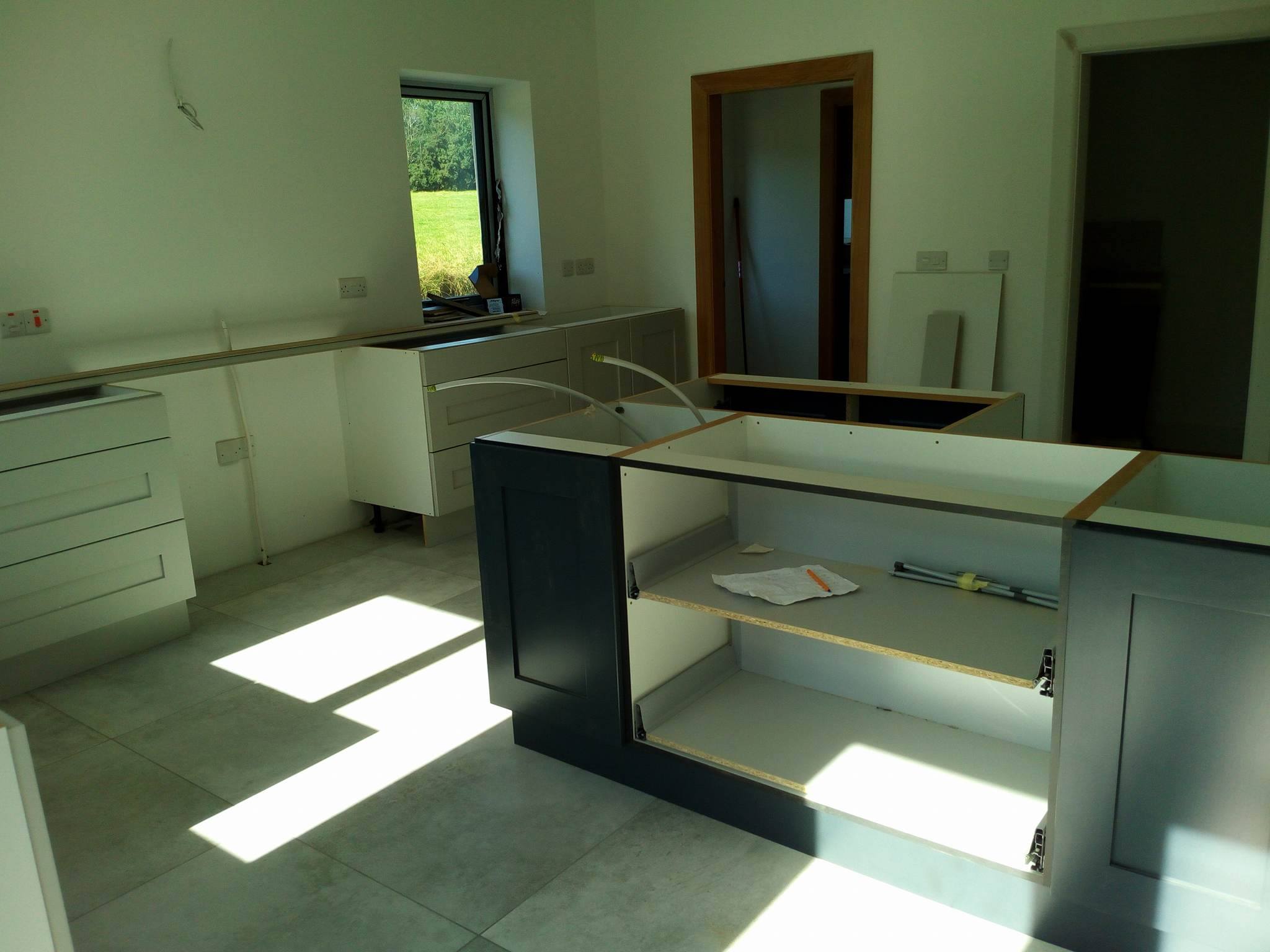

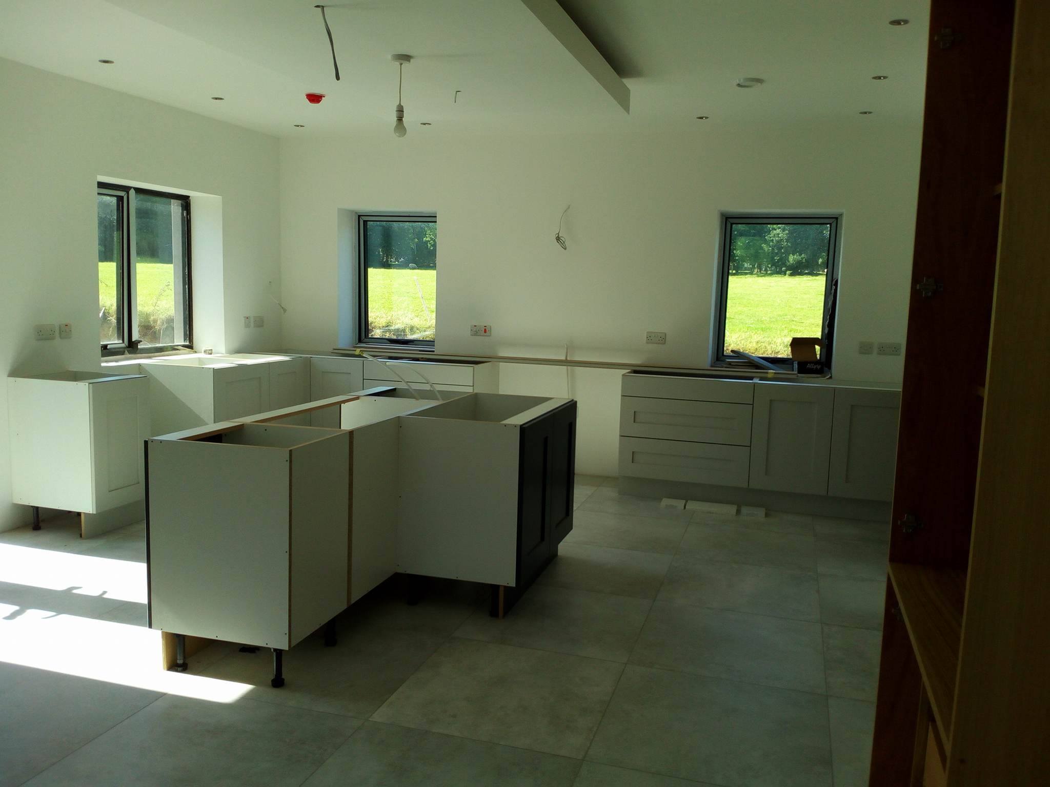

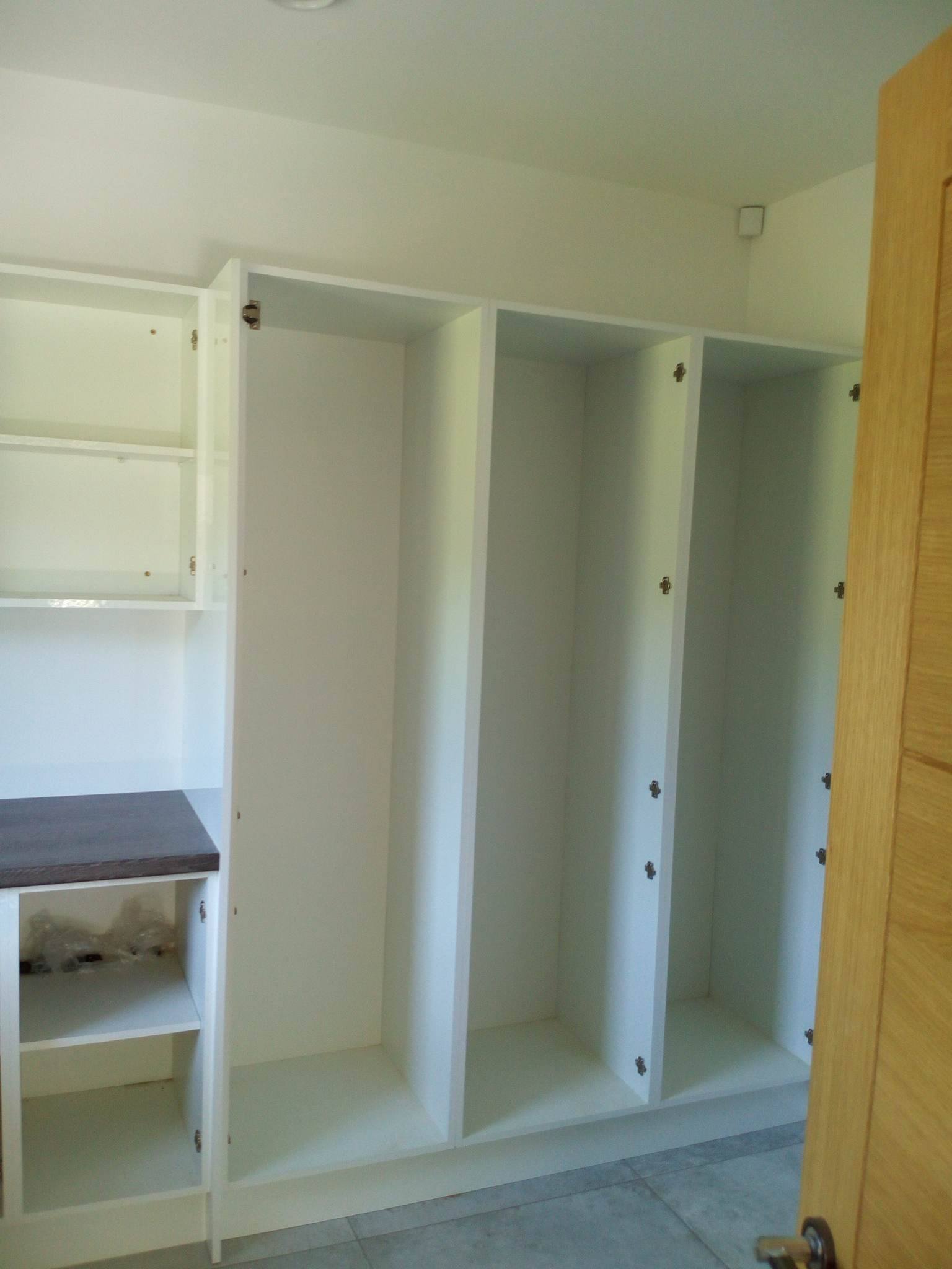

Shell820810 Posted August 16, 2016 Share Posted August 16, 2016 Kitchen has been going in today. Please with it so far bar a few things. Main issue is utility room. We have high ceilings so it was verbally agreed on two occasions (and i think he had written it on his spec sheet, but I never got a copy, nor signed a copy) that we would have 900mm wall units as opposed to standard 720mm. They installed 720mm. Theres an awfully large gap between unit top and ceiling, and I think it looks a bit daft. 2 wall units and 5 full length units affected. Secondly, we have a navy island, as photographed. 3 doors on so far and paint chips (nothing major, but noticable) on edges of all (assume from transporting/fitting) Thirdly, wrong corner unit installed, but I have emailing confirming what I want so he will have to change it. What would your expectations be regarding the island and the utility units? 1 Link to comment Share on other sites More sharing options...

Nickfromwales Posted August 17, 2016 Share Posted August 17, 2016 Most kitchen suppliers, especially the bespoke ones, charge tear-jerking amounts of money to give you what you wanted. At the absolute minimum I'd want the coloured doors replaced completely, and either the wrong units changed or the equivalent discount given. The real problem is you don't have written evidence of that request so looks like you'll only be able to push for a discount. They could simply tell you to Foxtrot Oscar regardless, change the doors and ask you to stump up, and from a legal POV they'd be entitled to do so. Down to company ethics now tbh. Mention the thread being followed online, and how you've been happy up until now. Also, how did you not notice the wall units sooner? I've just tiled a kitchen with a 600x600mm tile that's very much like the ones you've chosen. Looks great Are those 900's? Link to comment Share on other sites More sharing options...
Barney12 Posted August 17, 2016 Share Posted August 17, 2016 4 hours ago, Shell820810 said: Should touch ups to the paint be suggested, do you think its a fair outcome? (Units were sprayed so will be noticable) As Nick said they should be replaced or the very least professionally repaired so they look like new. Link to comment Share on other sites More sharing options...
Declan52 Posted August 17, 2016 Share Posted August 17, 2016 If its not right it needs fixed end off. You didn't order doors with paint chips so they need replaced. A touch up will always be noticeable. Will never match in with the original look of the doors. The corner unit should be easy fixed. The wrong wall units will either need to be changed or a good discount given as they are not what you wanted. Don't let them continue any more. Get the boss out and point out how unhappy you are at the amount of mistakes that have occurred and you won't let them continue until these have been sorted. Will act as a shot across the bow and hopefully make them take a but more care. Link to comment Share on other sites More sharing options...
DeeJunFan Posted August 17, 2016 Share Posted August 17, 2016 Yeah, Id be looking the chipped doors replaced or re-sprayed to make sure they look 100% On the Utility, they may not need to rip the lot out could add a smaller carcass unit above. If they aren't doing that and you have paid for the larger carcass and more importantly the larger doors (which are much more expensive) id be looking to knock a few quid off. Corner unit should be no issue. Link to comment Share on other sites More sharing options...

Shell820810 Posted August 20, 2016 Author Share Posted August 20, 2016 What is an acceptable gap between doors on kitchen cupboards. Is there any new design trend etc where a fingers width gap between doors is the norm. The carcass just looks too big for the doors?! Link to comment Share on other sites More sharing options...
PeterW Posted August 20, 2016 Share Posted August 20, 2016 Door should cover the carcass within 2-3mm - a 600mm carcass should have a min 595mm door Link to comment Share on other sites More sharing options...
Shell820810 Posted August 21, 2016 Author Share Posted August 21, 2016 On tall units I can fit a finger right between the top and bottom door, so what at least 10-15mm. I need to measure the gaps but I reckon we definitely have more than 2-3mm. Does that mean between two cupboards you would have 4-6mm mil (2-3mm on each carcass?) Doors aren't flush from one cupboard to another, heights between one door/cupboard to another could be a couple of mil out. The handles are all on. They are due back for final adjustments - are these final adjustments or are these bad fitting. Surely if they adjust them now it will knock the handles off. They are glass edge effect acrylic gloss, so perhaps the appearance of the gap is intensified by the darker edge? Link to comment Share on other sites More sharing options...
Declan52 Posted August 21, 2016 Share Posted August 21, 2016 Every door should be flush with the next one or it will be very noticeable. On a run of doors the tops should be perfectly in line which means the edge gap should be the same as the door will be plumb. the actual gaps between the doors can be adjusted on the hinge. All doors are very easy to adjust using the screws on the hinges. It's maybe 30secs work on each door to turn one the three adjustment screws. No excuse for leaving doors like you are describing. Link to comment Share on other sites More sharing options...

Construction Channel Posted August 21, 2016 Share Posted August 21, 2016 The final adjustment of the doors is the last thing I do so I wouldn't be surprised if they have left it for their return. The damaged doors need to be replaced either by the supplier or the fitter depending when it got damaged. Touch up might not be that bad. And TBF you might as well let them try that first as it will be quicker. As for the 900 wall units. You will also need to get higher larder units otherwise the new 900s will stick out the top. It is the larder units that set the height of the wall units so unless you were very clear that you wanted them all taller that one may be harder to argue. Corner units are fairly easy to adjust so that one should be an easy fix. Hth Ed Link to comment Share on other sites More sharing options...
