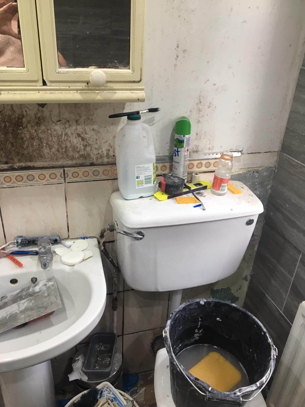

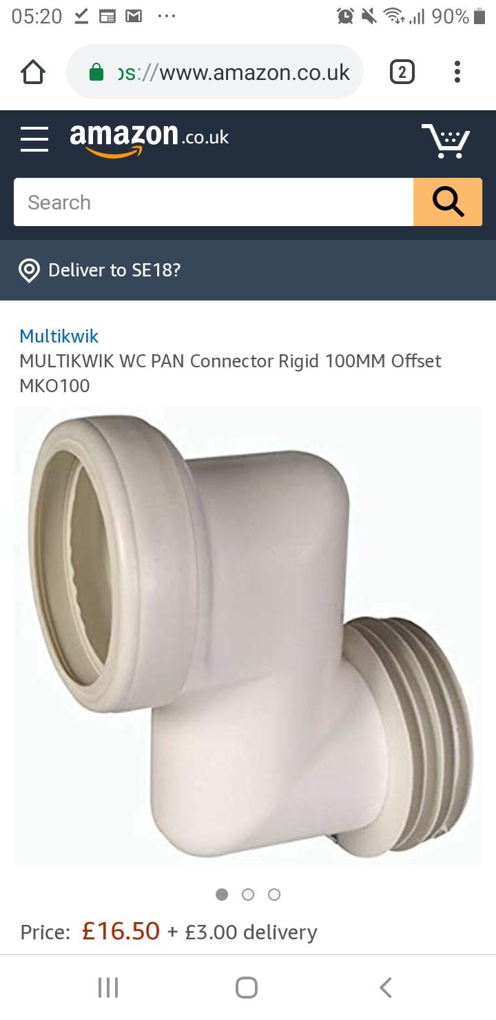

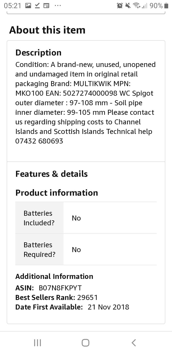

Onoff Posted May 29, 2019 Author Posted May 29, 2019 This is what he has at present: I've suggested he move the basin to the left for start. He might then build a dwarf wall out of 6"x2" to mount the Geberit frame in, likely bringing the WC position left as well, away from the radiator. Guessing you must nigh on burn your leg sitting on the throne here! I'm thinking he could use a 100mm offset adapter instead of the Geberit one and just twist it a little if he's bringing everything to the left? Might actually be better, giving leeway to adjust. This Amazon one seems bang onto cope with the pan 100mm stub to the 110mm soil. Biggest issue is the he isn't ME! He doesn't live close and whilst I'd relish the job I'm worried it'll be too much for him.
PeterW Posted May 29, 2019 Posted May 29, 2019 2 hours ago, Onoff said: I'm thinking he could use a 100mm offset adapter instead of the Geberit one and just twist it a little if he's bringing everything to the left? Might actually be better, giving leeway to adjust. This Amazon one seems bang onto cope with the pan 100mm stub to the 110mm soil. He won’t need to use the adapter - Geberit frame comes with a 90 bend so just a standard short radius elbow onto the wall and then drop the Geberit connector into it. Looks like that bathroom needs a complete strip back to bare walls and start again .... 1

dpmiller Posted May 30, 2019 Posted May 30, 2019 90deg pan connector instead of the adaptor and elbow?
Nickfromwales Posted May 30, 2019 Posted May 30, 2019 1 minute ago, dpmiller said: 90deg pan connector instead of the adaptor and elbow? You can’t with a framed WC. You need the black long pan connector @Onoff shows which gets you clear of the wall and out to the pan outlet. With a bent pan connector you’d finish flush ( lol ) to the wall but also too high as you’d be resting on the metal bar of the frame that the Geberit black bit clips to.

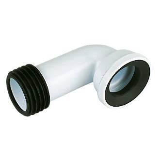

Onoff Posted May 30, 2019 Author Posted May 30, 2019 22 minutes ago, dpmiller said: no, I was thinking of *with* the Geberit long elbow but without the reducer and Clive's brown elbow, using a bent pan connector to convert it to 4" and turn it towards the wall at the same time. So you're suggesting..... One of these shoved into the 110mm pipe coming out of the wall: Then the Geberit long elbow shoved into it?
dpmiller Posted May 30, 2019 Posted May 30, 2019 yup. Dunno if Nick thinks it's a plan, but if you're trying to limit the offset to left?
Onoff Posted May 30, 2019 Author Posted May 30, 2019 1 hour ago, dpmiller said: yup. Dunno if Nick thinks it's a plan, but if you're trying to limit the offset to left? Seems a good shout to me. I really like that (i) it's cheap ?and (ii) more so, that it keeps everything closer to the wall, closer in fact than the short radius elbow. Hoping to build the dwarf wall from 145x45, Eased Four Edge Treated Carcassing. I feel for the lad doing it...if he does go ahead. I'll have a crack at ANY discipline & generally have the tools. Just hoping he's not over reaching himself. Tbh he'd be best joining the forum but isn't the sort. Lives in North London, Congestion Charge, ULEZ etc. I won't be going round there!

Onoff Posted May 31, 2019 Author Posted May 31, 2019 So... @dpmiller's idea, one of these: Pretend the brown soil is coming out of my mates wall: Should end up with a lateral movement left about 180mm if everything is cut back to the minimum: Just got to dig the Geberit frame out and see if it all works! But is this black Geberit pipe to the white rubber seal good enough?
Nickfromwales Posted May 31, 2019 Posted May 31, 2019 27 minutes ago, Onoff said: But is this black Geberit pipe to the white rubber seal good enough? Will the 80 x 110 Geberit adaptor fit into the ( lubed-up first ) bent pan connector? That is a slack junction otherwise and not something I’d do unless there was ABSOLUTELY no other choice.
Onoff Posted May 31, 2019 Author Posted May 31, 2019 (edited) 33 minutes ago, Nickfromwales said: Will the 80 x 110 Geberit adaptor fit into the ( lubed-up first ) bent pan connector? That is a slack junction otherwise and not something I’d do unless there was ABSOLUTELY no other choice. Certainly does, toit loik a toiger! So the multi, rubber flanged "male" on the bent pan connector is fine to go inside the 110 soil pipe coming out of the wall? Edited May 31, 2019 by Onoff
Nickfromwales Posted May 31, 2019 Posted May 31, 2019 1 hour ago, Onoff said: So the multi, rubber flanged "male" on the bent pan connector is fine to go inside the 110 soil pipe coming out of the wall? Yup. 1 hour ago, Onoff said: Certainly does, toit loik a toiger! That's 100 times better than going in slack and no means of centralising the internal 'bores'. "PROCEED!" 1
Nickfromwales Posted May 31, 2019 Posted May 31, 2019 As a belt n braces fix, use WD40 as the lube to get the adaptor into the pan connector, and as soon as it's in, the WD will be no longer and leave the rubber to grip like Grippy McGripface from Griptown Tennessee.
Onoff Posted May 31, 2019 Author Posted May 31, 2019 This all looks very doable! Mocked up his soil pipe position on my wall: Set one of my frames yo put the poo pipe centre at 240mm off the floor, same as mine: Then cut 4" off the Geberit 90deg piece so the mouth of the bent pan connector fits inside the frame: Overall it'll put the face of the blue frame about 180mm from the wall, if I trim the soil pipe and soil pan connector pipes back. (The Geberit instructions say 170mm).
