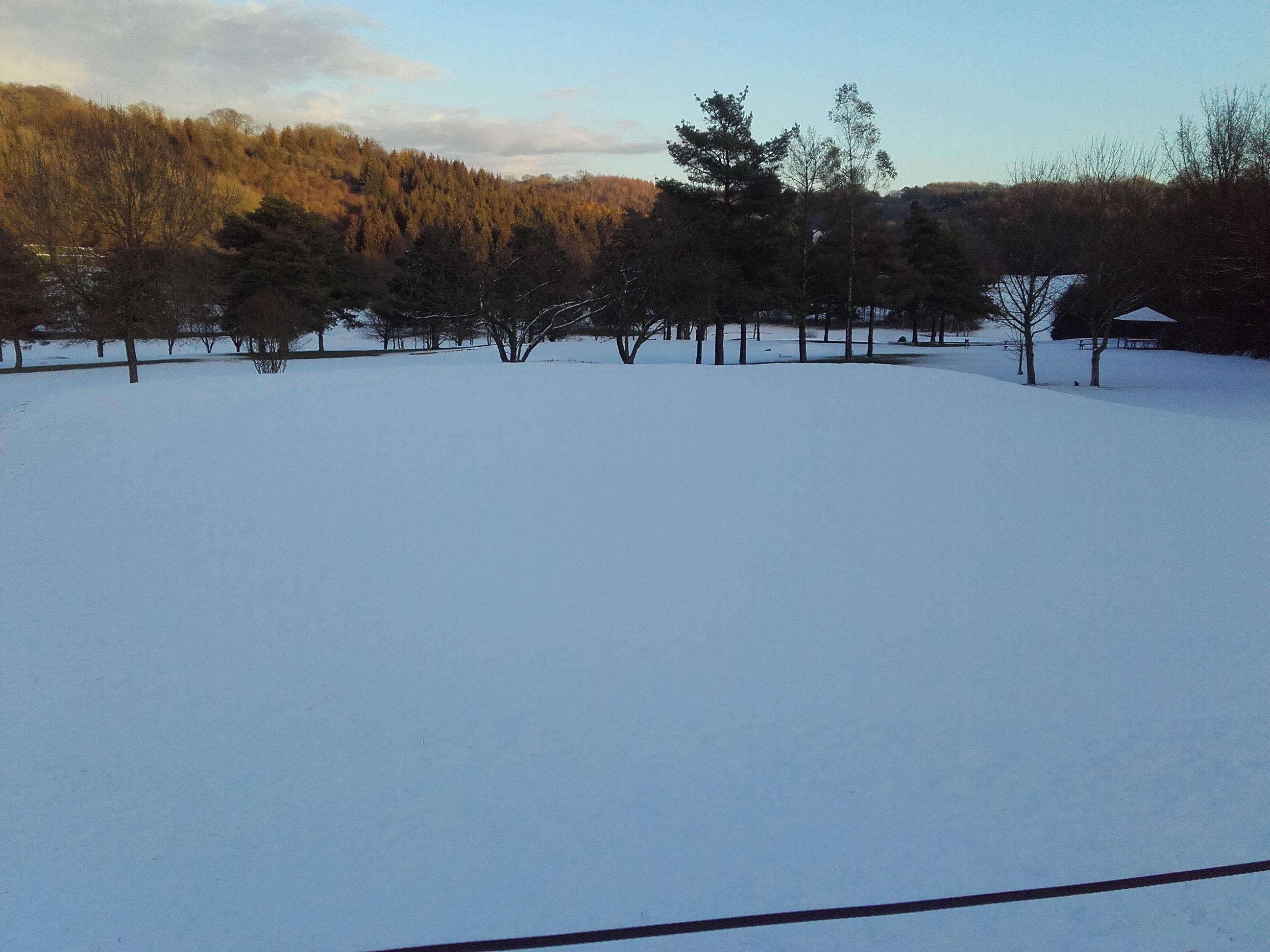

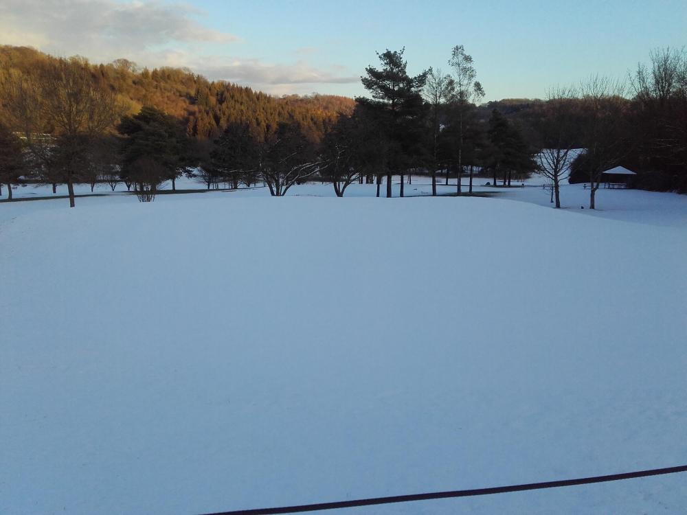

Onoff Posted January 30, 2019 Posted January 30, 2019 17 minutes ago, Ed Davies said: I'm a tad further north, of course, but not in the frost hollow or whatever is giving @ProDave his overnight lows. Frost hollow? Got that here. Sun doesn't get high enough for long enough to melt the snow. Like that micro climate in Z For Zacariah! You'd need orange balls to play the course next to me at the mo. I could do with a thermal camera I reckon to pinpoint all my loss points.
