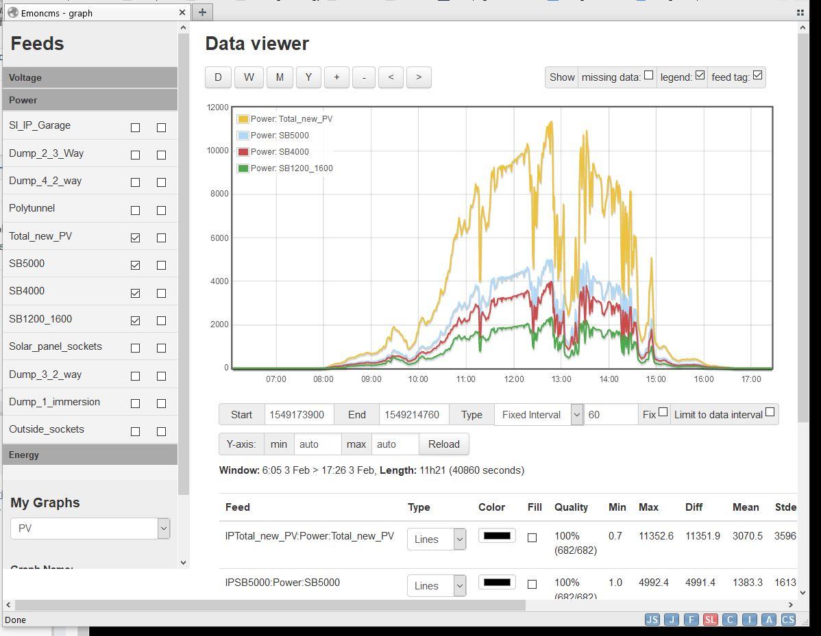

February 12, 20197 yr A bit OTT, but the Iotawatt (https://iotawatt.com/) sold in the UK by https://openenergymonitor.com/iotawatt-wifi-connected-14-channel-electricity-monitor/ is a very versatile multichannel monitoring device. It's ready built, uses clip on CTs and is fairly simple to set up. Stores data locally with its own web server but can export data to the Open Energy Monitor server (or a lcoal version), PVOutput.org or InfluxDB. It's a bit expensive, but much more useful than the commonly available simple versions while still being fairly easy to install.

March 4, 20197 yr I'm sure one could knock something bespoke up with a Raspberry Pi and a couple of sensors. Dump readings to a log file and display via a webpage.
