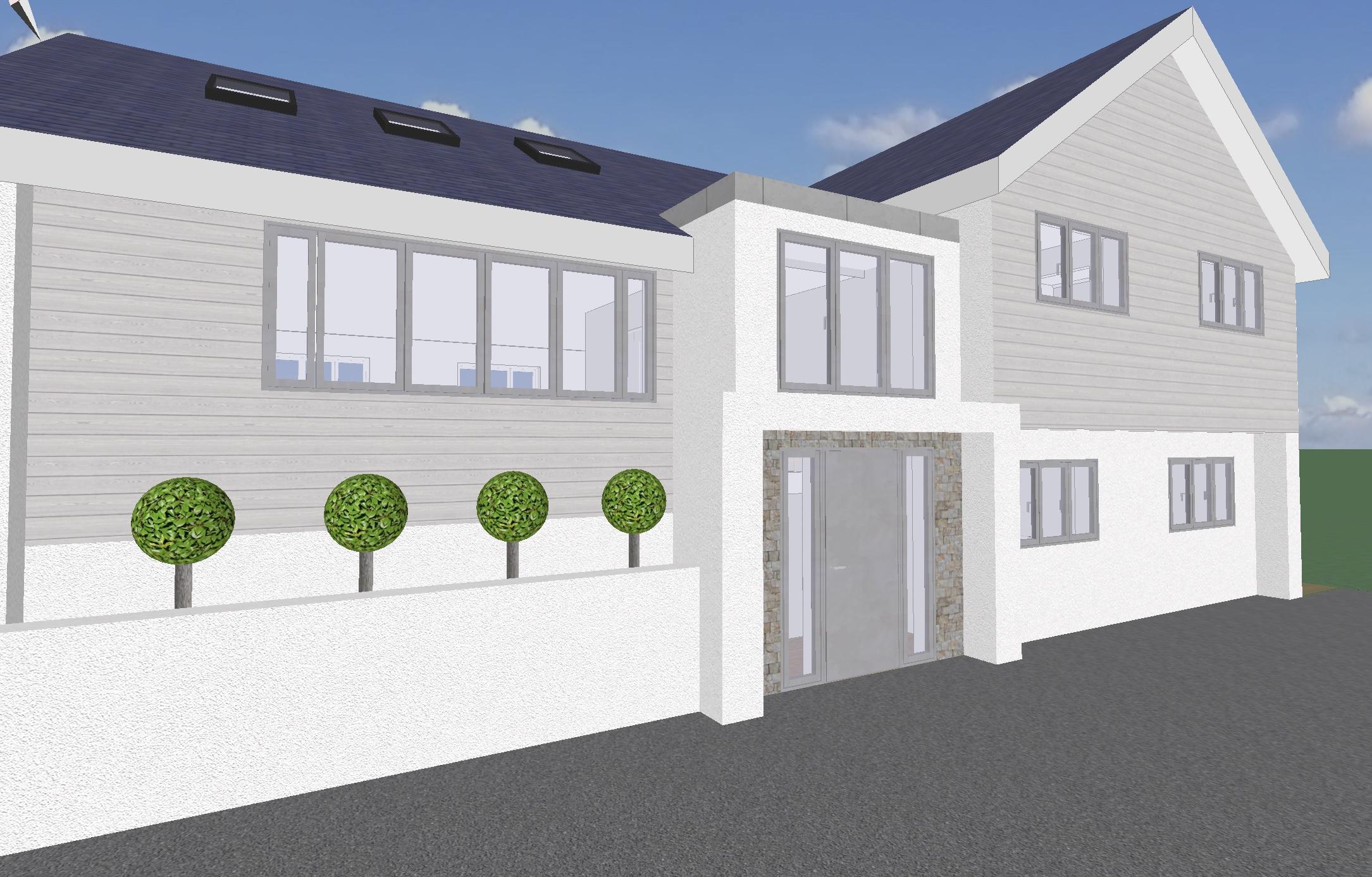

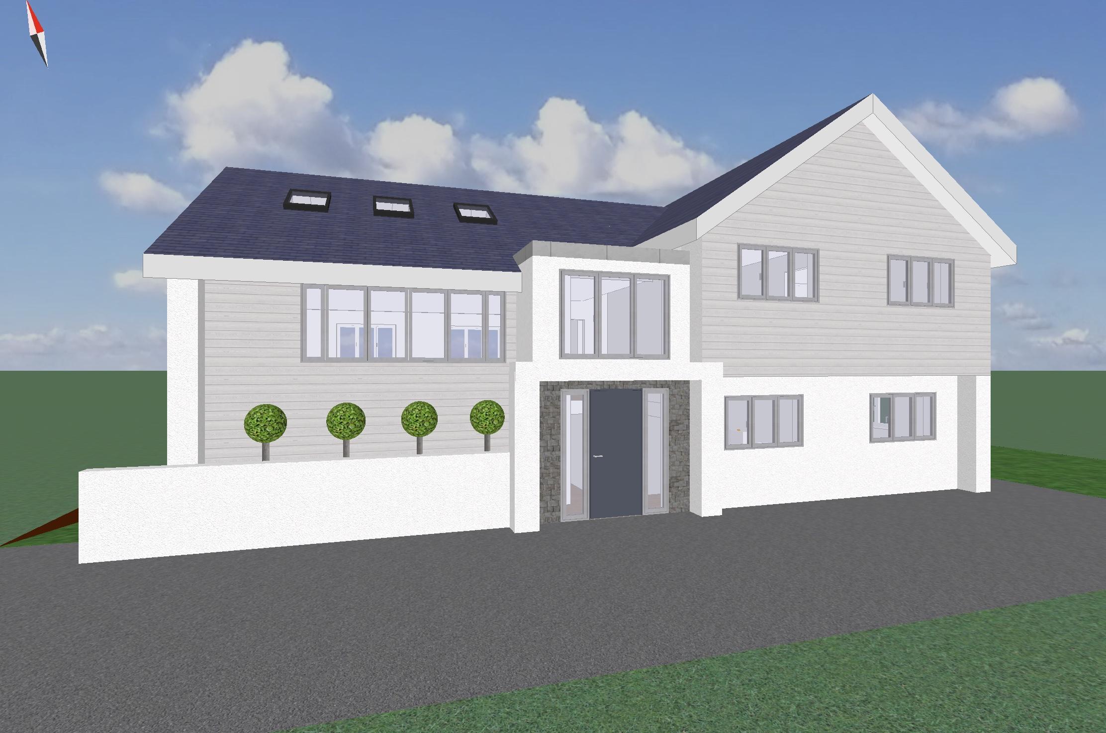

Lift span Posted March 7, 2019 Author Posted March 7, 2019 (edited) Ok. It’s been a few weeks! I think I have a plan for the inside but I just wanted to get some opinions on the outside. What do you think? Edited March 7, 2019 by Lift span

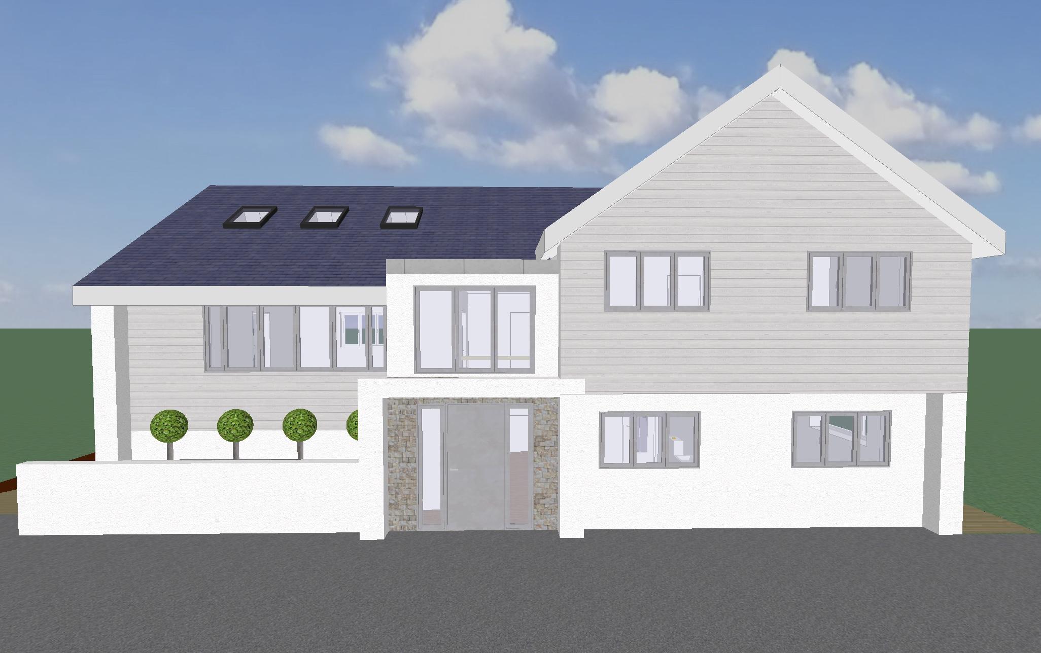

Lift span Posted March 7, 2019 Author Posted March 7, 2019 Or with a different detail around the door... 1
Nickfromwales Posted March 18, 2019 Posted March 18, 2019 Second one, just for symmetry, but also you gain a bit more protection against the elements.

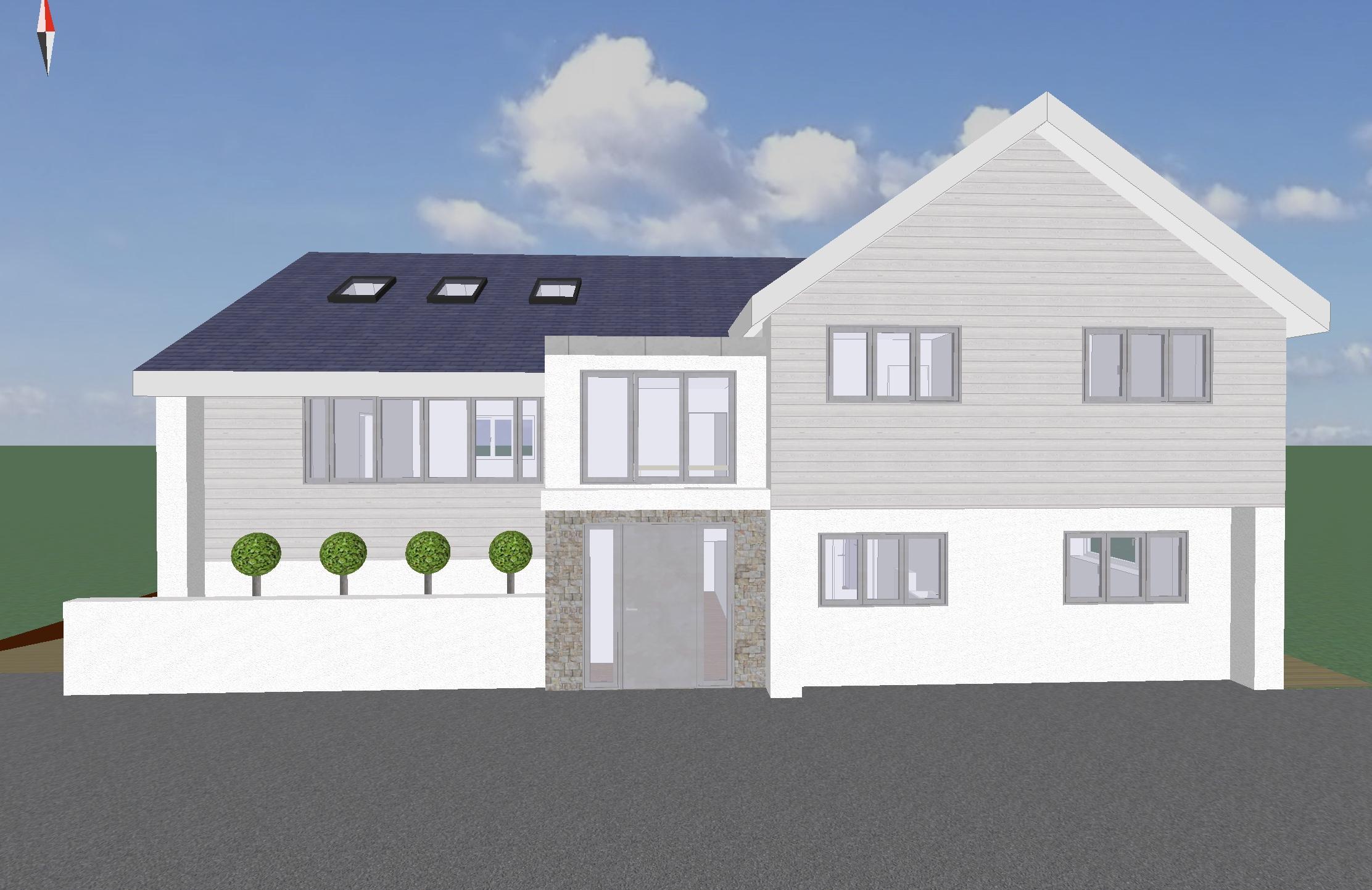

Ferdinand Posted March 18, 2019 Posted March 18, 2019 (edited) 1 hour ago, Lift span said: Anybody? Sorry - missed the update on March 7 ?. I agree with Nick. The second one is the better. The front door needs a strong frame. Details after the intermission: 1 - That facade feels at ease with itself, to me. a The roofline is progressive in profile - high, medium, low. b That incongruous mini gable has gone. c The consistent window subdivisions unify. d Skylights look good as a counterbalance point to the high RHS gable. That should be preservable even if you need to change them. 2 - The only uncomfortable elements to me are: a The 4 windows on the RHS being foursquare. Perhaps they are foursquare in 2d not 3d, and it is just parallax in the perspective. I would probably try and change that if not. b I am still in 2 minds about the different heights to the bottom edges of the cladding. You can argue that it reflects the graduated roofline, or that they should be the same. It might be good with cladding down to the near-ground on the LHS. One to think about. 3 - My further comments: a Whilst it looks balanced and comfortable, to me the visual feel us a little "flat" in this presentation, with pastel shades of cladding and a front door that does not stand out. b That is difficult to comment on in detail with the drawings we have, but I would suggest that the front door definitely needs to stand out more - that could be done by a strong colour front door say black or match the slates or dark red or blue or Wimbledon Green. It needs to be the place the eye stops when you look at the house from the front. I might be good to deliberately use a strongly contrasting material for the door surround inside the porch, so the eye first takes in the balanced whole, and is attracted in to the porch by the frame, then that material as the "mount", then the front door as the picture and subliminally wants to come inside your nice house. I am thinking of eg glazed bricks (black or grey to reflect the rook, or London Transport oxblood could work), or anything else that stands out from the facade. Or you could use a stronger cladding colour. But imo the porch / door needs to say "look at ME", or something else to say "look at THAT door, THERE". c But how that works depends on your cladding pattern and material and colour, so I need to leave that with you and the decision does not need to be made yet. But try a few colour changes to cladding and door and see what it looks like. Looking forward to seeing your interior. Ferdinand Edited March 18, 2019 by Ferdinand

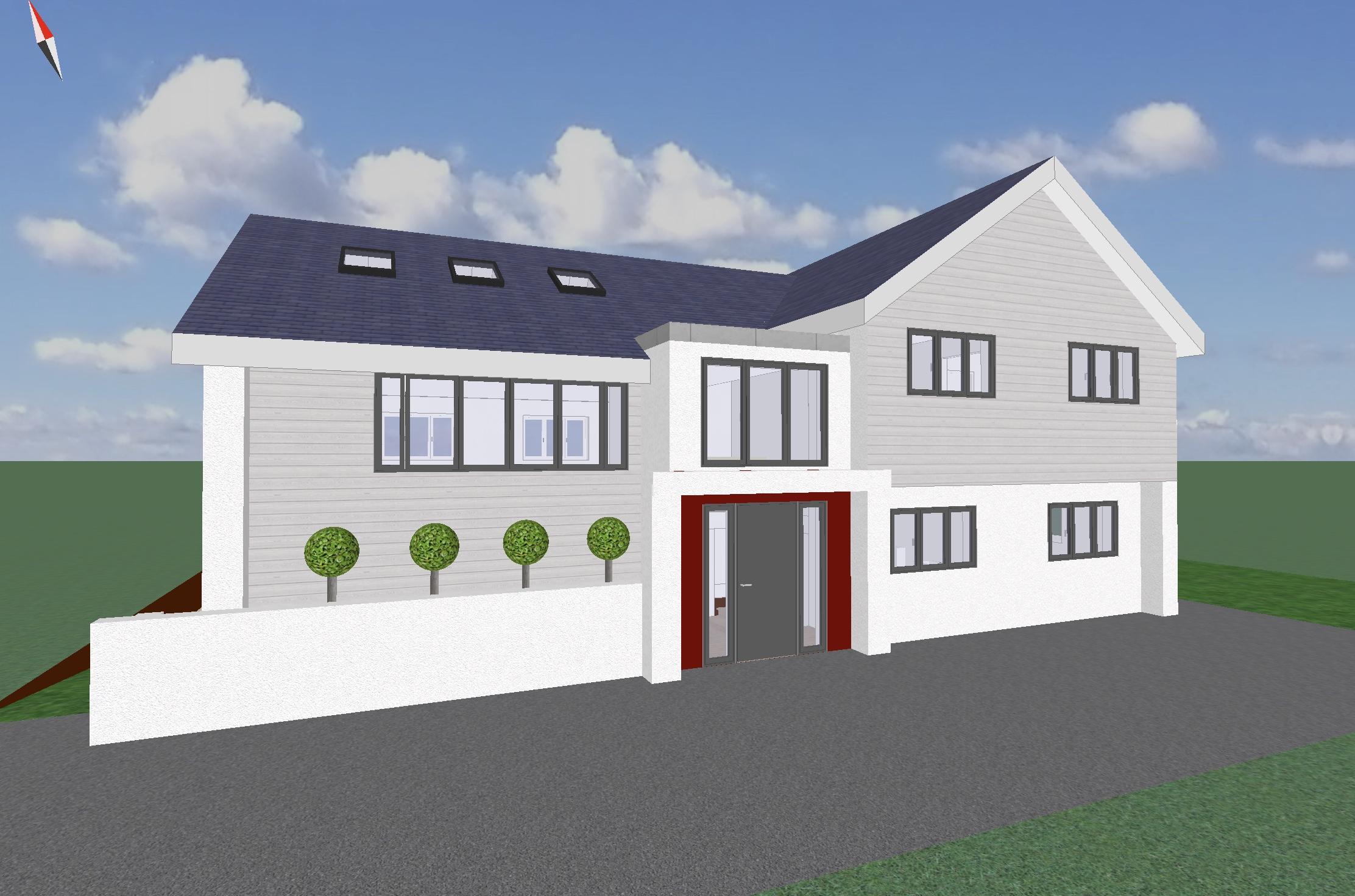

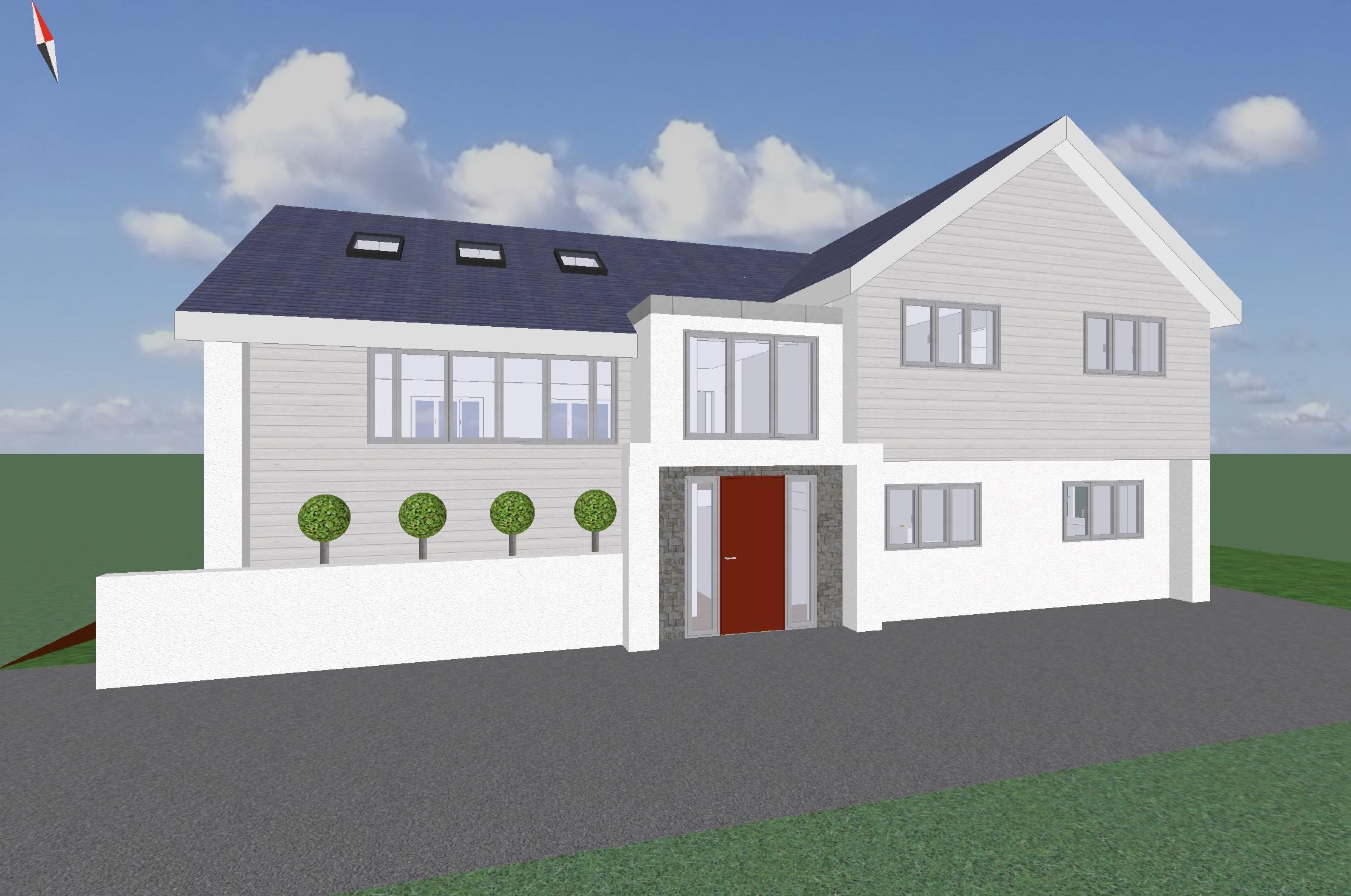

Lift span Posted March 18, 2019 Author Posted March 18, 2019 (edited) Great comments thanks! The windows are square, you’re right it’s just the view. I’ve brought the cladding down, darkened the stone around the door and done some door colour options ... Edited March 18, 2019 by Lift span

Ferdinand Posted March 18, 2019 Posted March 18, 2019 Of those I prefer the green. The effects of tiny changes are weird, but to me the green door makes the LH corner of the RH gable much sharper / better resolved where it meets the window above the porch, and the others do not. It may be that the surroundings being set out in a tone of green make that seem better, but to me that shows how the details really matter. Can you do one with adark grey window frames and door (incl. side panels), and the door surround inside the porch in black or oxblood or dark red. That would be interesting. But I admit this is just a self-indulgence. It wants a few comments from others no imo, and then the inside. Ferdinand
Lift span Posted March 19, 2019 Author Posted March 19, 2019 You a fan of dark red lipstick and lots of eyeliner ? 1
Ferdinand Posted March 19, 2019 Posted March 19, 2019 3 hours ago, Lift span said: You a fan of dark red lipstick and lots of eyeliner ? Not on houses ??

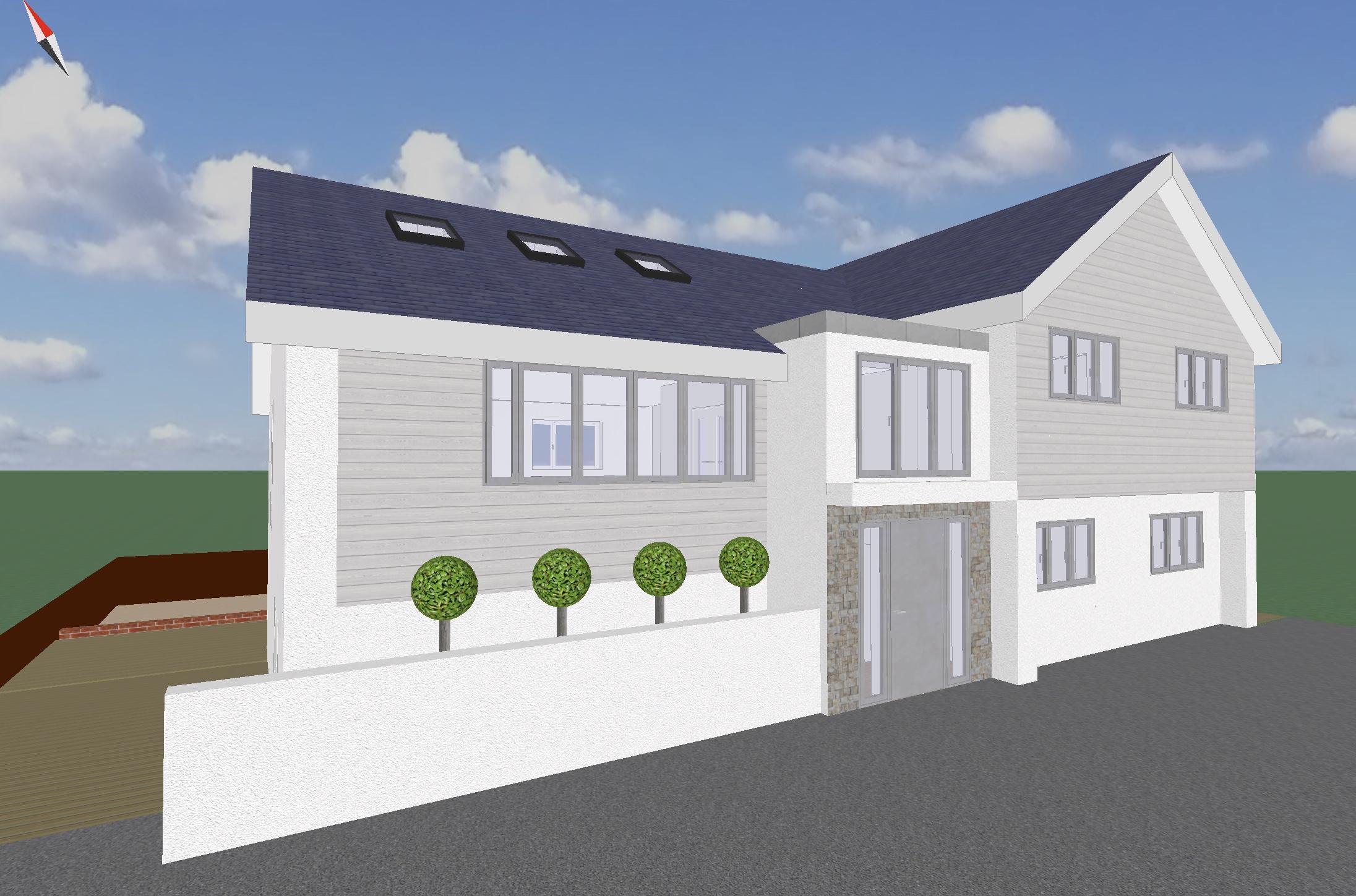

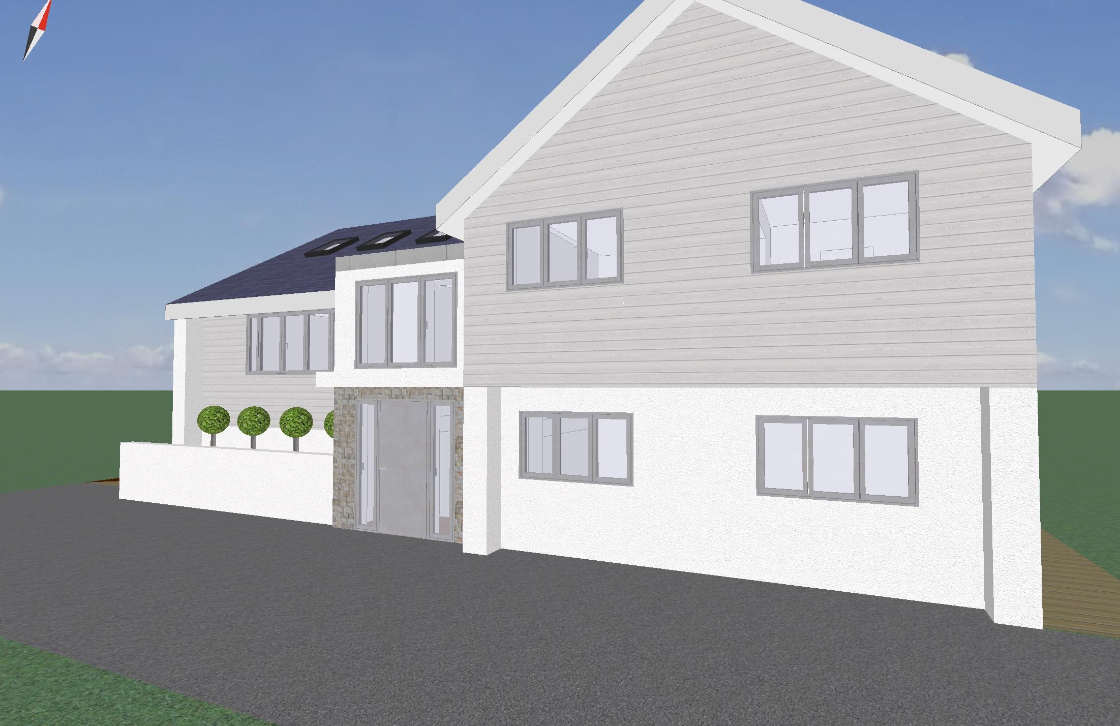

Lift span Posted July 1, 2019 Author Posted July 1, 2019 Just to update this. It took a while but I’ve got planning permission through and I’m in the process of getting the Building Regs approved. I’ve changed things a little bit. What do people think? I’ve gone off the Cedral cladding idea and am looking at stone/flint cladding only on the front extension instead. The windows and doors are in Iron grey (RAL 7011).
newhome Posted July 1, 2019 Posted July 1, 2019 I like that! Compared to what you have now it looks so much better.
Ferdinand Posted July 1, 2019 Posted July 1, 2019 (edited) I think it looks great. And in 5 months. I think that shows the value of taking *some* time, but not enough to go beyond the short term. On March 7th you nearly promised us a sight of the plans of the inside. Come'on - show and tell , F Edited July 1, 2019 by Ferdinand
jack Posted July 1, 2019 Posted July 1, 2019 Looks much better than prior iterations. I agree with @Ferdinand, it needs a spark of colour. We have a similar overall colour scheme, even down to the engineering bricks, but went with a very red front door (and garage door, but that's more or less out of sight from the road).
Ferdinand Posted July 1, 2019 Posted July 1, 2019 (edited) But - colour can come later, if it is not going to be a material. It could be the door. Or you could treat the porch as basic plus cladding. So for now have a Fog Cutter cocktail to celebrate getting through the Design Fog, and relax for a couple of days. F Edited July 1, 2019 by Ferdinand
