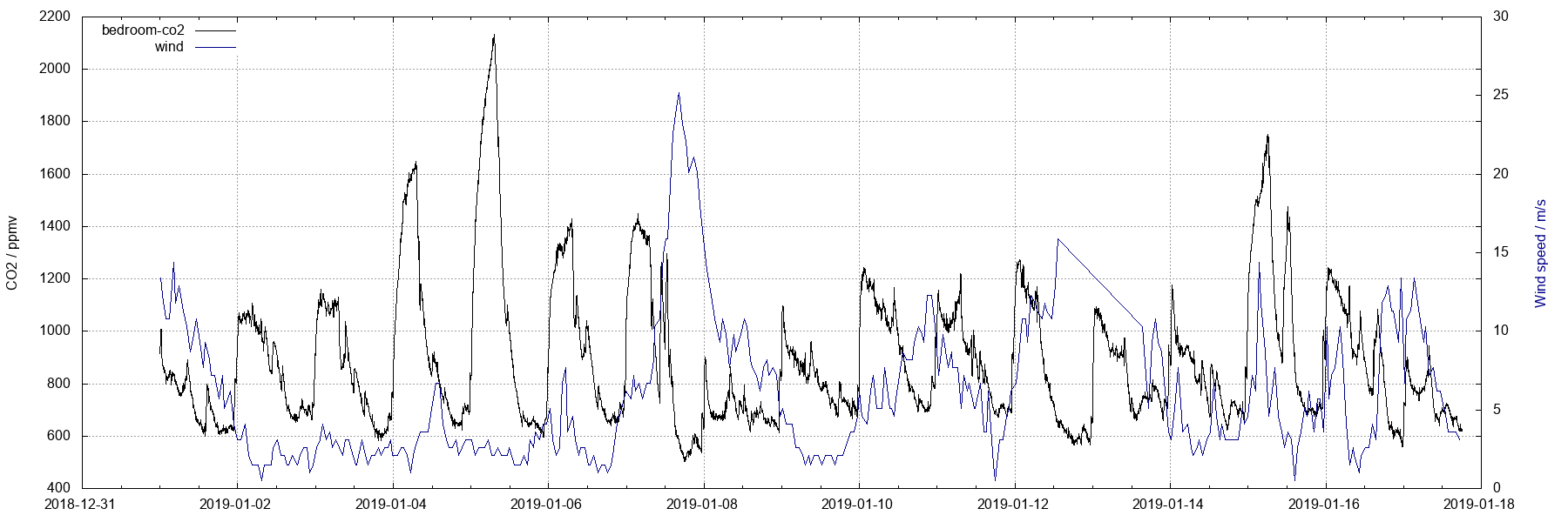

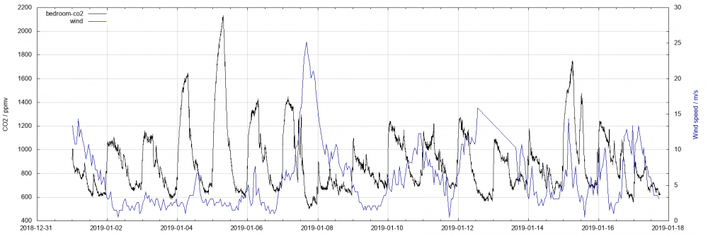

Ed Davies Posted January 22, 2019 Posted January 22, 2019 Interesting. I already watch Tom Scott's videos quite a lot but have now bookmarked Kurtis Baute's for later. Been meaning to look into CO₂ levels here overnight vs wind speed, to examine my assumption that more wind => more ventilation => lower CO₂ levels but a quick look at the data for so far this month doesn't seem to support that. Sure, the night with the highest CO₂ level wasn't very windy and the windiest night was low CO₂ but there are plenty of other nights which don't follow the pattern.

epsilonGreedy Posted January 22, 2019 Posted January 22, 2019 1 hour ago, Ed Davies said: Been meaning to look into CO₂ levels here overnight vs wind speed, to examine my assumption that more wind => more ventilation => lower CO₂ levels but a quick look at the data for so far this month Are your readings inside the house or for fresh air outside? I wonder if the numbers improve in the spring when things start turning green?
Jeremy Harris Posted January 22, 2019 Posted January 22, 2019 CO2 concentration outdoors doesn't seem to vary very much at all, from the measurements I've done, it seems to sit pretty close to around 400ppm. The variation indoors is pretty much all from people/pets breathing and the burning of any fossil fuel. I've measured levels of up to around 1600 to 1800ppm in our bedroom at the old house in the middle of the night. Here, the house monitoring system rarely records a concentration above about 600ppm.
Ed Davies Posted January 22, 2019 Posted January 22, 2019 54 minutes ago, epsilonGreedy said: Are your readings inside the house or for fresh air outside? Monitor in my bedroom.
