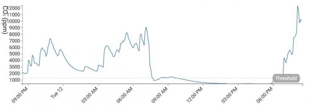

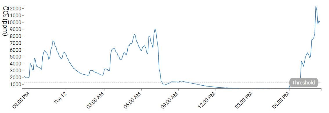

I hope my bedroom foobot is just badly calibrated!
