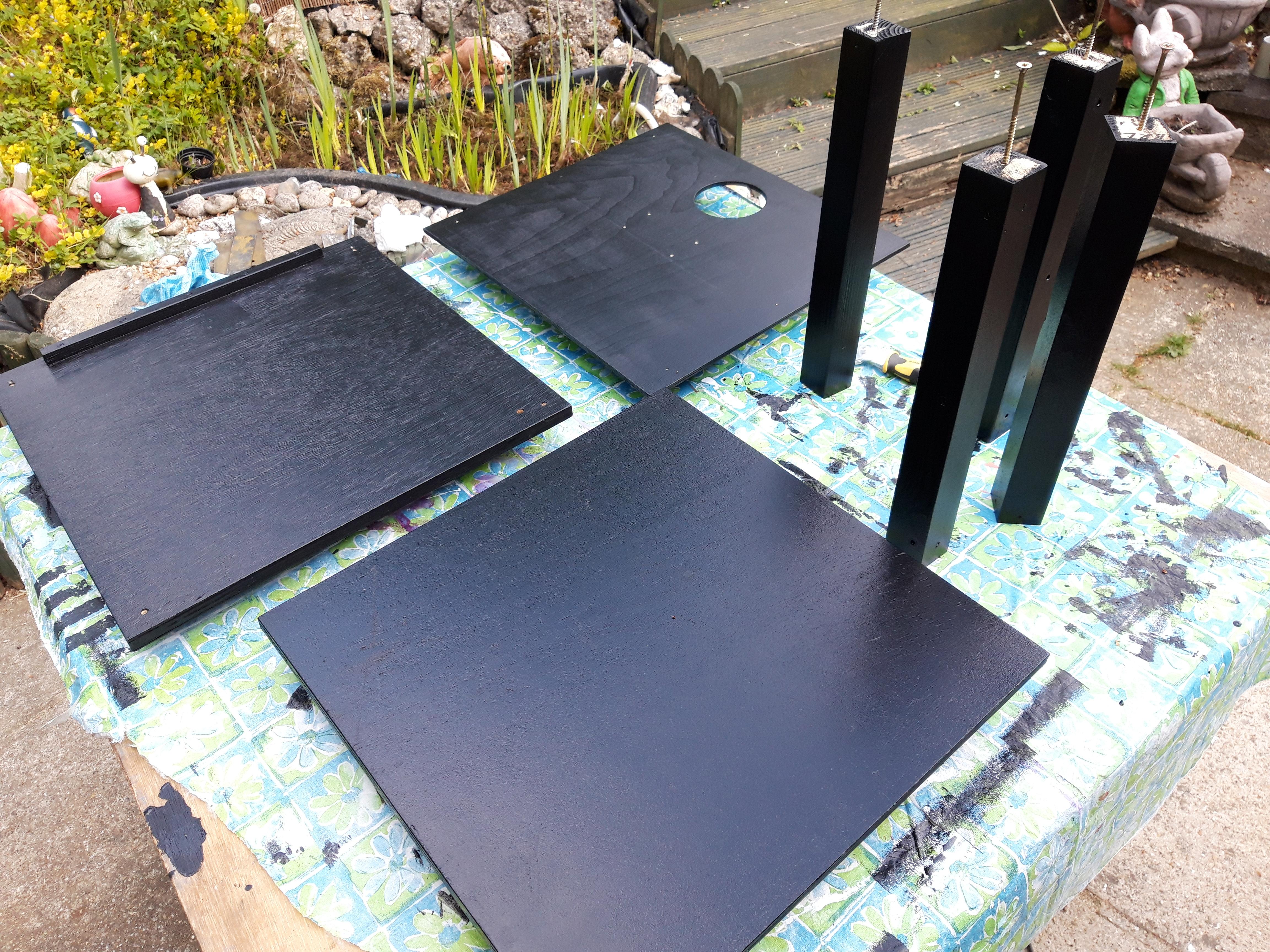

Going for 3 coats of rollered, Bedec, satin black barn paint on the printer enclosure. Hugely expensive at about £50/5l. Got for our front gate originally.
Drilled for an extract fan (if needed) and the rear power socket:
Re-assembly tomorrow hopefully!

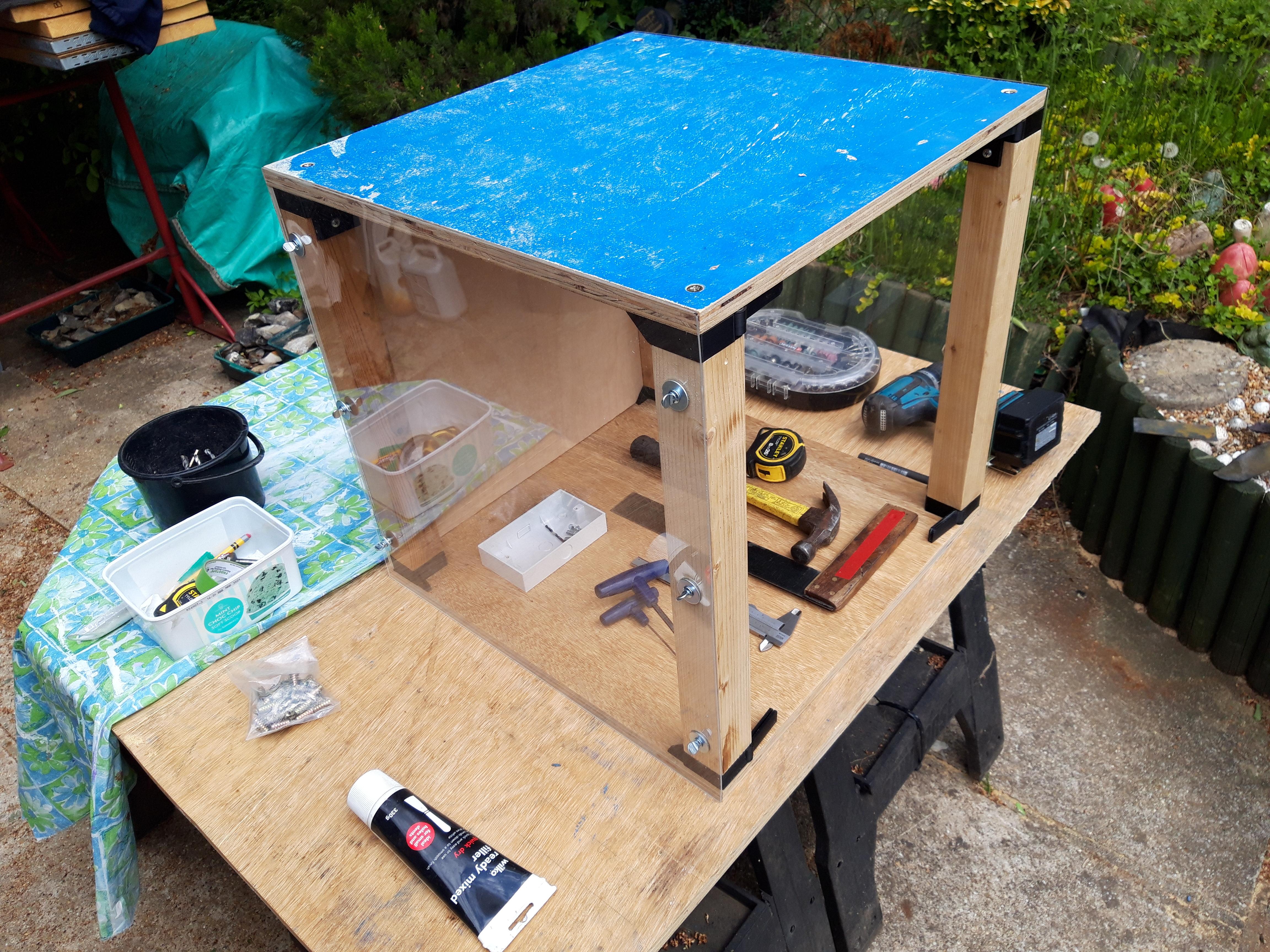

Little by little it's getting there. Blingy lights awaited. Power socket and extract fan to be fitted though the holes are all there. More trim round the front doors etc. Not too shabby for what was scrap timber and free plastic:
20200517_173940
20200517_173913
20200517_173844

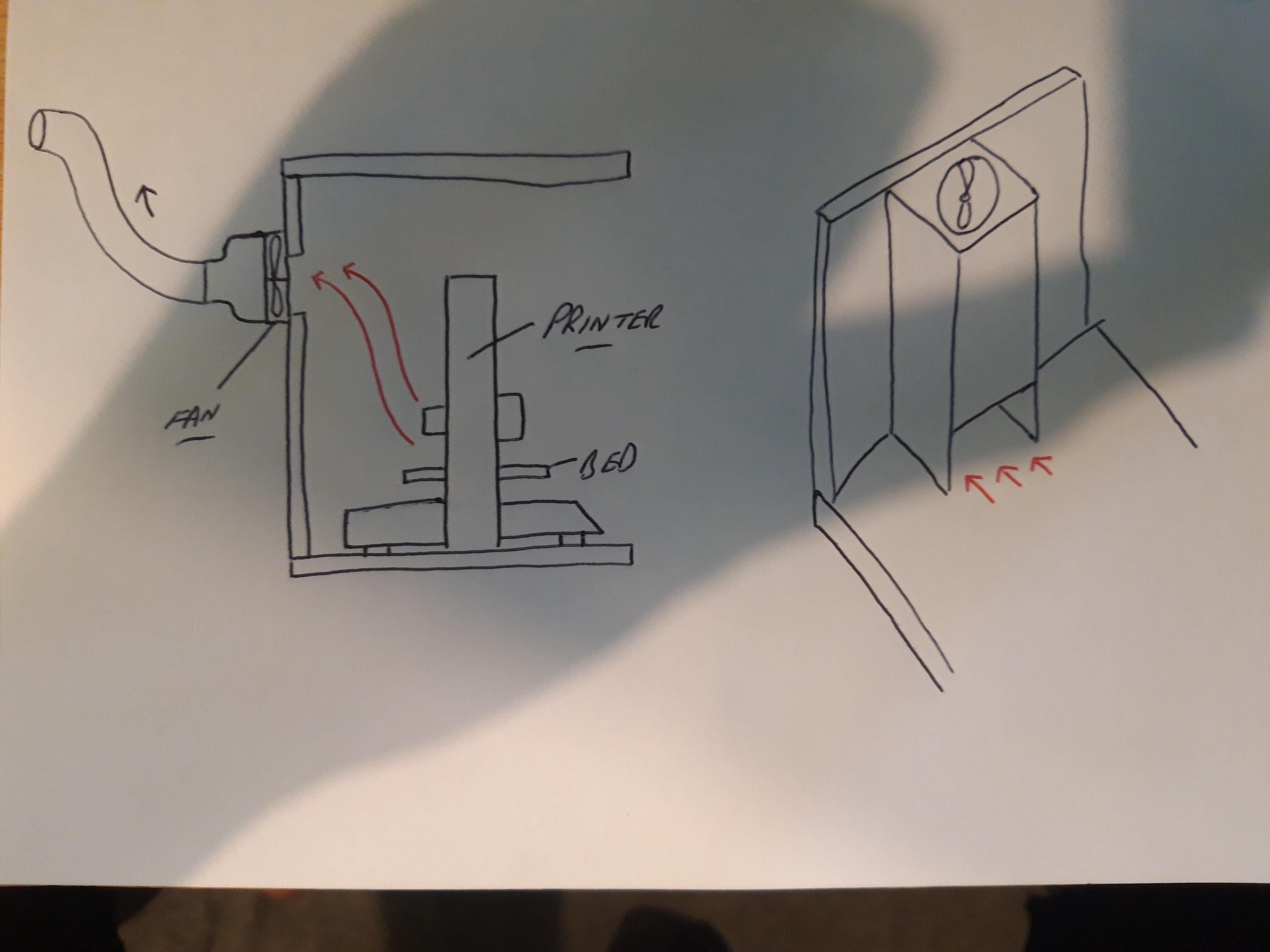

I'm wondering if the extract fan position is wrong and too high up, as in taking heat away from the print area?
On the test cubes above X is the face you see as you open the door. It's pretty good imo. Y is the real screw up face. It looks like the layers have been affected by "drag" whilst being put down. I'm betting that's the front to back air flow caused by the fan. Z should be "flatter" but it's not. The laying down of material is obviously helped by gravity but there appears to have been some slight "lifting". Again, betting caused by the fan.
One chap I've read has a similar 120mm fan to this but lower down in one of the corners, not sure if it's on the back or side of the enclosure..
We're limited with the enclosure sat on a desk as it is at the mo. Can't vent left or right or low down to the rear.
I might quickly knock up a ply "chimney" to go on the back wall of the case. The idea being that "damaging" heat from around the electronics and psu will be drawn in at the base through the "fireplace". Above the bed will stay nice and warm. Excuse the dog rough sketch this morning!
Hopefully it'll drag in any smell too.
Mind you, no discernible smell last night whatsoever, fan on & using Steadytech ABS Pro.
