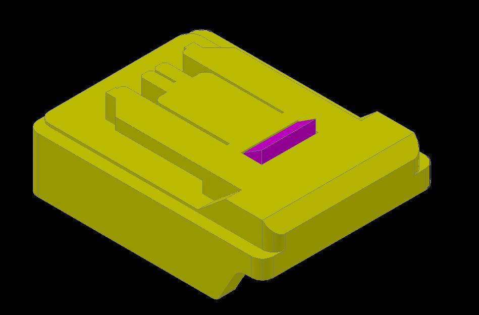

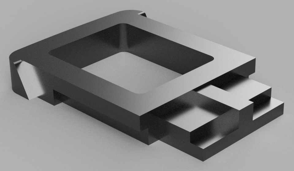

That's the Mak2Fer adapter done and ready to test print!
I've really dumbed this down to 2 parts. There's no spring operated release button to take the adapter off of the Ferrex tool as I'll never be buying Ferrex batteries as Makita is my chosen platform. The adapter will stay on the tool forever. It's a case of slide on the adapter and drop in the "wedge". I'll likely keep that in place with a drop of silicone so the adapter could be removed later if needs be. Or I might do the copper battery tabs to they hold the wedge in place.
Just got to wait for my printer to wake up!

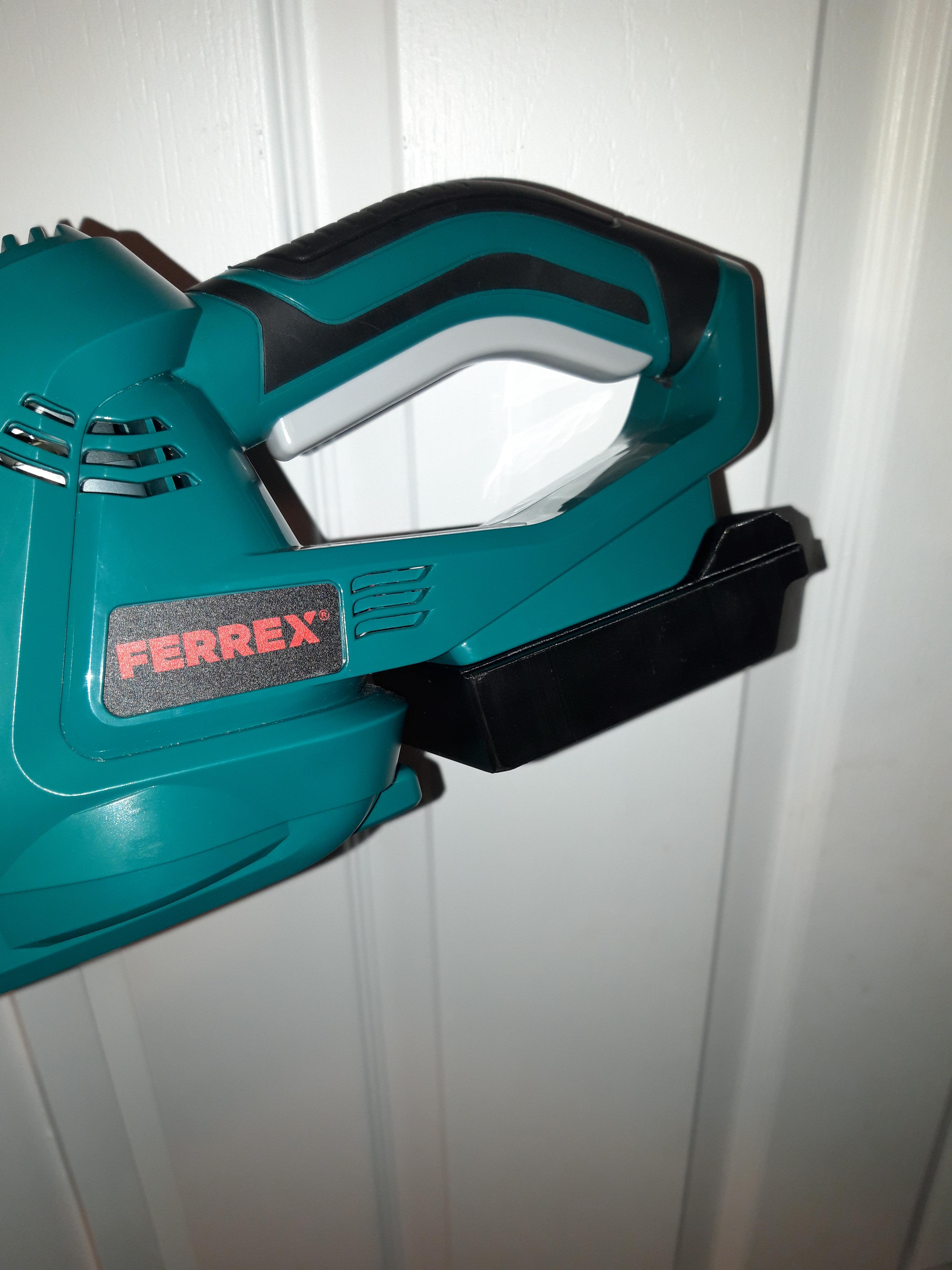

Mak2Fer adapter. Just waiting for some 1mm copper sheet to turn up so I can make battery connectors:
I forgot to emboss  MAK2FER on the sides!

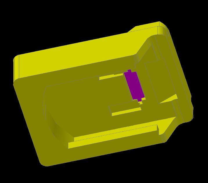

I DON'T BELIEVE IT!

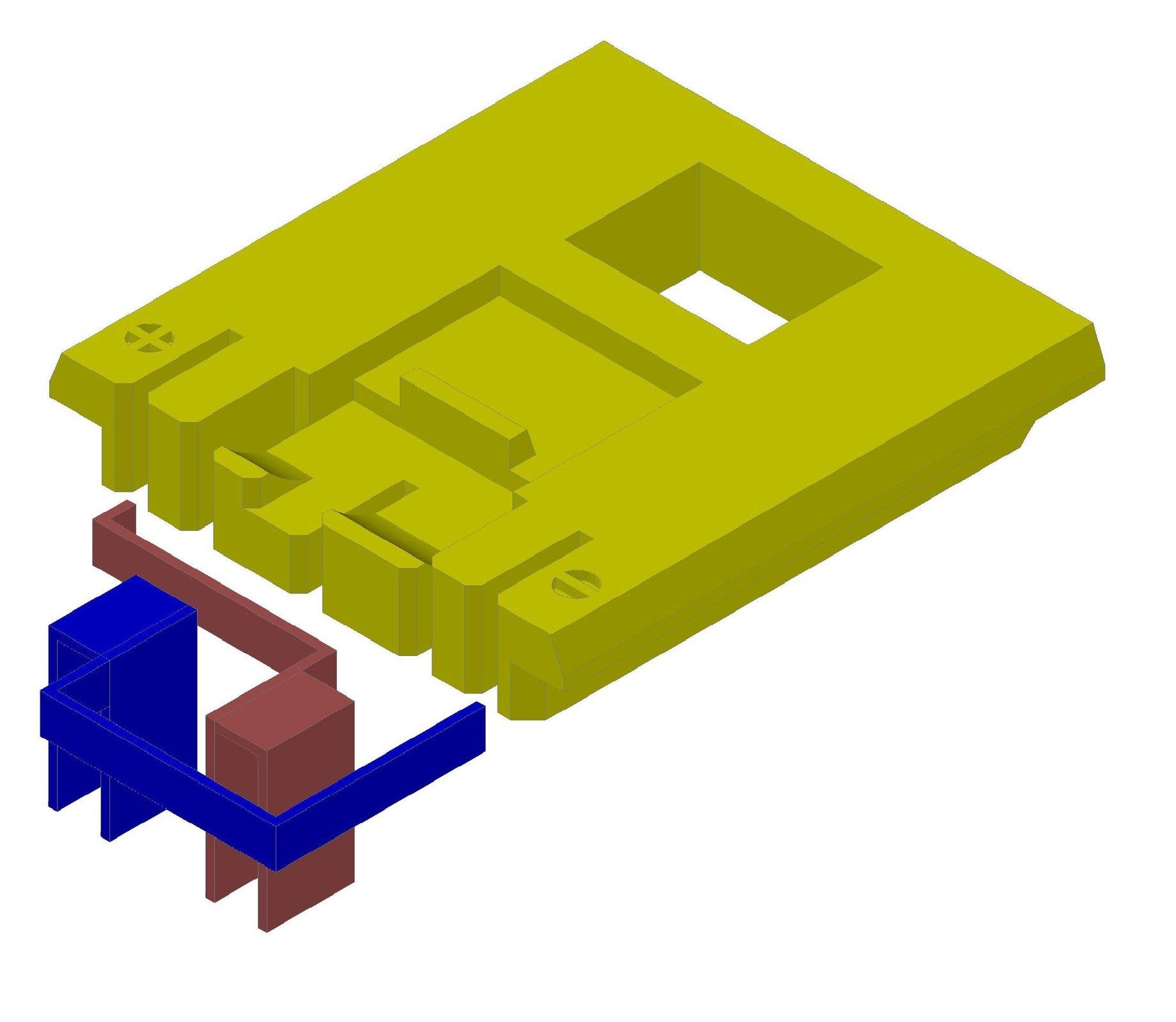

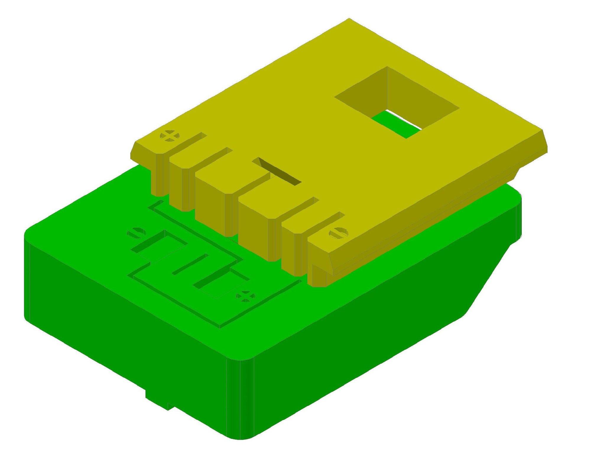

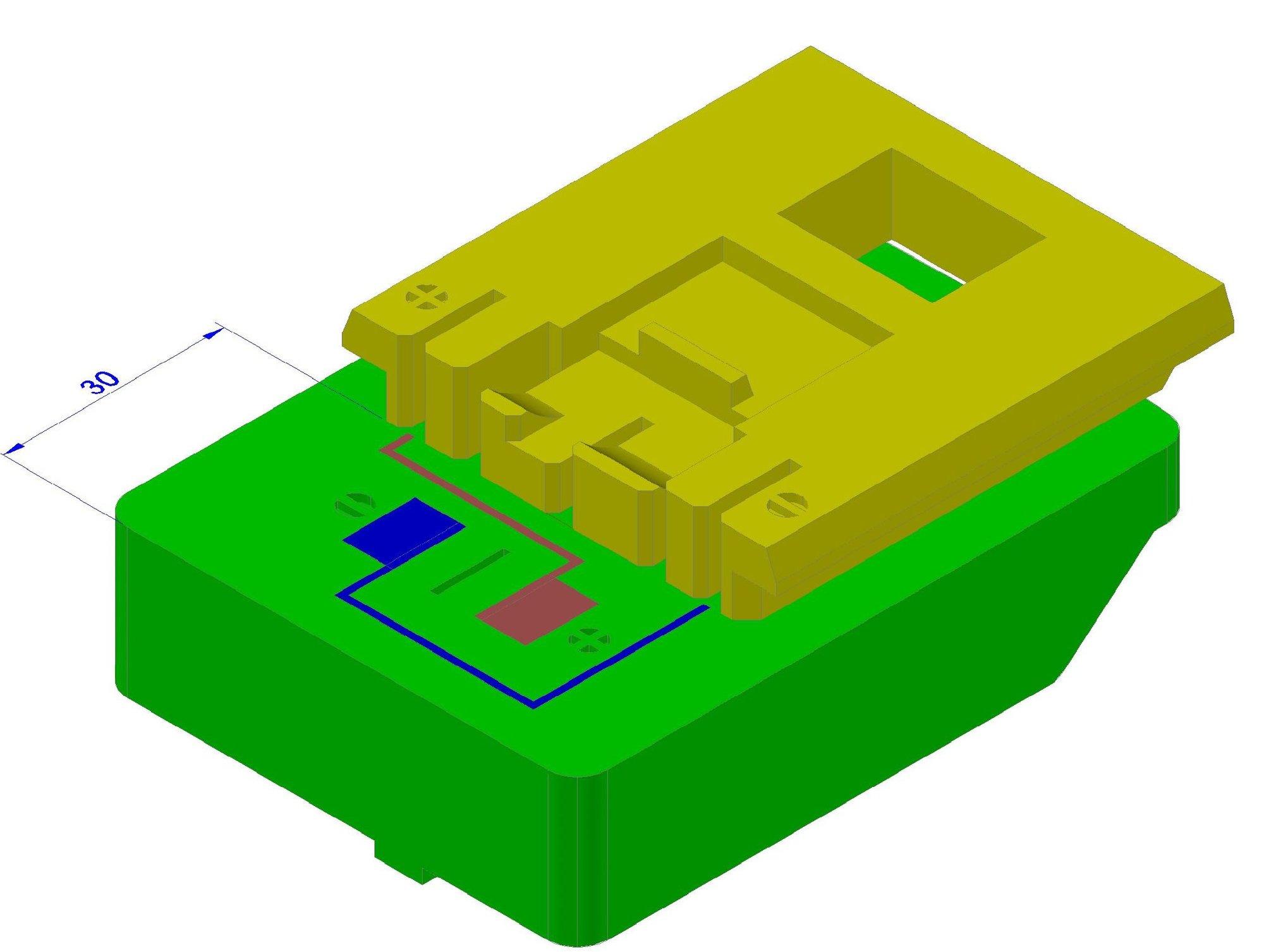

Somehow I've managed to design this "Mak2Fer" adapter above, so the + & - terminals are on opposite sides! Spin the Makita battery through 180deg on the model and it works but then you couldn't slide the battery in without making the adapter a lot longer and having it stick out the back.
Back to the drawing board for some crossover action!
As I'm never going to buy a Ferrex battery and charger it would probably be quicker to rewire the tool itself.
But where's the fun in that?
It'll be something on these line's, a dog legged arrangement to swap the polarity. These renderings are of an early Ferrex to Bosch adapter I'm working on. I've now thought of something a bit more elegant and might use 10mm2 copper wire to save on copper strip.

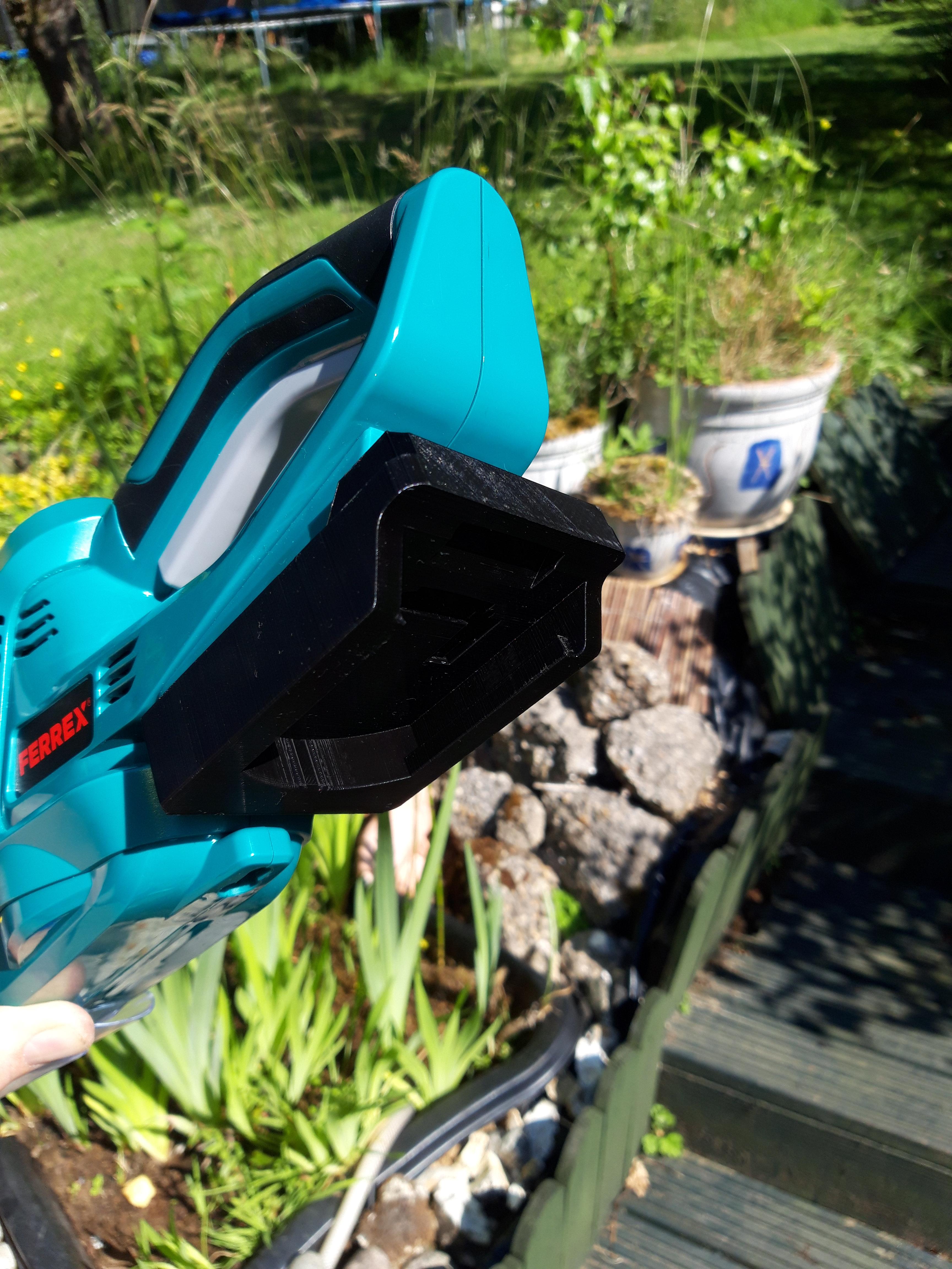

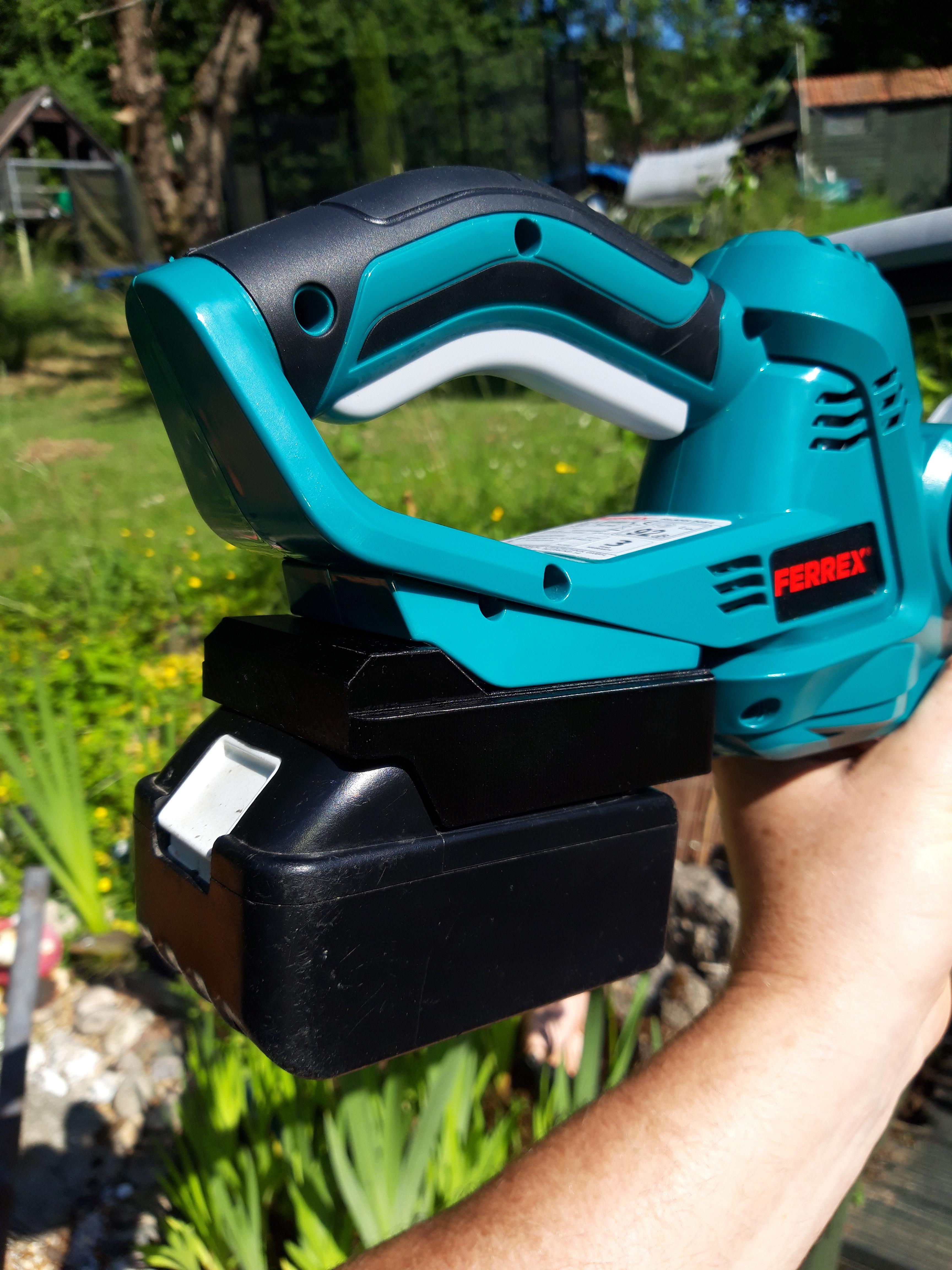

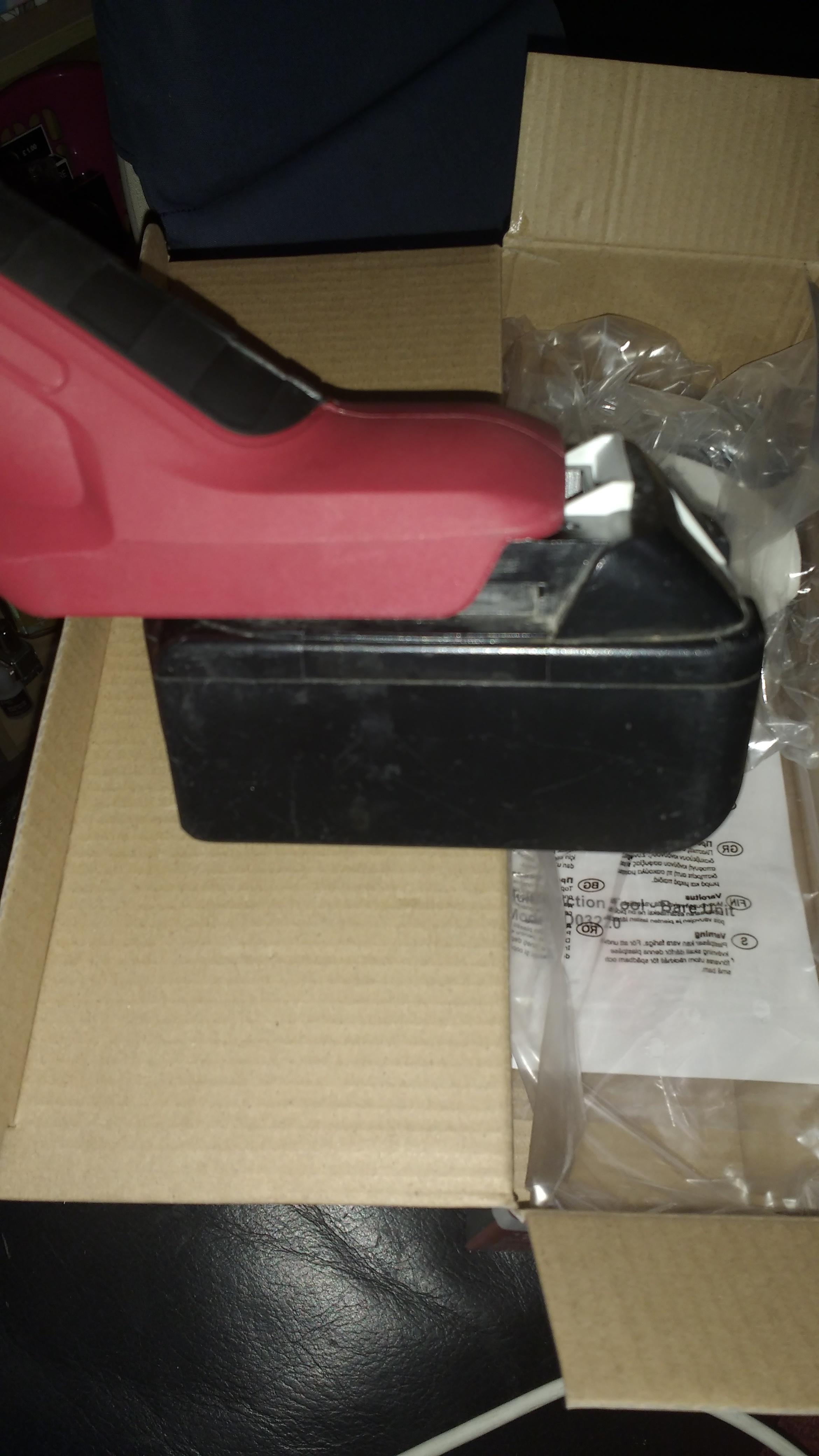

Well...
The revised/reprinted Makita to Ferrex adapter works...'ish.
First mistake was not tinning the copper blades prior to inserting them into the plastic. I put too much heat on one of the blades and it "sunk" into the print. Tbh that's just aesthetics.
[IMG]
[IMG]
In use...the hedge trimmer works fine...for about 2 seconds then stops. Release & pull the front handle again and you get another 2 seconds. Makita (clone) battery is fine and charged. I tried 2 3Ah batteries, then 2 5Ah, same issue. It's actually useable as in you cut on one pass, stop, then go again. I wonder why.....some intelligence in the tool or battery?
The hedge trimmer manual say to only use Ferrex 20V 2Ah or Ferrex 20/40V 2.5Ah batteries.

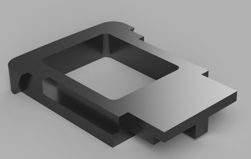

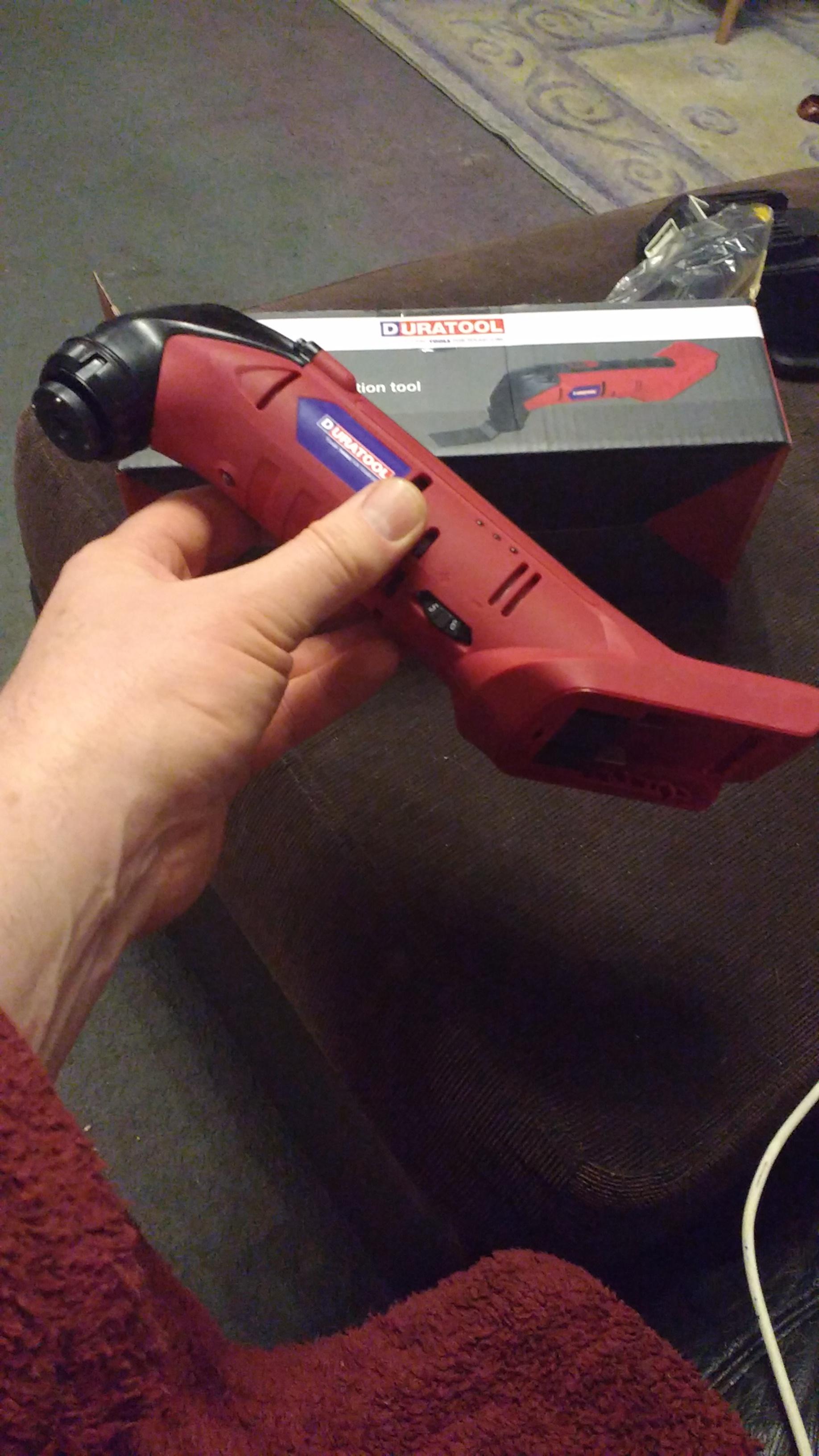

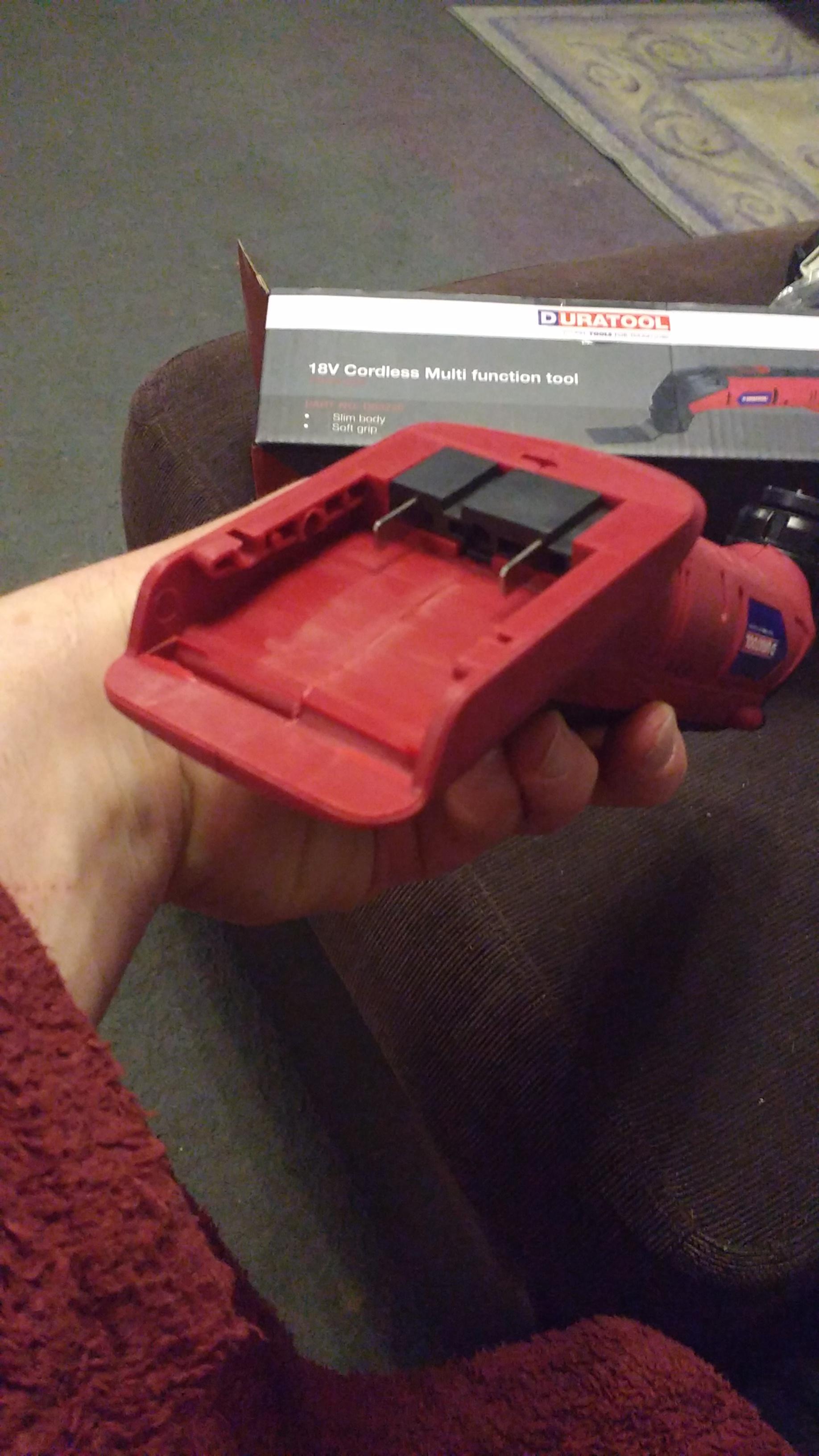

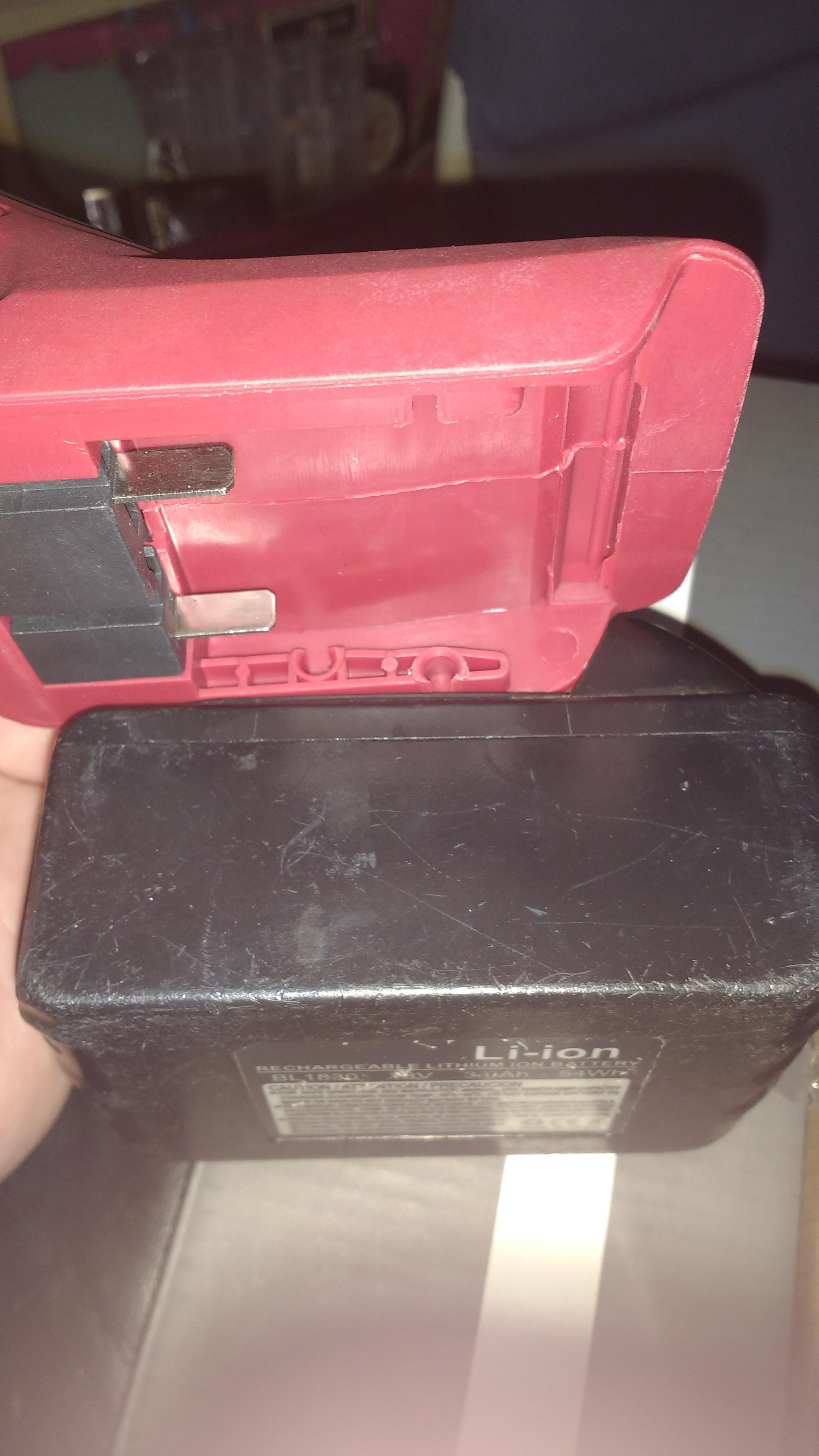

Duratool multitool, ripe for conversion to Makita power. The Makita battery actually slides part way in. If there was a bit more meat in the tool base I could have maybe modded that. As it stands I'll have to figure an adapter. Fire up the Vernier George!
Link to comment
Share on other sites

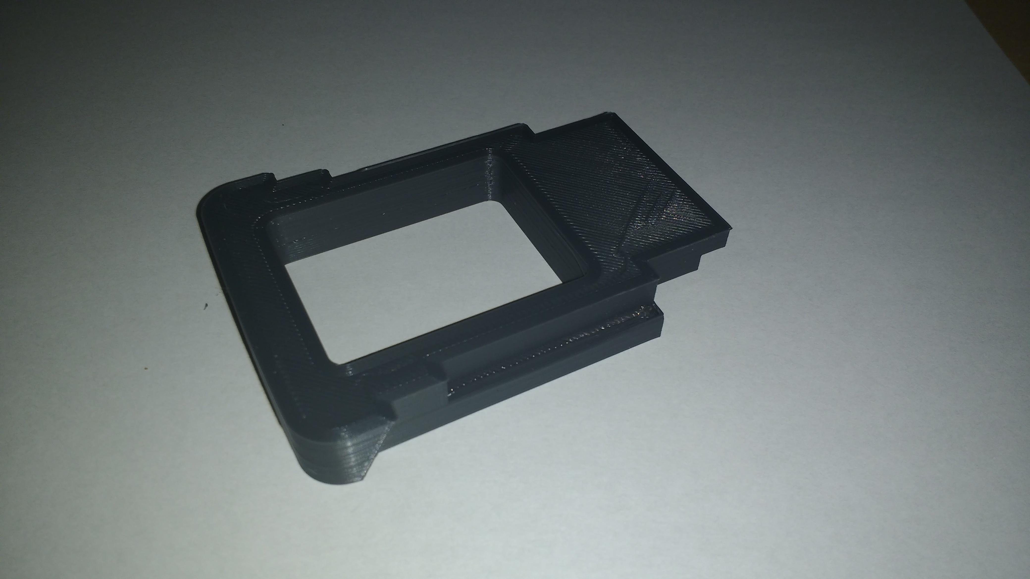

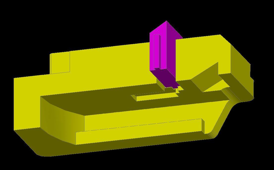

Just printing the test piece to insert in the Duratool base. Hollowed out to save on material / time. Designed in AutoCAD by me. Sliced in Cura by the lad. The .stl opened in Fusion by the lad to generate these pretty renders. I'll round the edges off and graft it to the Makita bit later on:
Link to comment
Grafted the infill piece to the Makita battery adapter design I've already done. A couple of pretty renderings:
Now printing in clay red PLA.

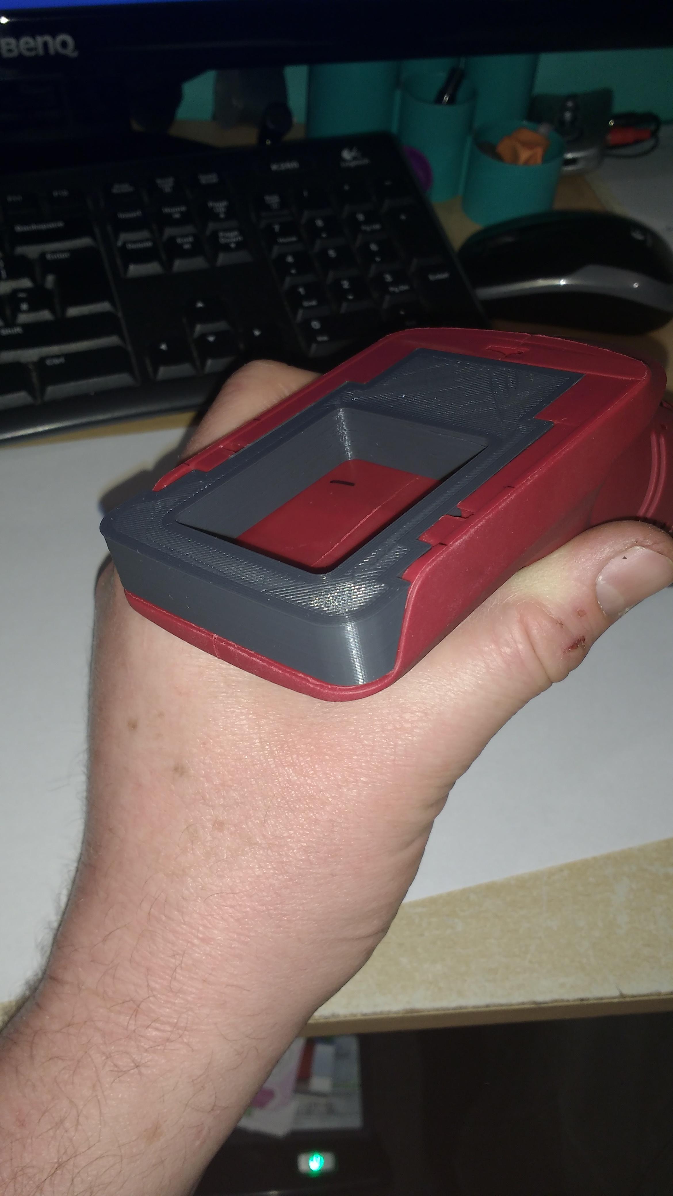

Finished, it'll do. Only 10% infill which is down to my boy not me. Seems very lightweight. Took about 6 hours.
These "ragged" areas were supported. The quality is to my mind a bit carp. Tbh you don't see these when the adapter is fitted but it still bugs me! Be interested to see prints of other people's "supported" faces.
I'll make the copper strip inserts tomorrow hopefully.
Link to comment
Yes supported faces can be poor. Cura has some options that do different support patterns but I found the default grid is normally the best. Perhaps worth experimenting with nozzle temperatures and fan speeds on some test pieces.
Quite often I cut objects into several parts in F360, rotate to avoid needing supports and glue back together.
I've recently  been printing more PETG filament and while it has its own issues (like more stringing) its great for large parts because it doesnt warp up off the bed like PLA can.
