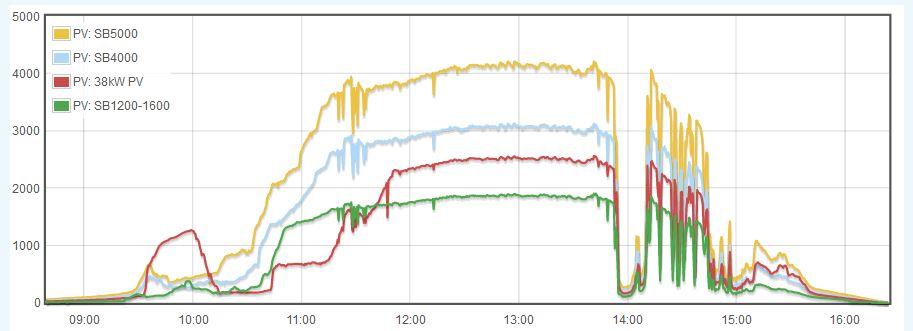

jack Posted January 17, 2019 Posted January 17, 2019 1 hour ago, MikeGrahamT21 said: Yesterday afternoon we had full sun in the back, around 2pm, I was speaking to the battery person and he said you must be generating about 1.5kw (which I thought at the time was a bit optimistic), when in fact we were generating 220w. Does this sound about right. December and January we peak at around 1kw of power at best, generally in the morning. Your battery guy's numbers sound optimistic to say the least. I've got 8.5kW in a mixed system (some east-west, some just west of south, all with a relatively low pitch) and the highest hourly production I've had in January is 590Wh. 1

jack Posted January 18, 2019 Posted January 18, 2019 7 minutes ago, MikeGrahamT21 said: Is the cleaning worth it? An interesting thing about PV, especially if you're using a standard inverter rather than micro-inverters or similar, is that the worst-performing panel limits the power that can be generated by all the rest on the same string. That means that if even one panel is shaded or dirty, it drags down the amount the rest of the panels can generate, often by a surprising amount. Even shading a couple of cells on a panel can be enough to make a difference: [Edited to add:] https://blog.aurorasolar.com/shading-losses-for-pv-systems-and-techniques-to-mitigate-them/. Cleaning may therefore be worth it, especially if you have any panels that have algae or dust on them (even if only in a corner or along the bottom).
