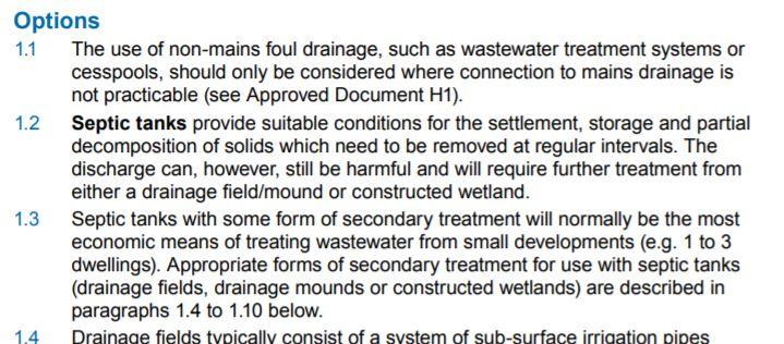

Ian Posted January 11, 2019 Posted January 11, 2019 (edited) 1 hour ago, Ed Davies said: 1) Septic tank: does anaerobic digestion. Produces output which needs to go to a reed bed, leach field or whatever for final treatment. Discouraged in this day and age; you can keep an existing one but likely can't put in a new one. New septic tanks are still allowed, at least they are in England & Wales Extract attached below is from the current Welsh building regs which are very similar to the English ones: Edited January 11, 2019 by Ian 1
jamieled Posted January 11, 2019 Posted January 11, 2019 In Scotland SEPA still allow you to register a new septic tank. 1
joe90 Posted January 11, 2019 Posted January 11, 2019 I stand corrected ?, but I would not install a septic tank in a new build.
Ian Posted January 11, 2019 Posted January 11, 2019 (edited) 5 minutes ago, joe90 said: I stand corrected ?, but I would not install a septic tank in a new build. Agreed...I had the choice on my build and decided to install a sewage treatment plant rather than a septic tank despite it costing extra. The ground worker thought I was mad.. Edited January 11, 2019 by Ian
ProDave Posted January 11, 2019 Posted January 11, 2019 18 minutes ago, jamieled said: In Scotland SEPA still allow you to register a new septic tank. Only if it has say an infiltration feild. They will not allow one discharging to a watercourse, and I believe from next year, existing ones discharging to a watercourse will need to be updated (several people around here are in for a shock)

Ed Davies Posted January 11, 2019 Posted January 11, 2019 1 hour ago, ProDave said: Only if it has say an infiltration feild. Ah, that's probably where I got the idea that septic tanks aren't allowed - it was in discussions of sites that don't percolate (like mine).
