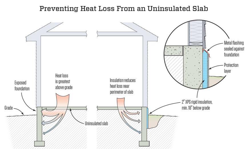

Ferdinand Posted January 5, 2019 Share Posted January 5, 2019 4 hours ago, zoothorn said: @Ferdinand can you explain perimeter insulation.. are you talking walls, externally? Im not entertaining this idea if so, as it'll detract from the contoured original exterior. The orig 'shell' 4 walls are are undoubtadly cold slate lumps sure.. but will have to be, & everything but the kitchen sink addressed/ attacked but them: that's the basic action plan for the house. i can not find a clear reference on BH, but this thread on GBF includes some clear explanation. http://www.greenbuildingforum.co.uk/newforum/comments.php?DiscussionID=10829 F Link to comment Share on other sites More sharing options...

zoothorn Posted January 6, 2019 Author Share Posted January 6, 2019 All very interesting, much appreciate the info (if a little complicated number-wise, for me that is). I'm basically on board with the perimeter idea, although I'm really not sure at all with the old 4-thick-walled 'shell' alarmingly in-out in places: the idea of digging down 1m around Id be very reticent about. Its not s'thing my builder mentioned either, briefly talking on the cold floor as we did/ him noticing scraps of blue dpc 'evidence'. Id really only be entertaining the original idea of digging the floor up, I think tbh, if of course the consensus IS that it is a genuinely decent idea. @Ferdinand my beams are exposed, & 6'8" between.. & 6'1" @ the lowest cross beams points! seriously, the lowest Ive ever known I think. Link to comment Share on other sites More sharing options...
Onoff Posted January 6, 2019 Share Posted January 6, 2019 8 minutes ago, zoothorn said: All very interesting, much appreciate the info (if a little complicated number-wise, for me that is). I'm basically on board with the perimeter idea, although I'm really not sure at all with the old 4-thick-walled 'shell' alarmingly in-out in places: the idea of digging down 1m around Id be very reticent about. Its not s'thing my builder mentioned either, briefly talking on the cold floor as we did/ him noticing scraps of blue dpc 'evidence'. Id really only be entertaining the original idea of digging the floor up, I think tbh, if of course the consensus IS that it is a genuinely decent idea. @Ferdinand my beams are exposed, & 6'8" between.. & 6'1" @ the lowest cross beams points! seriously, the lowest Ive ever known I think. There's a pub in Shoreham (Ye Olde George Inn) straight out of Lilliput the ceiling's that low! Link to comment Share on other sites More sharing options...

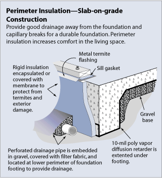

Onoff Posted January 6, 2019 Share Posted January 6, 2019 Something on these lines maybe? Improve the drainage around the house and insulate? Would mean paying a man with a digger. Deffo won't be as easy as in the pic as your foundation will likely be wider than the wall sitting on it. This picture of my place. You can see the blue duct passing under the strip footing which is wider than the wall. My house is similar to yours in that it looks like one big house but is really made up from add ons from when it was built in the 30s. Hence many different wall thicknesses and make ups. Hell, some walls are made from 3 or 4 different brick, block types all rendered over. I feel your pain. I've been considering EWI but rather than going straight down with the board would need to dog leg around the fittings. Link to comment Share on other sites More sharing options...
Ferdinand Posted January 6, 2019 Share Posted January 6, 2019 6 minutes ago, Onoff said: Deffo won't be as easy as in the pic as your foundation will likely be wider than the wall sitting on it. This picture of my place. You can see the blue duct passing under the strip footing which is wider than the wall. I think no foundations at all, or minimal, is more likely. Test hole required first. No foundations = do not dig out the foundations (ie the ground) next to the wall that is standing on it. In that case you do "wing" insulation rather than "skirt". Wing = horizontally along the ground, say under a path round the house. Or you return to Plan A and dig up the floor. F Link to comment Share on other sites More sharing options...
Ed Davies Posted January 6, 2019 Share Posted January 6, 2019 24 minutes ago, Ferdinand said: Wing = horizontally along the ground, Or sloping outwards. Angles of repose, and all that. Link to comment Share on other sites More sharing options...
zoothorn Posted January 6, 2019 Author Share Posted January 6, 2019 I'm not quite visualising these various suggestions &/ or can't put any external plan into action due to possible extension addition on the end of house (onto sheer blank wall @ fireplace end.. opposite to kitchen extention in the foreground).. which would need new foundations. Ive got planning for this ext, but up a gumtree re. costs & understanding the regs/ protocol so given up.. but may come back to do it when the right plan hits me. The reason I was thinking planA (dig up floor etc) was bc my builder made this as a suggestion.. & only this. Id assume maybe it being the simplest for him to do, builders being builders. He does know the house to a degree, & saw the floor hands on though. I think it might be the only conceivable thing I could actually do, without getting into a huge pickle attempting anything more complicated. Tbh I can't conceive of digging up externally, digger etc. Ive got water pipes & leccy cables buried, in-out relief to walls let alone unknown foundations & the ~possible~ extention adding onto 1 of the 3 'exposed' shell walls (4th tied up with the kitchen extension onto it). Link to comment Share on other sites More sharing options...
Ed Davies Posted January 6, 2019 Share Posted January 6, 2019 Though it was me that brought up perimeter insulation, I'd agree that replacing the floor with an insulated one would probably be preferable if it's feasible. Just had visions of you having to rip out your recently done kitchen. But it would leave a big thermal bridge down through the walls into the cold ground unless the underfloor insulation is well connected to any internal wall insulation you do. Link to comment Share on other sites More sharing options...

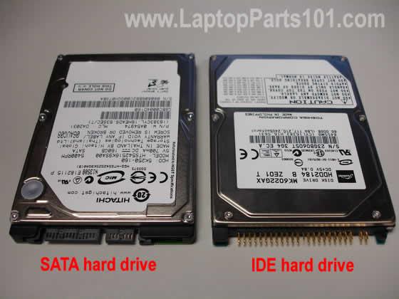

zoothorn Posted January 7, 2019 Author Share Posted January 7, 2019 On 05/01/2019 at 20:28, Onoff said: How did it die? Did you try the hdd in a USB caddy? @Onoff just picking up on this subject Onoff.. it was my stalwart old XP laptop, which just won't boot up/ wont get to the windows xp start. I had loads of pics of that pro build taken -just for- situations a few years down the line, like now- Id sure love to get them back. Took the HD out/ scrapped the rest. What you think- any chance of retrieval? Link to comment Share on other sites More sharing options...
Onoff Posted January 7, 2019 Share Posted January 7, 2019 (edited) 6 minutes ago, zoothorn said: @Onoff just picking up on this subject Onoff.. it was my stalwart old XP laptop, which just won't boot up/ wont get to the windows xp start. I had loads of pics of that pro build taken -just for- situations a few years down the line, like now- Id sure love to get them back. Took the HD out/ scrapped the rest. What you think- any chance of retrieval? ANY screen action at all? There may be a chance you can remove the hard disc (easy), slap it in a USB hard drive caddy then connect to your current laptop to get the files off. What make and model is the XP laptop? Edit: Just read you just kept the HDD. Is it IDE or SATA? Edited January 7, 2019 by Onoff Link to comment Share on other sites More sharing options...
zoothorn Posted January 7, 2019 Author Share Posted January 7, 2019 It was a dell d600 (yup that old!). I took the HD out. But surely if put this in a caddy it still won't work-? (ie I cant see how the caddy would 'revive it') Link to comment Share on other sites More sharing options...
