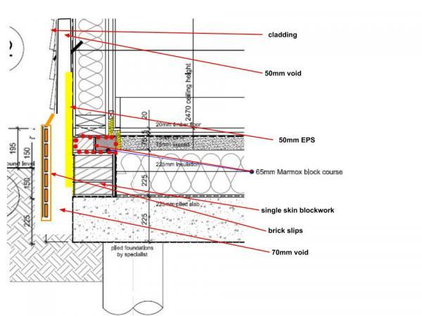

Blob the Builder Posted December 30, 2018 Posted December 30, 2018 (edited) Hi, I'm requiring advice/suggestions regarding protecting my timber soleplate from condensation/moisture between it and the DPC. I've read various threads how moisture can remain through lack of ventilation, and difference in temperature of timber and blockwork beneath, but not found a relevant solution yet, if necessary at all. Please see attached drawing for the build up. The wall is built and i'm starting timber cladding in the new year. So, before cladding commences i'm wondering if there is something i can do at this stage to insulate the blockwork wall externally, without bridging DPC ??? Foundation detail.pdf Edited December 30, 2018 by Blob the Builder

Jeremy Harris Posted December 30, 2018 Posted December 30, 2018 It's essential that some form of condensation risk assessment is done, something that is even more important now that insulation levels are significantly better than in times gone by. One consequence of improved insulation is that the sole plate will be colder, as less heat will be lost from the house. It was assumed at one time that including a vapour control layer on the warm side of the build up would eliminate the sole plate condensation risk, but this may well not be the case in the sort of variable weather we have. Water vapour can move into the structure from outside when humidity levels are high, and with luck will move back out again as humidity levels outside drop. The problem arises when the temperature of the sole plate drops below dew point for any water vapour that has migrated inwards. Because it takes, relatively, a lot of energy to turn liquid water back into vapour, and because the sole plate may well be being cooled by the ground beneath to the point where it doesn't get warm enough to drive the water out, there is a risk that it may end up wet for long enough to cause problems. The mitigation measures that can be used include improving the insulation level of the foundation that the frame rests on, by using some form of insulated blockwork, or adding an insulating upstand to try and keep the wall/floor junction a bit warmer. The key thing here is that the issue is a dynamic one, that isn't normally modelled in a standard steady state condensation risk analysis. There's a thread here about the specific issue this presents to a SIPs build, but much of the content in that is equally applicable to timber frame construction where there is no external insulation around the wall/floor junction.
Blob the Builder Posted December 30, 2018 Author Posted December 30, 2018 10 minutes ago, JSHarris said: It's essential that some form of condensation risk assessment is done, something that is even more important now that insulation levels are significantly better than in times gone by. One consequence of improved insulation is that the sole plate will be colder, as less heat will be lost from the house. It was assumed at one time that including a vapour control layer on the warm side of the build up would eliminate the sole plate condensation risk, but this may well not be the case in the sort of variable weather we have. Water vapour can move into the structure from outside when humidity levels are high, and with luck will move back out again as humidity levels outside drop. The problem arises when the temperature of the sole plate drops below dew point for any water vapour that has migrated inwards. Because it takes, relatively, a lot of energy to turn liquid water back into vapour, and because the sole plate may well be being cooled by the ground beneath to the point where it doesn't get warm enough to drive the water out, there is a risk that it may end up wet for long enough to cause problems. The mitigation measures that can be used include improving the insulation level of the foundation that the frame rests on, by using some form of insulated blockwork, or adding an insulating upstand to try and keep the wall/floor junction a bit warmer. The key thing here is that the issue is a dynamic one, that isn't normally modelled in a standard steady state condensation risk analysis. There's a thread here about the specific issue this presents to a SIPs build, but much of the content in that is equally applicable to timber frame construction where there is no external insulation around the wall/floor junction. Mmm, yes, what you explain here is what i was thinking, thanks. As my structure is already built i'm looking for possible solutions, so could one be to have some external insulation to the blockwork, i.e EPS, PIR, held on with battens, and render board on the battens? I'm not sure how this would fare when the finished ground level is made up around it? Is the thread you mention in the mayfly blog?
Jeremy Harris Posted December 30, 2018 Posted December 30, 2018 External insulaion, EPS or XPS, will do the job OK. The SIPs thread is on this forum somewhere, IIRC, or may possibly have been on the now defunct Ebuild forum. I seem to remember we had some input from a chap from Kingspan, who started off not realising there was a potential problem and ended up agreeing that there was a possible risk that could be mitigated with an insulation upstand.
Blob the Builder Posted December 30, 2018 Author Posted December 30, 2018 19 minutes ago, JSHarris said: External insulaion, EPS or XPS, will do the job OK. The SIPs thread is on this forum somewhere, IIRC, or may possibly have been on the now defunct Ebuild forum. I seem to remember we had some input from a chap from Kingspan, who started off not realising there was a potential problem and ended up agreeing that there was a possible risk that could be mitigated with an insulation upstand. Ok, thanks, i'll look into it....

Russell griffiths Posted December 31, 2018 Posted December 31, 2018 Did somebody not put a pic up recently of an external layer of xps that came from the footing up past the sole plate with a taper top on it and then the cladding coming down over that.
Blob the Builder Posted January 3, 2019 Author Posted January 3, 2019 On 31/12/2018 at 11:19, Russell griffiths said: Did somebody not put a pic up recently of an external layer of xps that came from the footing up past the sole plate with a taper top on it and then the cladding coming down over that. Hi Russell, i've found this detail on the forum, was it this you were thinking of? I'm not sure how the brick slips support the earth in this detail thou.

Russell griffiths Posted January 3, 2019 Posted January 3, 2019 That looks like the one I was thinking of @Blob the Builder some good details in that. I think it is certainly something I would do if building timberframe.
