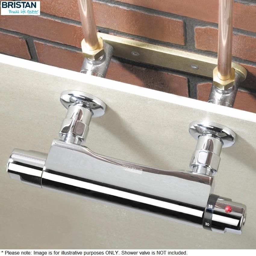

Onoff Posted December 26, 2018 Posted December 26, 2018 With the thermostatic bar type mixers beliefs it always the case that hot feeds the inlet nearest the little red button? Just wondering if ours has been plumbed in the wrong way round since day one. I changed the bar mixer like for like.
ProDave Posted December 26, 2018 Posted December 26, 2018 What's the full story? If your hot and cold are the wrong way round, then for it to work, your hose will have to come out of the top.
Adam E Posted December 26, 2018 Posted December 26, 2018 Hi on mixer showers the hot water goes on the left hand side, if you are looking at the shower from the front 1
Nickfromwales Posted December 26, 2018 Posted December 26, 2018 5 minutes ago, Adam E said: Hi on mixer showers the hot water goes on the left hand side, if you are looking at the shower from the front Yup. 23 minutes ago, Onoff said: With the thermostatic bar type mixers beliefs it always the case that hot feeds the inlet nearest the little red button? Nope. It's normally denoted by a little red dot ( removable sticker ) on the rear of the valve body. Back to the xmas ale you go ?

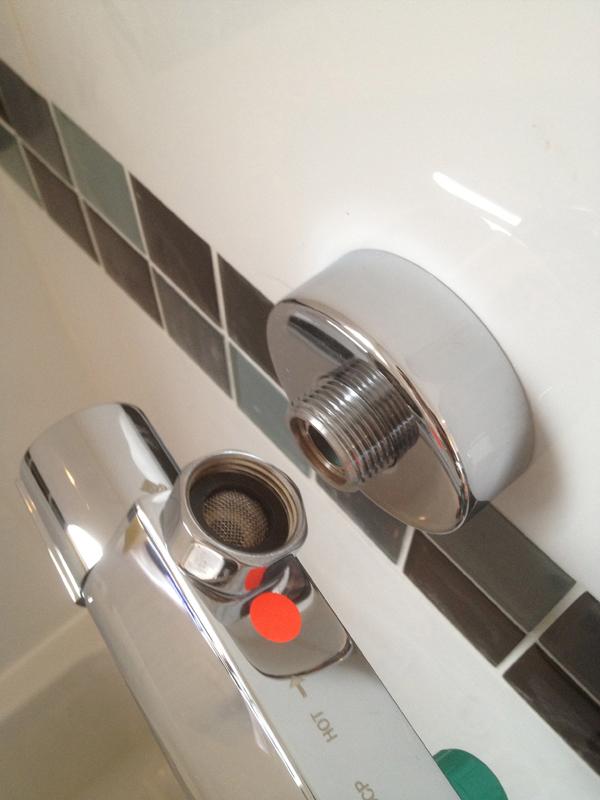

Onoff Posted December 26, 2018 Author Posted December 26, 2018 (edited) 6 hours ago, ProDave said: What's the full story? If your hot and cold are the wrong way round, then for it to work, your hose will have to come out of the top. Full story...always been a pain. To get the pump to kick in invariably you have to put the handset in the shower tray. Hose comes out the bottom. Same pic below (as the one above) is typical of my (Bristan) mixer: This is the rear: So in my case cold is going to the inlet nearest the temp dial with the "override" button on. No original instructions and no red dot sticker. Easy enough to swap over if it's wrong as on push fits. But is it wrong as is? Edited December 26, 2018 by Onoff

Onoff Posted December 26, 2018 Author Posted December 26, 2018 25 minutes ago, bassanclan said: Does the pump kick in on full cold? If so then then you know it's a hot water flow problem. It's probably worth taking the mixer bar off and looking at the little mesh filters at the point where the mixer screws onto the wall. It might be that the person who fitted it didn't flush the pipework through before fitting the mixer bar and the filter is full of rubbish No mesh filters that I recall when I took this off a little while back... ...no I didn't flush everything out... The hot pipe coming in is real hot as is the rear of the mixer...that side. At each end, screws under little removeable caps. I could only undo the assembly (cartridge) where the hot comes in. Couldn't budge the cold side. Trying to take the mixer off and the cold side would unscrew OK but the right would turn along with the threaded bit behind in this generic shot.
Nickfromwales Posted December 26, 2018 Posted December 26, 2018 Can you get mole grips / other on the rear whilst you undo the front nut?
Onoff Posted December 26, 2018 Author Posted December 26, 2018 1 hour ago, bassanclan said: Does the pump kick in on full cold? Sometimes...very rarely. That's when you have to drop the handset to tray level. 1 hour ago, PeterW said: Isn’t the hot on gravity ..?? If so, the tank pressure drop won’t be enough to trigger the pump as they need to see a bigger drop hence why when you put the shower head 6ft lower the pump triggers. Yes, gravity. Done the quick sketch below. No chance of raising the CWS tank as it's right against the rafters. Could likely lower the mixer. 56 minutes ago, Nickfromwales said: Can you get mole grips / other on the rear whilst you undo the front nut? Only got 3mm, don't think even long nose moles would get in to grip the thread that's turning.

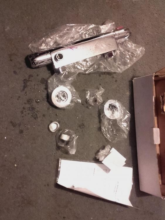

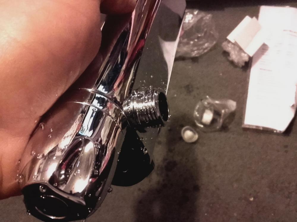

Onoff Posted December 27, 2018 Author Posted December 27, 2018 Just went for it with the adjustables! Undid the mixer: First oddity is it seems hot is going to the cold inlet and vice versa. Is it possible these are the wrong way around? The cold inlet has a small for the cartridge: And the hot cartridge inlet is larger: All the parts: If it comes to it I can move the mixer down: (This is all eventually going..."my" eventually! )
Onoff Posted December 27, 2018 Author Posted December 27, 2018 Did I make a mistake a little while ago? As original: Now. Same as. Pipe on the left at the top goes to hot. Pipe on the right goes to the cold.
