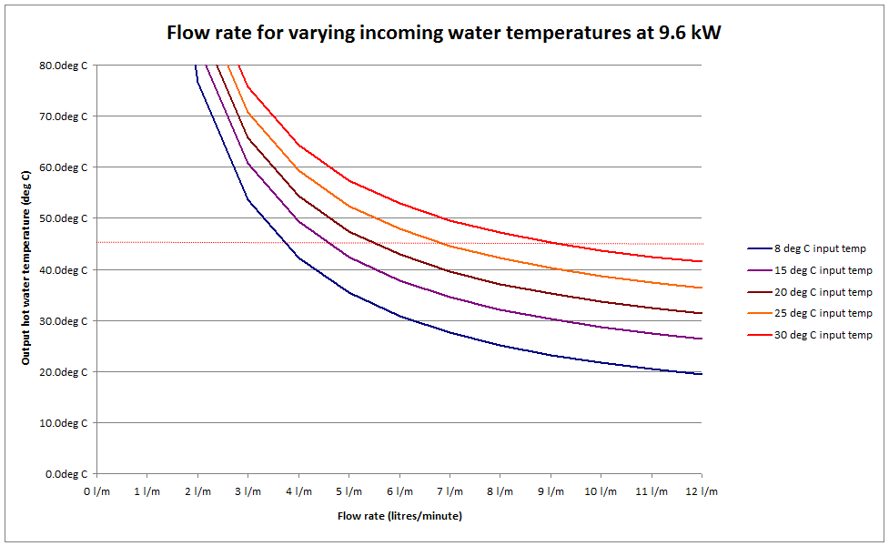

Jeremy Harris Posted December 16, 2018 Posted December 16, 2018 The Stiebel Eltron is clever enough to not turn on (or at least not turn the heating element on) when the incoming water supply is above the set point. It then modulates from zero power up to it's maximum rated power depending on the temperature differential between the inlet and outlet, trying to raise the outlet temperature to the set point as the inlet temperature reduces below the set point. This is heavily flow rate dependent, so the maximum temperature uplift the unit will give is dependent on flow rate. Here is the graph I drew up from when I was planning on using the unit to boost preheated water up to about 45 deg (the dotted red line):

Nickfromwales Posted December 16, 2018 Posted December 16, 2018 40 minutes ago, JSHarris said: This is heavily flow rate dependent One of the reasons I wouldn't fit one. This is a case of prevention is better than cure IMO. Just hit the immersion and job done, thats if you actually need it thats is. A 300L UVC set up correctly should give bags of DHW. Lets say Joe Blogs asks for one to be fitted. All up I bet you'd be in for a minimum of £500.00 £500 worth of electricity would get you around 3,500 kWh of juice. Put that through an ASHP and use a multiplier of 2.5 ( SCoP ) and you have ~8,700 kWh to spend on "boost". You then dont have to worry about running out of water and telling the family to slow the flow down when you run out of hot water Turn up the stat Dave ! Case dismissed. As a note, these instant heaters are routinely fitted ( multiples of ) in places like McDs and KFCs as doomsday devices, so if the UVCs go off for any reason the restaurants ( lol ) can simply switch manual lever valves and divert to the instants in order to tick the boxes required to stay open. 1

Nickfromwales Posted December 16, 2018 Posted December 16, 2018 These were never plumbed in series, always in parallel as an ‘alternative’ source of DHW due to flow restriction. 17ltr/p/m is ok but for two showers at the same time you’ll be pushing it. Plus, at anywhere near 17lpm the Steibel would be giving you huge quantities of cold water. @Stones, how many times have you run out ? ?

ProDave Posted December 16, 2018 Author Posted December 16, 2018 55 minutes ago, Nickfromwales said: These were never plumbed in series, always in parallel as an ‘alternative’ source of DHW due to flow restriction. 17ltr/p/m is ok but for two showers at the same time you’ll be pushing it. Plus, at anywhere near 17lpm the Steibel would be giving you huge quantities of cold water. @Stones, how many times have you run out ? ? Yes but the Steibel is the "safety net" If you are the unlucky one that has the last shower and it runs cold, then the Steibel will let you finish your shower and get the shampoo out of your hair, but you might have to turn the flow down a bit to maintain an acceptable temperature. That is it's purpose, and sounds infinitely better than nothing but cold water to rinse your hair. That is all it is for, nothing more nothing less. 2
Jeremy Harris Posted December 16, 2018 Posted December 16, 2018 Also, the hot water doesn't usually suddenly run out and turn cold as the tank runs out of capacity, it just gets too cool to be usable. Boosting it when it's at this "too cool" stage still allows it to be used for a short time, depending on the flow rate. For example, it would allow you to get a comfortable shower of over 40 deg C with the water from the tank only being at 30 deg C, even at 10 litres/minute. Interesting to look at the performance of electric showers, in terms of flow rate. For mains water coming in at 8 deg C (not untypical, that's about the temperature we used to get from the mains at our old house) then a 10 kW electric shower can only provide a shower at 38 deg C (about the temperature we seem to prefer) at a flow rate of about 4.75 litres/minute. Lots of people see to manage OK with showers that work at this low flow rate, we did for around 5 or 6 years, until we had the combi boiler installed at the old house.
