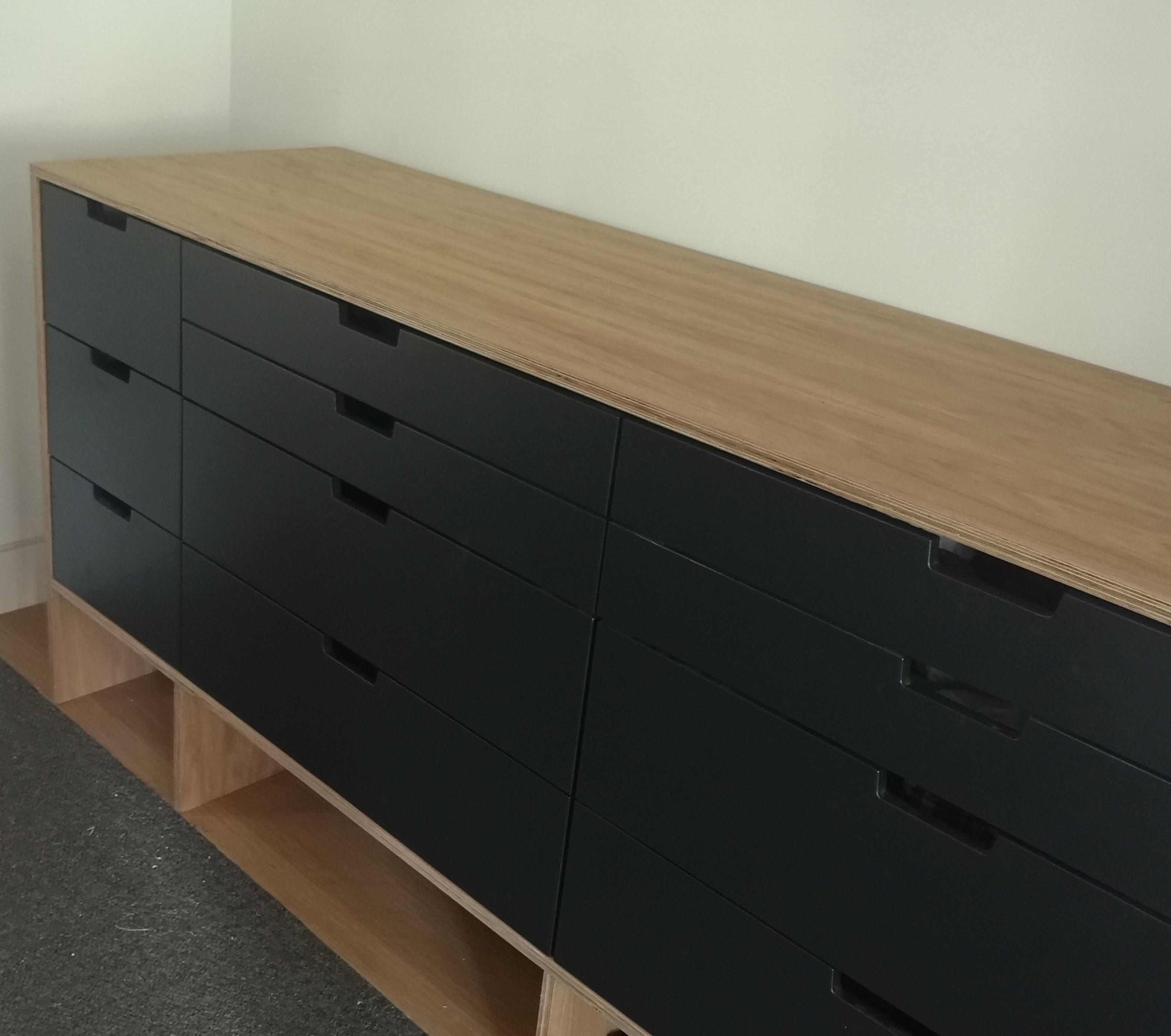

jack Posted May 1, 2021 Posted May 1, 2021 19 hours ago, tanneja said: Edit, sorry read your first part of your message. if you feel happy to share any of your furniture creations, I would be very grateful to see the overall style you have achieved, I offer my apologies if it is an invasive request. Trying to negotiate 19mm oak faced ply window reveals (all the way around, with the ply layers on show) to other half, any situational pictures of the material may be helpful. I'll grab a photo later today.

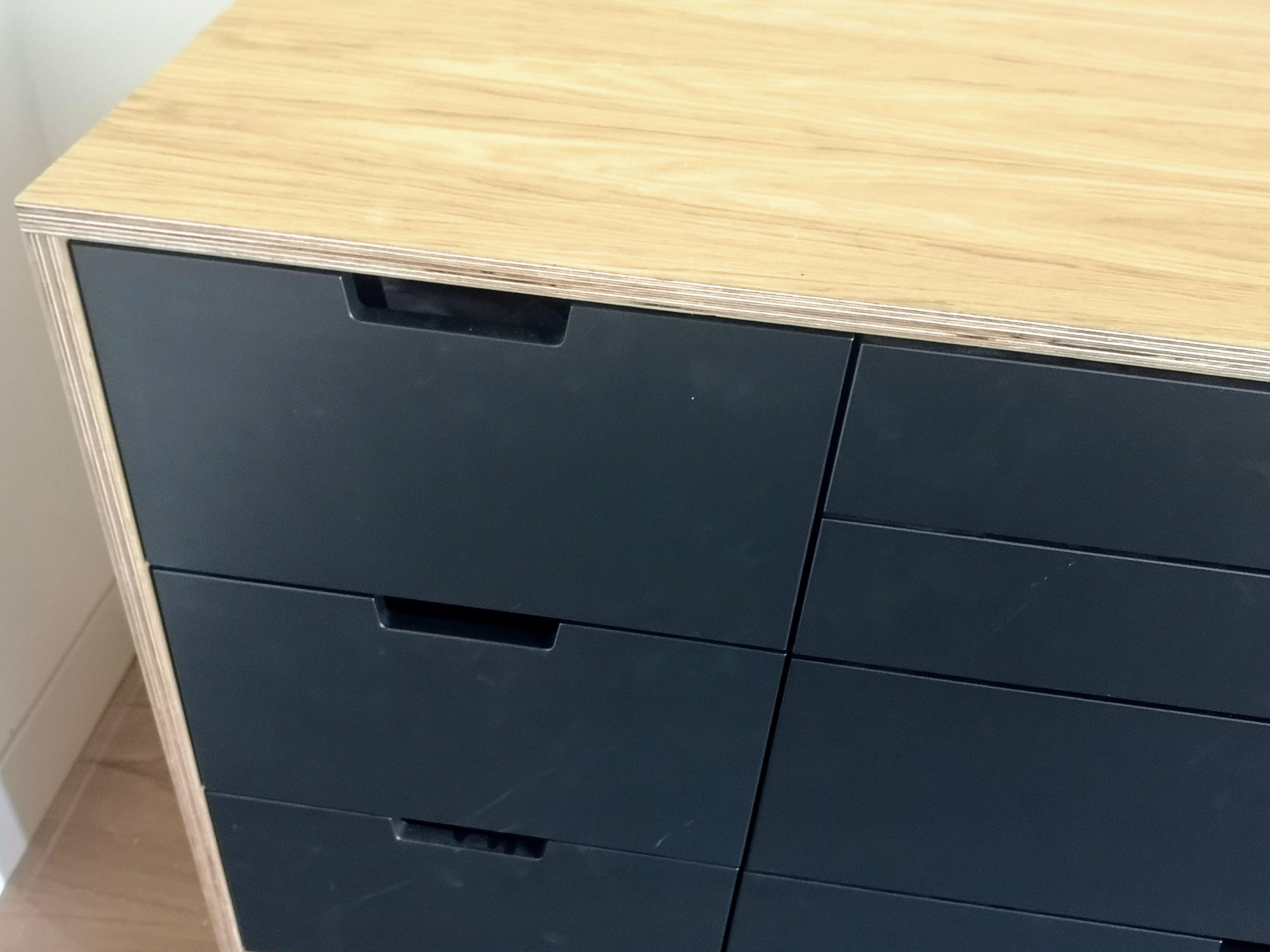

jack Posted May 1, 2021 Posted May 1, 2021 On 30/04/2021 at 15:44, tanneja said: Hi Jack, did you make 19mm ply window boards yourself, and if yes, do you have finished pictures? Edit, sorry read your first part of your message. if you feel happy to share any of your furniture creations, I would be very grateful to see the overall style you have achieved, I offer my apologies if it is an invasive request. Trying to negotiate 19mm oak faced ply window reveals (all the way around, with the ply layers on show) to other half, any situational pictures of the material may be helpful. Hi again Here's what I did. (Ignore the dust and threads - I've just finished refitting the carpet) I have to say that even though I got oak faced birch plywood that was specifically stated as being suitable for use with exposed edges, there's a lot of uneven colouring in the ply layers that I wasn't expecting. I'm sure some of it was me getting used to the tracksaw I bought to do the project (darkening due to heat) but I don't think that explains it all The oak veneer looked okay though. It comes in an A side and B side - the B side definitely didn't come up as nicely in a few areas but I was mostly able to position that out of sight. 2
tanneja Posted May 4, 2021 Posted May 4, 2021 @jack your workmanship is superb! I see what you mean about the exposed edge unevenness, presumably that is down to the layers and not you. For what it is worth, to me it doesn't detract from the finish.
jack Posted May 4, 2021 Posted May 4, 2021 43 minutes ago, tanneja said: @jack your workmanship is superb! I thought I'd mentioned it above, but it appears not (maybe I mentioned it on another thread). For the avoidance of any doubt, I didn't make the drawers, they're Ikea! I just boxed them in. One day when I have more time (and experience!), I'll replace the innards with proper drawers. The Ikea ones aren't very deep, aren't full extension, and generally just feel unpleasant to use.
tanneja Posted May 4, 2021 Posted May 4, 2021 @jack I was referring to your corner detailing, everything looks really sharp. To the layman its impressively clean with no visible pin holes etc. Thank you again for sharing. 1
jack Posted May 4, 2021 Posted May 4, 2021 1 hour ago, tanneja said: @jack I was referring to your corner detailing, everything looks really sharp. To the layman its impressively clean with no visible pin holes etc. Thank you again for sharing. The track saw really helped with this. I can't recommend them highly enough for anyone planning to make furniture (or anything else needing clean, sharp cuts) from sheet materials. 1
