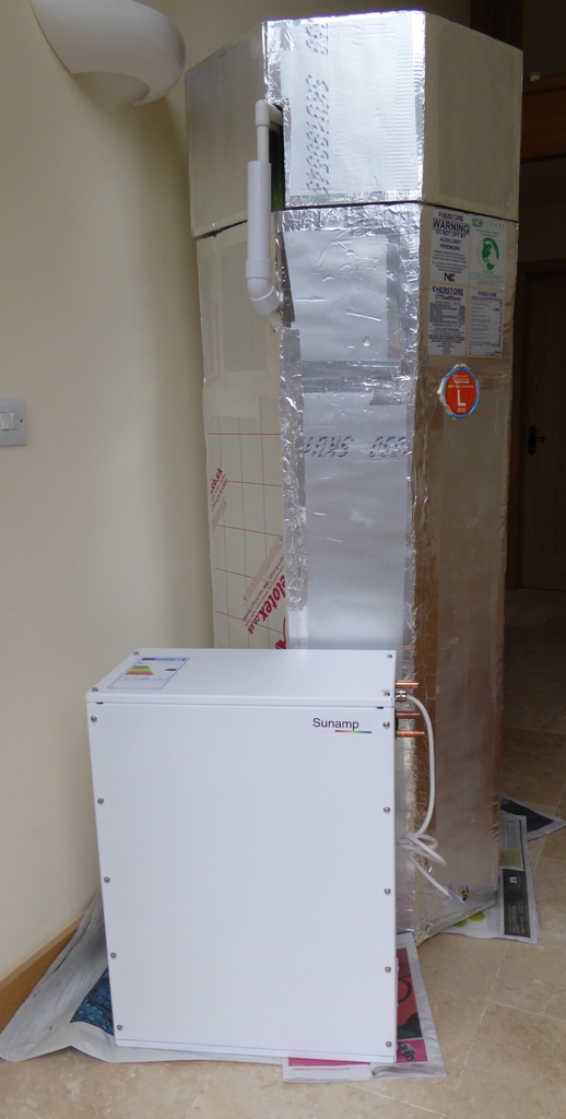

Jeremy Harris Posted December 6, 2018 Share Posted December 6, 2018 Not at all sure there's any inherent efficiency advantage between the way the heat exchange system works in a Sunamp relative to the way it works in a water-filled thermal store. The only efficiency gain I can see comes from the lower losses from the outer surfaces of a PCM heat battery, as despite the different mechanism for storing heat energy, there's nothing else that I can see that would impact on efficiency to any noticeable degree. There may be a very slight decrease in efficiency for a PCM based heat battery resulting from the need to overcharge it slightly to ensure that all the PCM has changed from solid to liquid, but this is probably tiny. Link to comment Share on other sites More sharing options...
Big Neil Posted December 6, 2018 Author Share Posted December 6, 2018 So practically speaking, with current systems, not that much difference relatively speaking in terms of efficiency assuming correct design for the intended purpose. To use you as an example Mr Harris, given what you knew at the time you got your current SunAmp unit, was space the primary reason for going to a PCM (Phase Change Material??) system as opposed to an insulated tank? Could one actually use both systems in tandem to effectively minimise any losses further, particularly in a case where one has PV but no battery storage? Actually, with the mammoth bulging case thread in mind, could you use a tank system to dump some of the capacity from the sunamp given the 50/90% issue, in order to them utlise the excess PV better? Also to clarify, is system not for heating, but just all water outlets? Link to comment Share on other sites More sharing options...
Jeremy Harris Posted December 6, 2018 Share Posted December 6, 2018 29 minutes ago, Big Neil said: So practically speaking, with current systems, not that much difference relatively speaking in terms of efficiency assuming correct design for the intended purpose. To use you as an example Mr Harris, given what you knew at the time you got your current SunAmp unit, was space the primary reason for going to a PCM (Phase Change Material??) system as opposed to an insulated tank? Could one actually use both systems in tandem to effectively minimise any losses further, particularly in a case where one has PV but no battery storage? Actually, with the mammoth bulging case thread in mind, could you use a tank system to dump some of the capacity from the sunamp given the 50/90% issue, in order to them utlise the excess PV better? Also to clarify, is system not for heating, but just all water outlets? There were two reasons I opted to remove our old thermal store and replace it with a Sunamp. The first was heat loss. Despite adding an extra layer of 50mm PIR foam around the store, foaming it in place and sealing the edges with tape, we were still losing around 2.5 kWh/day from it, and that was making the services room very hot (over 40 deg C in summer) and damaged the oak door between it and the adjacent bedroom. It also made the adjacent bedroom too hot. The secondary reason was to free up space in the services room, as the thermal store took up a lot of room. This is a size comparison between our old thermal store (after I'd removed it), complete with added layer of insulation, and the original Sunamp PV to give an idea of the difference between the two: Using a hot water tank in conjunction with a Sunamp doesn't really make that much sense to me, as you may as well just choose to use a bigger water tank to do the whole job. Although a water filled store will not suffer from the inability to accept excess generated power when it cools below the thermostat set temperature, it will lose a lot more heat than a Sunamp, so over a few days of sporadic excess PV generation I doubt there would a difference between the two in practice. Adding a lot more insulation to a hot water tank, and reducing any heat lost from attached pipes, etc, would, perhaps, even things up, albeit at the expense of a much greater volume taken up. Link to comment Share on other sites More sharing options...
