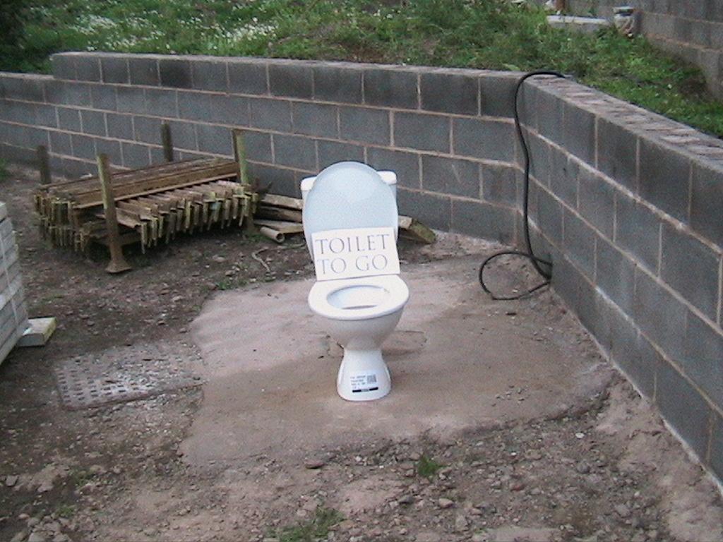

newhome Posted December 4, 2018 Share Posted December 4, 2018 Here’s mine but it was put right next to the manhole. Link to comment Share on other sites More sharing options...
