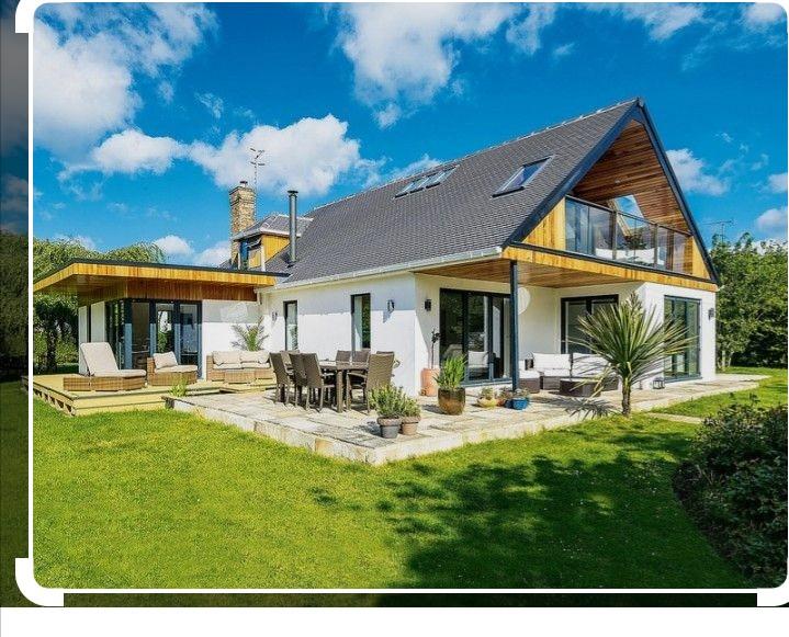

canalsiderenovation Posted November 16, 2018 Share Posted November 16, 2018 (edited) We are looking at ideas for wood cladding. We are looking to have Tata metal cladding and then wooden cladding underneath the balcony as per the pic (we will also have skylights in the balcony which aren't shown on our plans), and also wood cladding on the underneath of our porch which will be partly flat roof. We are next to the canal and we want a wood that will be hard wearing given the damp conditions in winter close to the canal and Accoya has cropped up twice. Has anyone had any experience of using it, good, bad, alternatives? It won't be a particularly large area and won't have direct exposure as will be undercover but still want something fairly maintenance free. Edited January 23, 2019 by canalsiderenovation Link to comment Share on other sites More sharing options...

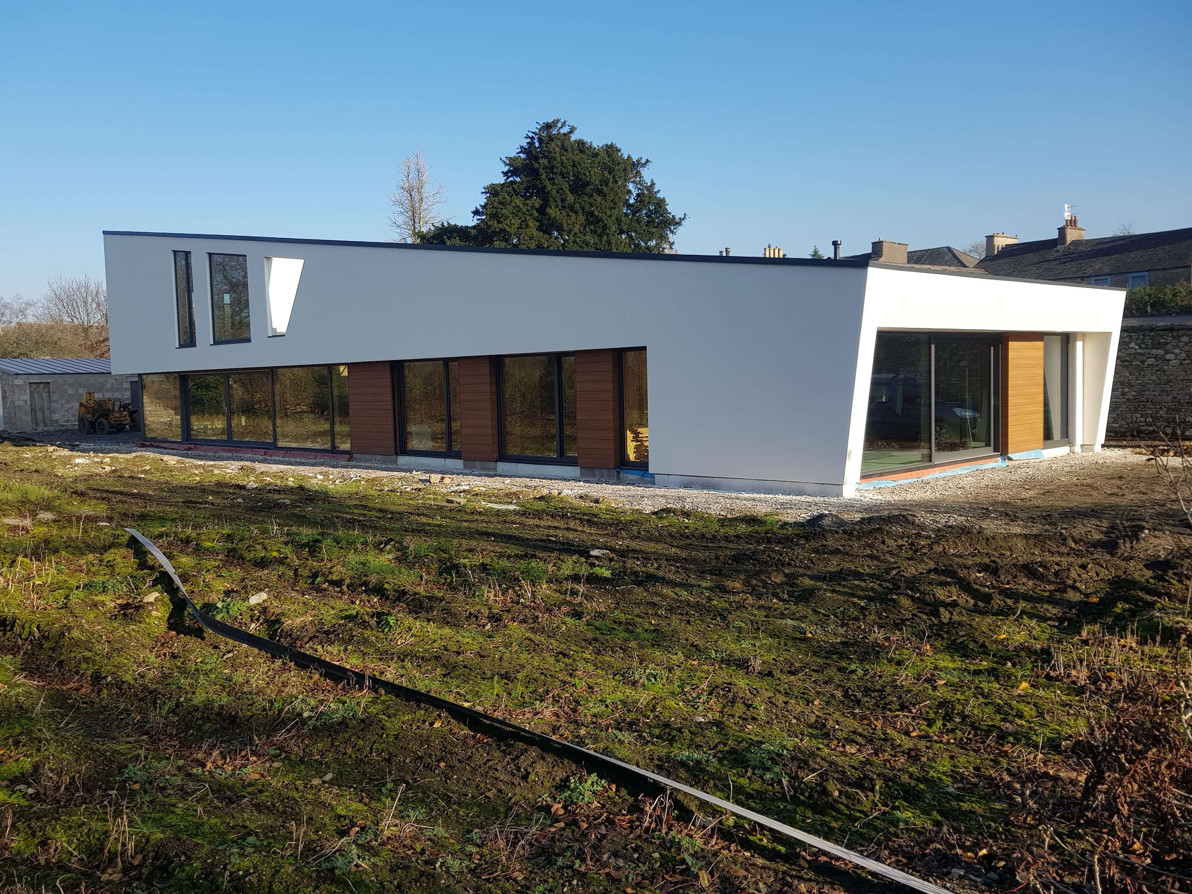

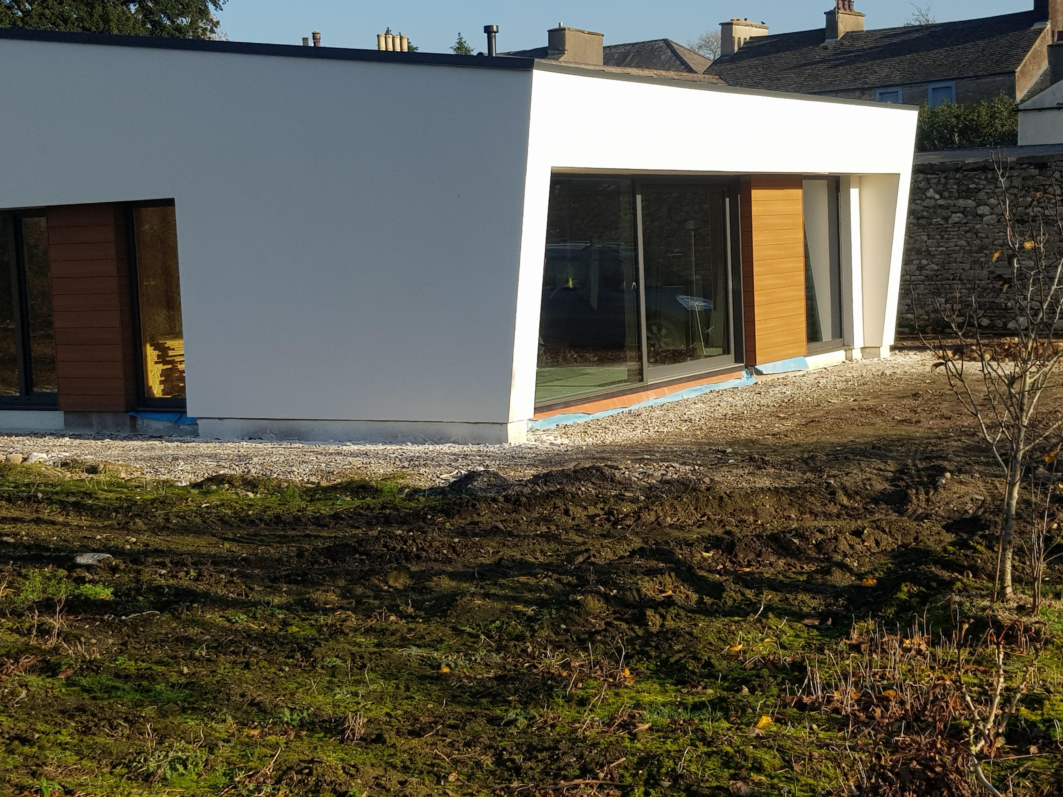

Pete Posted November 17, 2018 Share Posted November 17, 2018 On 16/11/2018 at 14:38, canalsiderenovation said: We are looking at ideas for wood cladding. We are looking to have Tata metal cladding and then wooden cladding underneath the balcony as per the pic (we will also have skylights in the balcony which aren't shown on our plans), and also wood cladding on the underneath of our porch which will be partly flat roof. We are next to the canal and we want a wood that will be hard wearing given the damp conditions in winter close to the canal and Accoya has cropped up twice. Has anyone had any experience of using it, good, bad, alternatives? It won't be a particularly large area and won't have direct exposure as will be undercover but still want something fairly maintenance free. We have used Trespa wood panels 2 Link to comment Share on other sites More sharing options...
canalsiderenovation Posted November 17, 2018 Author Share Posted November 17, 2018 That looks great, did you stain or treat the wood? Link to comment Share on other sites More sharing options...
Pete Posted November 17, 2018 Share Posted November 17, 2018 Google Trespa Pura. It is a man made product which does not need any treatment except a wash down now and then. We do not like it when the wood silver's as we think it would spoil the look of the house. 25sq m cost about £3000 and I fitted it myself. 1 1 Link to comment Share on other sites More sharing options...

D Walter Posted December 14, 2018 Share Posted December 14, 2018 Interesting as we are also using Tata for the roof (also cladding some of the walls in Tata) and are concerned that the timber clad walls going naturally grey may make the whole house grey and lose the contrast between metal and timber. Link to comment Share on other sites More sharing options...
Pete Posted December 15, 2018 Share Posted December 15, 2018 11 hours ago, D Walter said: Interesting as we are also using Tata for the roof (also cladding some of the walls in Tata) and are concerned that the timber clad walls going naturally grey may make the whole house grey and lose the contrast between metal and timber. Hence why we used Trespa so it will not change colour Link to comment Share on other sites More sharing options...
