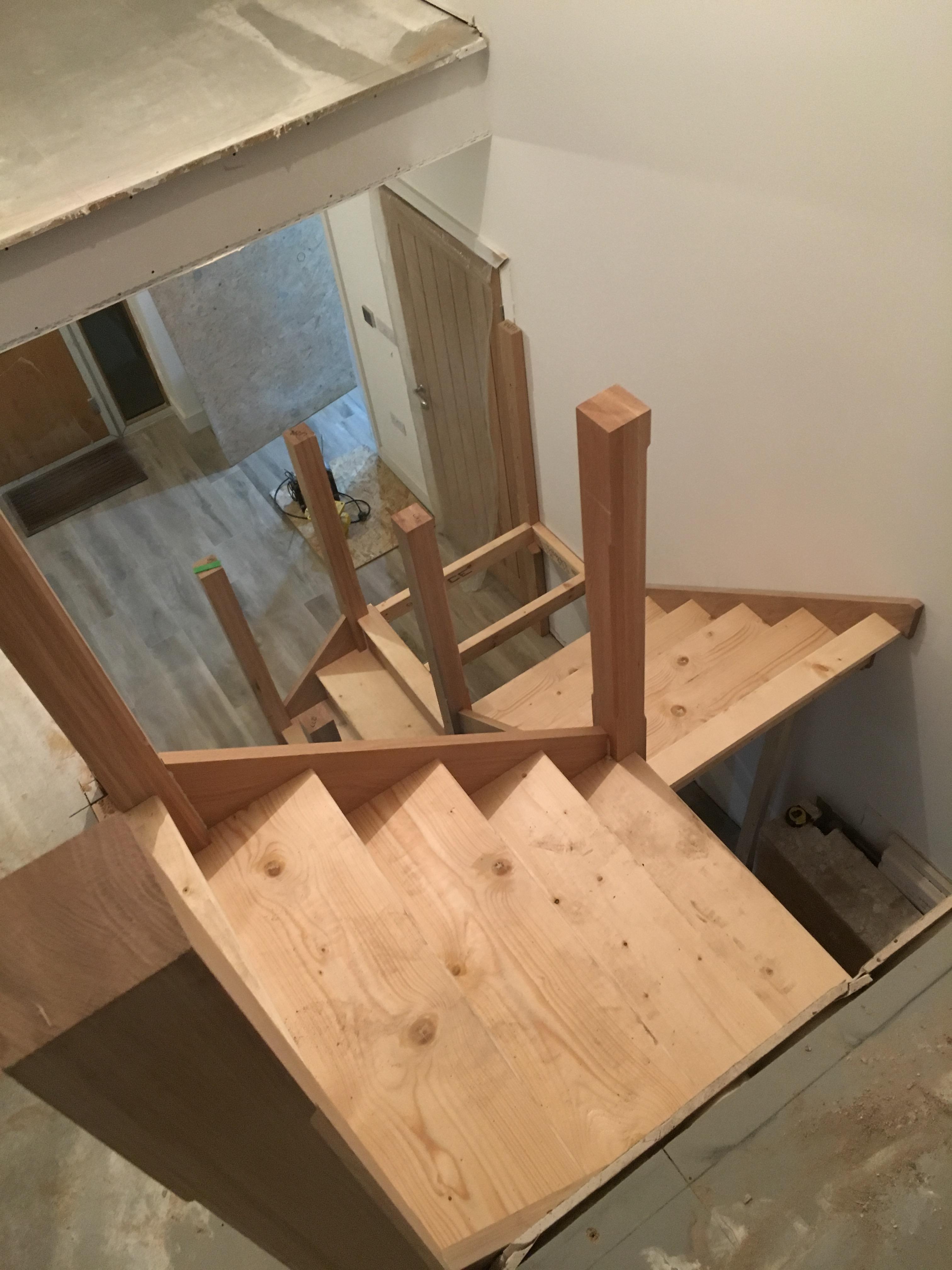

nod Posted November 11, 2018 Posted November 11, 2018 Stairs manufacturer have made our oak stairs 100 mill to big I could and should get them to alter Nut times not on our side I’ve finished up tight agains the downstairs loo I have a 864 door hung Removing the casing and replacing with a 762 door would work Under building regs Am I allowed to do this Or is there a disabled access rule to prevent me ? 1
Jeremy Harris Posted November 11, 2018 Posted November 11, 2018 Building regs require a minimum clear opening width for the entrance level WC of 750mm. Unless a 762mm door can be made to open right back, and only have thin stops, I doubt that you can make it comply, I'm afraid. 1
ProDave Posted November 11, 2018 Posted November 11, 2018 According to this picture: The stairs are in place and so is the door. Not ideal but all you have to do is scribe the architrave around the newel post and you can keep the wider door.
