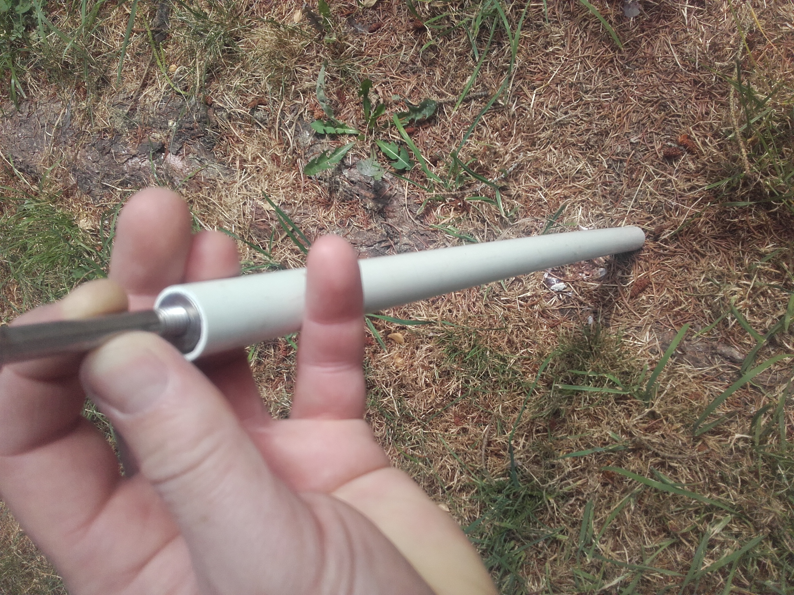

Onoff Posted July 31, 2016 Share Posted July 31, 2016 (edited) How about the "industrial " look? A length of studding with (penny?) washers & nuts either side of each shelf. For cleaner lines you could cover the studded sections with 20mm white pvc conduit which would be in keeping with the 16/18mm shelf thickness. I'll have a play later with what fits into what. & here you go. M8 fits just right: You would have to set it back to miss any cornice. Edited July 31, 2016 by Onoff Link to comment Share on other sites More sharing options...
