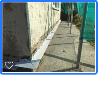

Onoff Posted November 8, 2018 Author Posted November 8, 2018 8 minutes ago, JSHarris said: My concern with using it as EWI would be damp penetration. Unlike rockwool, blown cellulose will support fungal growth, even when treated with borax, I believe. So can you safely bridge the DPC with Rockwool? As in if taking any retro fit EWI down past it (the DPC) to help with cold bridging at floor level.
PeterW Posted November 8, 2018 Posted November 8, 2018 3 minutes ago, Onoff said: So can you safely bridge the DPC with Rockwool? As in if taking any retro fit EWI down past it (the DPC) to help with cold bridging at floor level. Plenty on this but it’s pretty much you can bridge it regardless of what you use as none of them will promote damp 1
Jeremy Harris Posted November 8, 2018 Posted November 8, 2018 13 minutes ago, Onoff said: So can you safely bridge the DPC with Rockwool? As in if taking any retro fit EWI down past it (the DPC) to help with cold bridging at floor level. Yes, but as above I'd have concerns with using blown cellulose, as that can hold moisture well and will probably sustain fungal growth. Rockwool, EPS, XPS etc are all fine when bridging the DPC, AFAIK.

gravelld Posted November 8, 2018 Posted November 8, 2018 11 hours ago, Onoff said: So can you safely bridge the DPC with Rockwool? Personally I'm not so sure on that. You're relying on it not getting wet *at all*. Would use EPS or XPS myself (almost all the systems manufacturers use the latter, although the evidence for that is a little scant).
