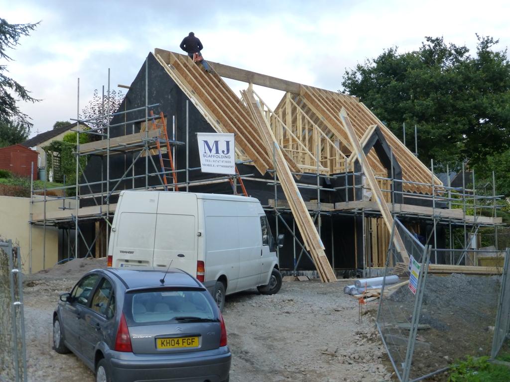

Our house also has a big laminated timber ridge beam (~450mm deep) that runs the length of the house, supported by both end gable walls and two internal walls, 2m apart, 1m either side of the longitudinal centreline.  We have 403mm deep rafters, hung from the ridge beam down to the top of the walls.  The rafter pitch is 45 deg, which gives us an external appearance that's close to that of a bungalow (which is all the planners were inclined to approve), yet gives us around 4m of height in the vaulted ceiling first floor rooms, plus is gives us a 6.5m high vaulted ceiling in the entrance hall, that definitely makes a relatively small house seem a lot larger and more airy inside.  There are some photos on our blog, along with the whole build tale: http://www.mayfly.eu/

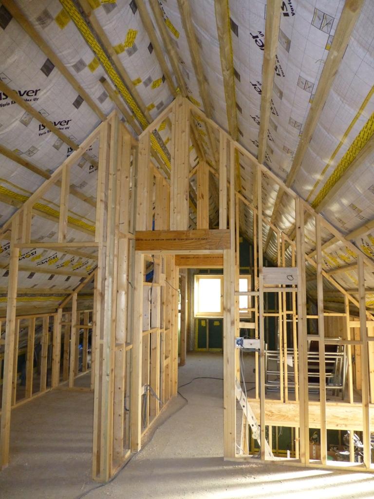

We have Posijoists and a big ridge beam supporting deep I beam rafters for our room-in-roof design.  Works well, but does need a deep ridge beam to take the load of the rafters hanging from it.  With this design there are no tensile loads transmitted to the first floor joists, as the rafters hang from the ridge beam.  Some photos:

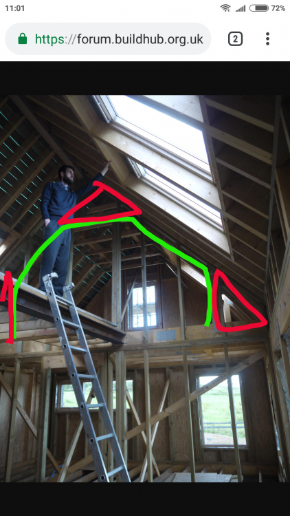

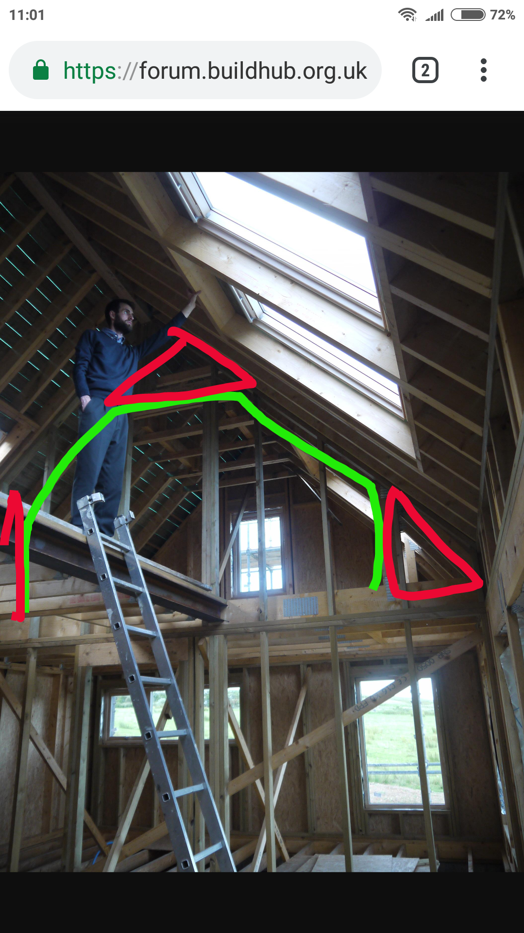

The main difference in using attic truss and a cut roof is with a cut roof you will have the ability to bring your insulation and any membrane you are using from one wall plate up and down and  over to the other side with no breaks.
With attic truss you will be left with the three triangle areas, red areas in pic,  which will be cold areas as they are outside the standard insulation area. Your membrane will go where the green line is on the pic.
You can of course go for a warm roof and then all the insulation is between and above the truss.
The  only other thing to remember is a cut roof is only as good as the  joiner cutting it. Attic truss are precision  factory made.
Both types of roofs have their advantages and disadvantages and each will require specific detailing with regards insulation and membranes.
