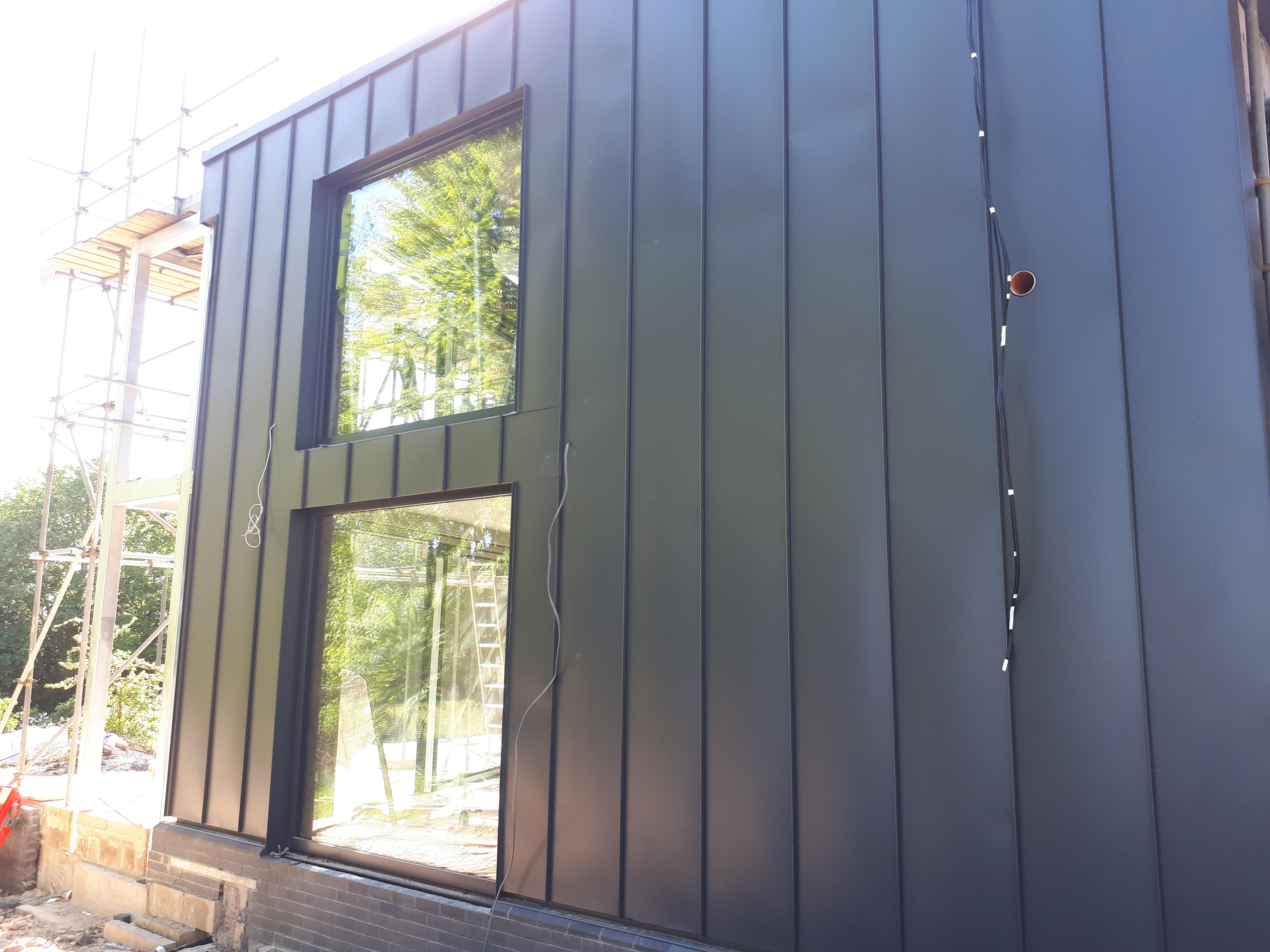

D Walter Posted May 12, 2019 Share Posted May 12, 2019 Hi Tim, We have clad about 1/2 of the external walls with vertical standing seem Tata Colorcoat Urban and did not cut off the external ties. We are going to use Trespa Pura on the remaining 1/2 and don't think we will bother to cut off the ties. We took the view that, particularly with the internal ties cut off, the external ties will make no appreciable impact on thermal bridging and will not interfere with our battens. 1 Link to comment Share on other sites More sharing options...

D Walter Posted May 12, 2019 Share Posted May 12, 2019 Hi Tim, do you mean Tata or Trespa Pura? I can load pics of the Tat at this stage but will wait a bit till the scaffolding is down. The Trespa will take a bit longer.... Link to comment Share on other sites More sharing options...
Tim Alsop Posted May 13, 2019 Author Share Posted May 13, 2019 16 hours ago, D Walter said: Hi Tim, do you mean Tata or Trespa Pura? I can load pics of the Tat at this stage but will wait a bit till the scaffolding is down. The Trespa will take a bit longer.... I am interested to see both. Thank you. Link to comment Share on other sites More sharing options...

D Walter Posted May 15, 2019 Share Posted May 15, 2019 Sorry the picture is not great but this is the only bit of Tata without scaffolding at the moment. When more of the scaffolding is down I will post some more pics including fascias and soffits and roof. 1 Link to comment Share on other sites More sharing options...
Tim Alsop Posted May 15, 2019 Author Share Posted May 15, 2019 1 hour ago, D Walter said: Sorry the picture is not great but this is the only bit of Tata without scaffolding at the moment. When more of the scaffolding is down I will post some more pics including fascias and soffits and roof. Thank you. Since this thread is about Velox and I am planning to build my house using Velox, can you share how you fixed this onto the Velox board ? Link to comment Share on other sites More sharing options...
