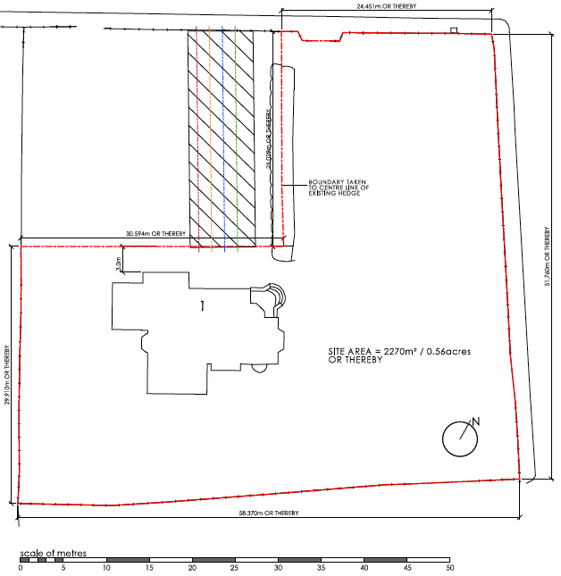

AliG Posted October 12, 2018 Author Posted October 12, 2018 Looks like it should be OK. Because of the services and allowing for the house to be roughly 2m from the boundaries and 9m from the boundary with the house behind it has to fit in a space roughly 17.5m wide by 14.5m deep. We will apply for something covering 155sq metres which is 20% of the area of the plot. 1
ProDave Posted October 12, 2018 Posted October 12, 2018 Are you missing a trick here? A plot that big in the city would surely support more than 1 house? Or are you planning a phase 2 later on to the right of the house you propose? (what is the significance of the "1" in the house outline?) 1
AliG Posted October 12, 2018 Author Posted October 12, 2018 (edited) 15 minutes ago, ProDave said: Are you missing a trick here? A plot that big in the city would surely support more than 1 house? Or are you planning a phase 2 later on to the right of the house you propose? (what is the significance of the "1" in the house outline?) It's just number 1 in the street. Just to clarify the plot we are buying is the small one with the lines through it, the rest of the area os the garden of number 1. Number 1 is listed. It was up for sale in 2015 I think. It had a stair lift, old kitchen etc, so presumably was lived in by an old person who had not upgraded it. A local developer bought it, did it up then sold it but kept back around 25% of the garden. They initially applied for permission for a larger two storey modern house with double garage, it was withdrawn. They applied for permission in half the plot we have bought for a small 2 storey house, there was a mysterious area listed as garden ground owned by the applicant but not part of the house plot. I think that then once it was up trying to creep along the road and build another house was exactly their plan. They then applied to enlarge the house they had permission for but it was withdrawn. I did ask have a quick call with the council and the person I spoke to said that they didn't want any more of the area built over, even for a single storey house. The reason seems to be that it encroaches too much on number 1 that is listed. I have taken a flyer that is nonsense. The house on the opposite corner is also listed. A house has been built in its garden that covers around 250 square metres of ground and is two storeys tall. It covers a larger area of than the listed house. Considering this precedent it would be difficult to refuse what we are proposing. I think keeping it single storey so that you cannot see it, the hedges around the site are over 3m tall, gives it the best chance of being approved. This is the kind of house that my parents would like, whilst something else might maximise the value of the plot it would be hard to get permission. Even with what we are asking for I have a couple of backup plans. There were a lot of objections to the two storey houses applied for due to overlooking and the effect on the streetscape, I think one storey will be a lot less annoying to people in the area. Edited October 12, 2018 by AliG

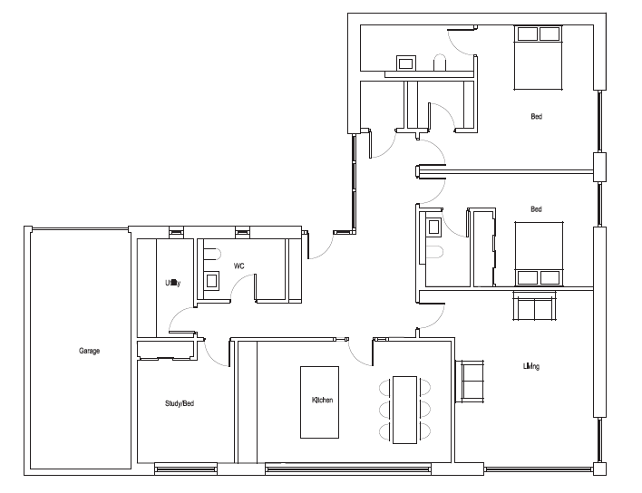

AliG Posted December 5, 2018 Author Posted December 5, 2018 Got preliminary floor plans from the architect if anyone wants to comment. The changes I have already suggested are - 1. Door into garage 2. Window in lounge opposite the entrance door. 3. The WC is larger than many bathrooms, our reading of the Scottish building regs is that there needs to be provision for a public bath/shower room, so we have left space for one. But it is 2.6m across excluding the bulkhead which seems too much. I would shave off 2-300mm from the and the kitchen due to the limitations of the amount of site coverage we can have. Maybe we start with this and have that in our back pocket. 4. Some kind of covering outside the front door. The bottom of this is South.
ProDave Posted December 5, 2018 Posted December 5, 2018 Scottish BR say you must have space to fit a 900 by 900 shower plus it's activity space You might as well fit the shower rather than just leave the space (and install the drain for it) . You need to model the room with all the activity spaces. The door will probably have to hing outwards. My gut feeling is making both bedrooms en-suite is an extravagance in such a small house. Make the middle bedroom just a bedroom and the back one a bigger bedroom with en-suite by ditching those cupboards.
AliG Posted December 5, 2018 Author Posted December 5, 2018 The 2 en suites was my idea, as my parents occasionally have people stay I just think it is nice that they don't have to come out into the hall to use the bathroom in they don't have to. It is extravagant, but the idea is to have a small house with the feel of a large house, I kind of thought of taking what they build as luxury flats for downsizes and making that a house. I think the architect has allowed for the activity space in the WC, but we have discussed would we just put a shower or a bath in there. I think the regs are stupid in that a shower or bath off a bedroom on the ground floor doesn't count as accessible, it has to be open to the public as it were. We could make some of the WC a cupboard and have a drain in there with a partition that could be taken down.
ProDave Posted December 5, 2018 Posted December 5, 2018 How about make one of the en-suites a Jack and Jill also opening to a circulation space. I believe that would then obviate the need for a public shower, so the toilet could be smaller (but check that with BC first) The space saving idea we have is the downstairs WC is in the utility room. Not to everyones taste, but BC are happy with it as long as it has disabled access and there is room for a shower to be added later (if we did that we would divide it into 2 rooms)
