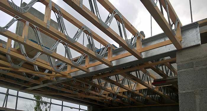

Triassic Posted October 3, 2018 Posted October 3, 2018 Rather than I-Beams why not use metal web joists, so much more practical when running cables and other services.
Nick1c Posted October 3, 2018 Author Posted October 3, 2018 I am considering using the I-beams for shell rather than the first floor. I have seen that type of joist on builds round here and wondered if there is much spring in the floor once one is laid, I presume they are stiffer than they look!

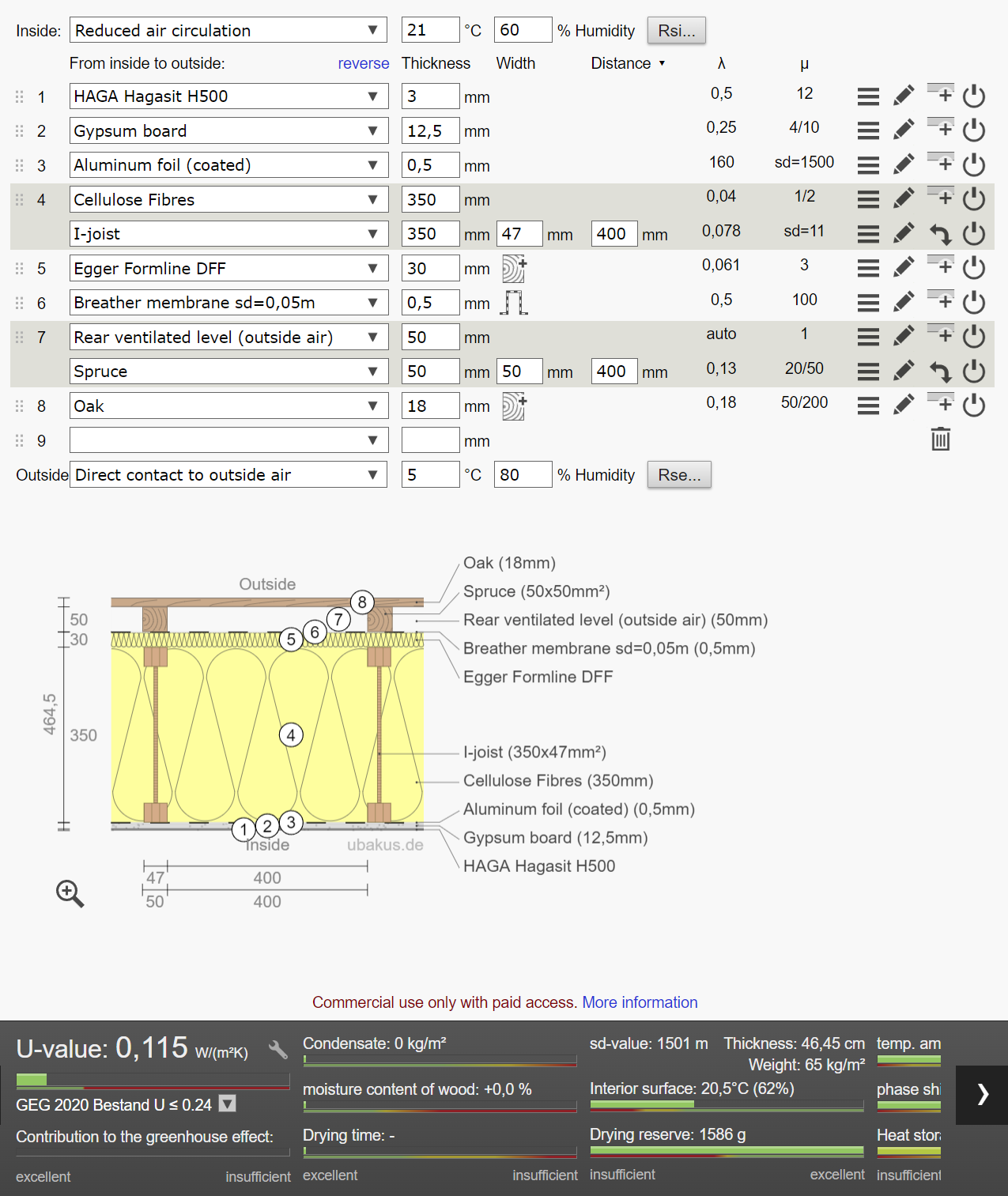

Simplysimon Posted October 3, 2018 Posted October 3, 2018 @Nick1c it depends on whether you want to hit or exceed building regs. if you wish to acheive min insulation timber is the easiest to source, find a joiner to buid a kit and insulate. if you wish to exceed regs, as many of us do, I beams are one of the ways. choose 350mm to get .1u value with blown cellulose, so no air spaces. you will still have an external cavity so damp shouldn't be a problem. this is the way i'm going though i'm having a service void to alow me to insulate then run water/elec at my leisure.

Alan Ambrose Posted February 6, 2024 Posted February 6, 2024 @Simplysimon - does that mean you're heading for a 50cm wall thickness by the time you've added rainscreen and service void etc?

IanR Posted February 6, 2024 Posted February 6, 2024 1 hour ago, Alan Ambrose said: does that mean you're heading for a 50cm wall thickness by the time you've added rainscreen and service void etc? You only need to put a Service void where you are running plumbing, and in those cases there's often another option, ie within cabinets, or false walls hiding a concealed system, or within bath enclosures, or...etc. etc. Suitably rated electrics can run within the insulated wall/roof. So you could be at 465mm for a very high performing wall/roof structure. You could go 50mm less on the I-Joist / insulation and still meet PassivHaus targets. 1
