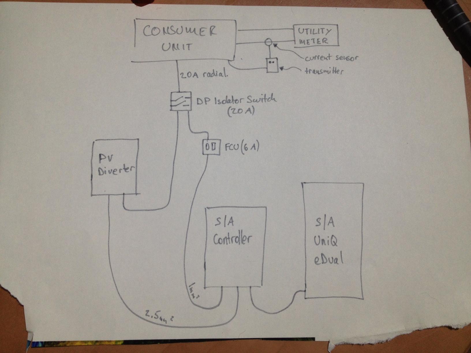

oranjeboom Posted October 16, 2018 Share Posted October 16, 2018 (edited) On 05/10/2018 at 22:10, JSHarris said: OK, I'm going to do write up, with photos, on our experience with first a Sunamp PV, and since the beginning of this week with a Sunamp UniQ 9 eHW, as a blog entry this weekend. Good morning Jeremy! Did you already manage to update your blog? I had a look this morning, but could not find your "dummies guide to installing a Sunamp UniQ". Have the electrician coming shortly and no doubt he may need input. Not had my coffee yet, so I may have overlooked it on your blog. Edited October 16, 2018 by oranjeboom Link to comment Share on other sites More sharing options...
Jeremy Harris Posted October 16, 2018 Share Posted October 16, 2018 Sorry, it's still only half done. I will try and get the diagram finished and something up over the next day or two. Link to comment Share on other sites More sharing options...
oranjeboom Posted October 16, 2018 Share Posted October 16, 2018 3 hours ago, JSHarris said: Sorry, it's still only half done. I will try and get the diagram finished and something up over the next day or two. No problem Jeremy - thought I may have overlooked it. Electrician did come this morning and was scratching his head so I told him to leave it for now, rather than me paying for him to be reading the Sunamp and PV diverter instructions. So no rush on my account Jeremy! Link to comment Share on other sites More sharing options...

Jeremy Harris Posted October 16, 2018 Share Posted October 16, 2018 7 minutes ago, oranjeboom said: No problem Jeremy - thought I may have overlooked it. Electrician did come this morning and was scratching his head so I told him to leave it for now, rather than me paying for him to be reading the Sunamp and PV diverter instructions. So no rush on my account Jeremy! If you're fitting a Sunamp UniQ eHW then all the electrician needs to run is a low current (6 A) supply via a fused connection unit (FCU) plus a 16 A supply. Run a 20 A radial from the consumer unit to the PV diverter location, fitted with a 20 A double pole isolating switch. Run a cable from this isolator directly to the PV diverter, then run an additional cable from the isolator to the FCU, fused at 6 A. Run two cables from the PV diverter location to the Sunamp location, a length of 2.5mm² T&E for the switched heater power from the PV diverter and a length of 1mm² T&E from the FCU. The thinner cable provides power to the Sunamp control box, the thicker cable provides the switched power that runs the heater, via the Sunamp control box. Link to comment Share on other sites More sharing options...
Nickfromwales Posted October 16, 2018 Share Posted October 16, 2018 Yup. Dead simple. If your solar diverter isn’t in yet you can just bridge 230v in the SA Qontroller and it’ll run happily that way as a temporary measure for proving. Tell your guy it’ll have a bit of an on / off ‘crazy 5 minutes’ with the contractor kicking in and out a lot, which is supposed to happen. It’s to pulse heat in at the start and allow the PCM to start melting gently from the crystallised form. Sounds like something between electrical arcing and a scrumpled up crisp packet quietly unfolding. Not loud, but quite off putting when firing up your first unit 1 Link to comment Share on other sites More sharing options...

oranjeboom Posted October 17, 2018 Share Posted October 17, 2018 18 hours ago, JSHarris said: If you're fitting a Sunamp UniQ eHW then all the electrician needs to run is a low current (6 A) supply via a fused connection unit (FCU) plus a 16 A supply. Run a 20 A radial from the consumer unit to the PV diverter location, fitted with a 20 A double pole isolating switch. Run a cable from this isolator directly to the PV diverter, then run an additional cable from the isolator to the FCU, fused at 6 A. Run two cables from the PV diverter location to the Sunamp location, a length of 2.5mm² T&E for the switched heater power from the PV diverter and a length of 1mm² T&E from the FCU. The thinner cable provides power to the Sunamp control box, the thicker cable provides the switched power that runs the heater, via the Sunamp control box. Thanks Jeremy. I've read through that several times and hopefully have this correct in my schematic below. I have two Uniq eDual 12 units but I see from the manual (2018_07_19_V2.0) on page 18 that the wiring is the same as for the eHW. I may place the PV diverter (Apollo Gem) in the same room as the SA unit using a transmitter from the consumer unit. Link to comment Share on other sites More sharing options...
