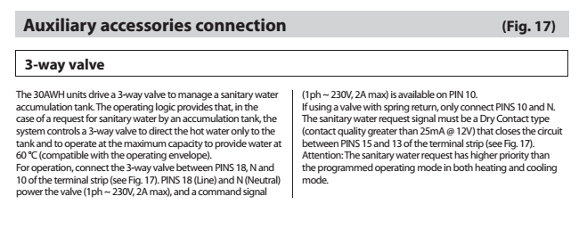

Jeremy Harris Posted November 2, 2018 Posted November 2, 2018 My understanding is that yes, it would normally be in the heating position and should move to the DHW position on command. I take it that you have the 3 port valve wired between N and terminal 10? Reading the manuals, the 3 port valve controls seem to be between terminal 18, terminal 10 and N. The description in the Carrier information shows that 18 (L) and N are the power supply to the valve, 10 (L) is the signal. Not sure what this means, but it might be an idea to disconnect the valve and stick a meter between N and terminal 10 and then N and terminal 18 to see what happens when the 3 port valve relay operates. The Kingspan GMC board will have been pre-programmed with a load of settings that don't seem to be clear from their documentation, but the Carrier Installation Manual (copy below in case you don't have it) has a bit more information at the top of page 11 that may help. 30awh004h Carrier ASHP Installation Manual.pdf

Jeremy Harris Posted November 2, 2018 Posted November 2, 2018 This is the section from the Carrier Installation Manual that references the three port valve connections:
PeterW Posted November 2, 2018 Posted November 2, 2018 Sounds like a programmed W Plan so that irrespective of programme, if DHW calls then it opens the valve. Seems to refer to the EU type valves that need power in both directions to open and close.
joe90 Posted November 2, 2018 Author Posted November 2, 2018 (edited) My wiring diagram shows no connection to 18 and Jeremy,s note above says “if three way valve has spring return do not use 18” mine is spring return hence no connection to 18 (I suppose). right, during testing with a multimeter the 3 way valve is no longer activated ? i have checked all the parameters (100 to 158) and noticed I can only set 113 (heat water set point) if 100 is set to 1 (fixed water temp value dry contacts) do they refer to dry contacts as remote room thermostat or tank stat?. I tried setting 100 to 4 as I want the command unit to act as room stat but if I do I cannot set the (113) water temp (113 simply not available). the GMC board is flashing “normal” but the ASHP will not kick in for heating (temp set high to force on in warm house) or DHW and I have drained all hot water and set tank stat high to call for heat. i have noticed that the “schedule activated” icon (23) on the command unit is flashing but there is nothing to say why?. Managed to get the ASHP to fire up and pump running by shorting 13 and 15 on the ASHP so appear to have a wiring problem within the house. Edited November 2, 2018 by joe90
