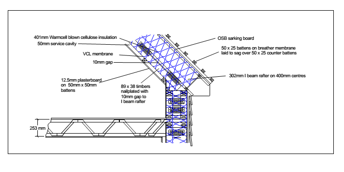

Russell griffiths Posted September 21, 2018 Author Posted September 21, 2018 Thanks for all the response guys @JSHarris would there be any chance of a cross section sketch or a. Photo I am wondering how the 10 mm gap was created also @Ed Davies any chance of a sketch or photo thanks guys.

Jeremy Harris Posted September 21, 2018 Posted September 21, 2018 Just now, Russell griffiths said: Thanks for all the response guys @JSHarris would there be any chance of a cross section sketch or a. Photo I am wondering how the 10 mm gap was created also @Ed Davies any chance of a sketch or photo thanks guys. Here's a cross section through our house, showing the detail: The gap was created when the rafters were put together in the factory, by nailplating a bit of timber to the lower member of the I beam with a small gap.
Russell griffiths Posted September 21, 2018 Author Posted September 21, 2018 They say a picture paints a 1000words thanks to you both @JSHarris @Ed Davies I owe you both a beer. ???
