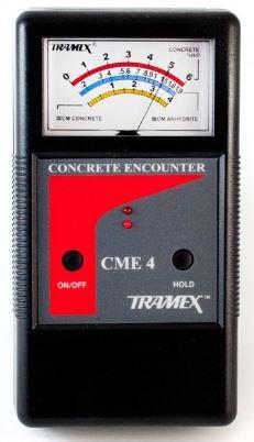

Ian Posted October 19, 2018 Posted October 19, 2018 (edited) @Jude1234 What method are you using to test the relative humidity levels in the screed? Edit - the reason for asking is that some of the commonly used test methods can be unreliable, particularly when the screed is calcium sulphate. If your builder has been testing using a Tramex CME meter (see photo) they can sometimes give false high readings. It would be worth checking using a different method. It doesnt sound like you have the time to get a hygrometer test done as they take 72 hours but you could get a calcium carbide test done quickly if you can find someone to do it for you. Edited October 19, 2018 by Ian 1

Jude1234 Posted October 19, 2018 Author Posted October 19, 2018 We have decided to delay laying of the floor rather than invalidating the guarantee and paying £600 for the DPM. Hopefully when the UFH is on and also the MVHR it will dry out. Currently value is 5.8% using a Tramex
Ian Posted October 19, 2018 Posted October 19, 2018 5 minutes ago, Jude1234 said: Currently value is 5.8% using a Tramex Just to re-state the point I made earlier: you can easily get a false positive reading from a Tramex meter, especially as they are calibrated for concrete and not calcium sulphate. It's worth getting a hygrometer or calcium carbide test done to double-check that the Tramex readings are correct. Using the Tramex the floor might be bone dry and your meter is telling you it's wet. 1
