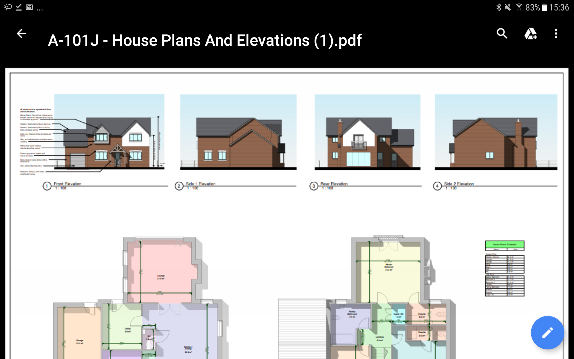

Boris Posted September 16, 2018 Posted September 16, 2018 Hi All, a little bit of tick infested Shropshire is now ours after waiting one year for the purchase to go through. We are doing a brick clad timber framed house on a serviced plot.
Tennentslager Posted September 16, 2018 Posted September 16, 2018 Welcome @Boris planning granted...did you design yourself or architect?
Triassic Posted September 16, 2018 Posted September 16, 2018 Welcome to the forum, I did wonder what you’d be doing post Brexit! plasecshare photos, we love photos !
Boris Posted September 16, 2018 Author Posted September 16, 2018 Tennantslarger,you are in my favourite place in the UK. We were up there 2 weeks ago. We used an architectural technician for the initial design, but the timber frame company have changed it a little, to suit their system. I'll find a pic, I would have wanted something more contemporary but I guess it has to be 'in sync' with the other 8 self builds.
Boris Posted September 16, 2018 Author Posted September 16, 2018 (edited) Triassic, it has changed, the ridge height is now a little higher and there is a 4th bedroom over the garage. Edited September 16, 2018 by Boris

Boris Posted September 16, 2018 Author Posted September 16, 2018 Russell Griffiths we have opted for bricks not slips. I'm a bit of a dinosaur so the thought of glue sticking and holding what will still be be a very heavy mass was a bit radical for me.
Russell griffiths Posted September 16, 2018 Posted September 16, 2018 Ok @Boris it was your wording clad, that made me think you where having brick slips
Russell griffiths Posted September 16, 2018 Posted September 16, 2018 @Dreadnaught i suppose my thoughts depend on how your slips will fix to the frame, i am not keen on anything fixed directly to the frame I would want to see a void to act as a drainage plain any moisture that finds its way to the back of the slips needs a void for it fall down and out my last house had an insulated frame, then an uninsulated cavity, then a block outer skin, then rendered we all have to make choices based on our thoughts and research, but I would rather have a system where I would be happy standing with a hose pointing directly at my external wall knowing if there is any moisture penetration then it has a path to escape. 1
