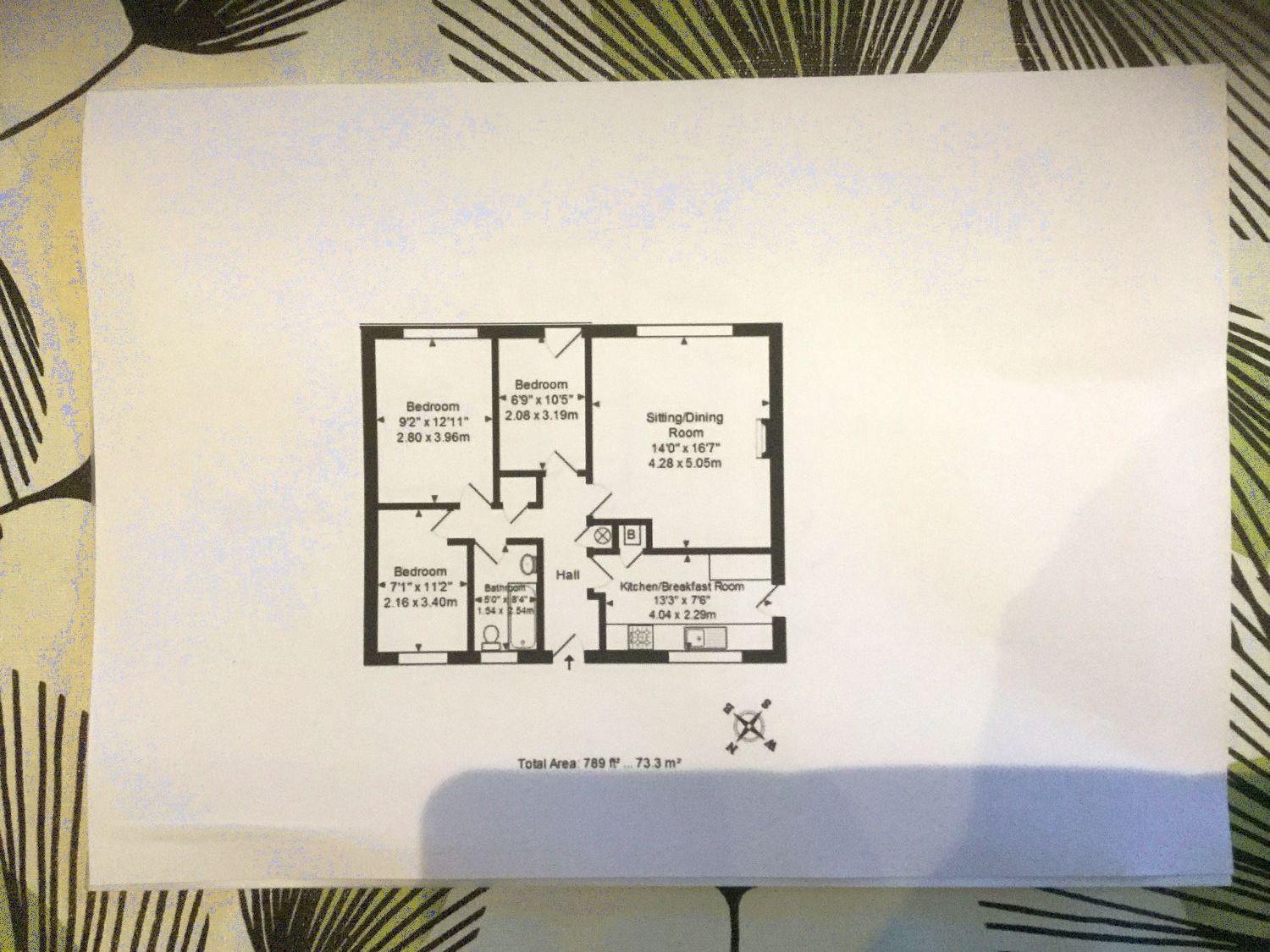

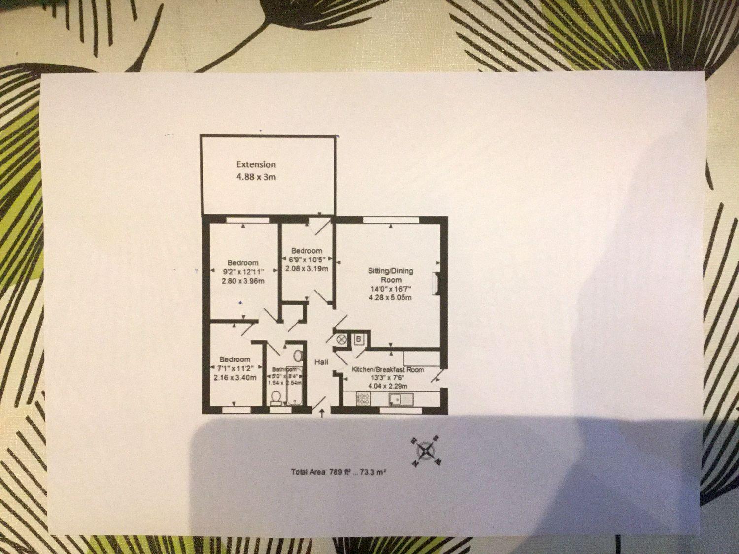

Me111 Posted September 16, 2018 Share Posted September 16, 2018 I am planning a single story extension to my 3 bed bungalow. The extension will be to the rear, 3 metres deep and the width of the two rear bedrooms. The lean to conservatory is almost falling down so that will go. My question is, what is the best way to make use of the extra space? The obvious, to me, thing it to make the two bedrooms longer, but my concern is that this may make them too long and thin? The drive is to the right of the bungalow, and the garage is at the end of the drive, set back about 3 metres behind the bungalow. We may look to add a conservatory off the back of the lounge (we've already taken out the lounge window and put in sliding doors) but don't want to lose access to the rear garden from the drive.All the internal walls are studs, but we've just re-done the kitchen and bathroom so not looking to change the layout too radically. We'd like an en-suite as we have 2 small boys, and plan on staying here for the foreseeable future.Any ideas gratefully received. Link to comment Share on other sites More sharing options...
ProDave Posted September 16, 2018 Share Posted September 16, 2018 That's an unusual layout in that the only access to the rear (and the old lean too) is through the small bedroom. Just making the 2 bedrooms longer is not going to achieve much. Can we have a plot layout? A side extension would make a lot more sense but I am guessing there is no room to do that? Link to comment Share on other sites More sharing options...

Me111 Posted September 16, 2018 Author Share Posted September 16, 2018 6 hours ago, ProDave said: That's an unusual layout in that the only access to the rear (and the old lean too) is through the small bedroom. Just making the 2 bedrooms longer is not going to achieve much. Can we have a plot layout? A side extension would make a lot more sense but I am guessing there is no room to do that? Most of the bungalows around here are like that, I presume that the middle bedroom was originally a dining room? I have attached a plot layout. The drive is to the right of the property and to the right of our drive is next doors drive, so going out the side is not an option. It's a semi-detached bungalow, so going left isn't possible either. There's a fair sized front garden, but no precedent of planning being granted to the front of any local properties. Link to comment Share on other sites More sharing options...
Me111 Posted September 16, 2018 Author Share Posted September 16, 2018 6 hours ago, ultramods said: As @ProDave has said, the proposed extension doesn't make much sense just now. What are you trying to achieve overall? Larger bedroom for the kids and an en-suite for our bedroom Are you extending simply to make 1 or 2 of the bedrooms bigger? Basically yes Are you wanting to add ensuites? Yes, to our bedroom Are you wanting the extension to allow you to resize any of the other rooms in the house? Not really Link to comment Share on other sites More sharing options...

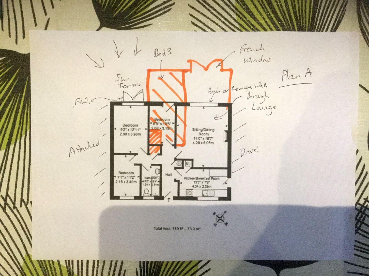

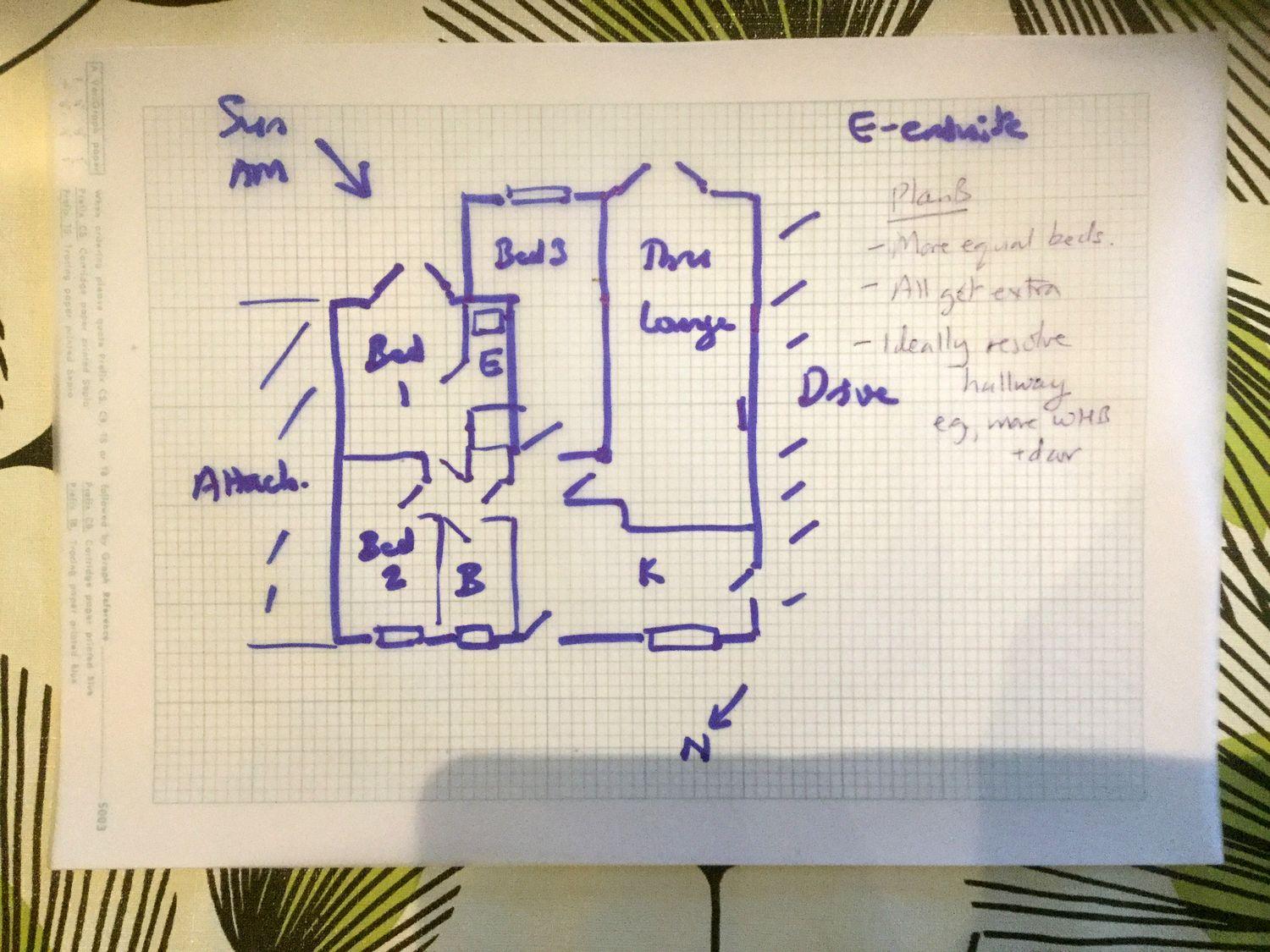

Ferdinand Posted September 17, 2018 Share Posted September 17, 2018 (edited) @Me111 A couple of quick ideas. By all means cherry-pick, as I have ignored at least one of your constraints. The main ideas are: Plan A 1 - Switch the extension so your extra space goes mainly to living, where all of you get to benefit. 2 - Through lounge. 3 - Morning sun terrace for existing master. 4 - Move walls to make middle bedroom a little less corridor like, and give space for an ensuite and wardrobe in the master, and potentially a desk and/or wardrobe where the lounge wall has moved on the way in, and a 3m x 3m sleeping/relaxing space at the end (I would do a desk and storage over, perhaps with a single wardrobe at the side). Plan B 5 - Where walls are moved, a the master in the back corner gets space for an ensuite. b the back bedroom gets part of the new extension and space where the wall has moved to have either a desk or wardrobe, as above. c the front bedroom gets space for storage plus a desk, similarly. I think that is a far better balance. Plan C I have not explored this properly, but if the WHB and door in the bathroom were swapped so the bathroom door was just inside the front door on the left, all of that confused maze of doors and hall cupboard could be in the front bedroom, with the corner master being entered via what is now the front part of the middle bedroom, and that would transform bedroom 3. And the kitchen wall could be addressed. Phasing This could all be phased over x years if finances require. At the start the whole extension could be done and demolish your current external wall last (I think) to give the new middle bedroom and lounge, so you do not end up living in a building site. Then do the bedroom changes as you are able. What you have now: What you have proposed: @Ferdinand Plan A: @Ferdinand Plan B: F Edited September 17, 2018 by Ferdinand Link to comment Share on other sites More sharing options...
Ferdinand Posted September 17, 2018 Share Posted September 17, 2018 Forgot to say, imo South facing conservatories are verging on madness not all they used to be cracked up to be - you get something that is too hot in summer, too cool in winter unless you invest £££ in heating, and very little extra on the value of your house. It is naturally usable for a time in spring and autumn. Witness all the companies offering to fix conservatories with various versions of real roofs for sums of £5k to £10k Put the conservatory budget into a real room extension with real insulation, and you will get something usable in 4 seasons, and which adds value. Or go with a shaded terrace at 10-20% of the cost. Ferdinand Link to comment Share on other sites More sharing options...
