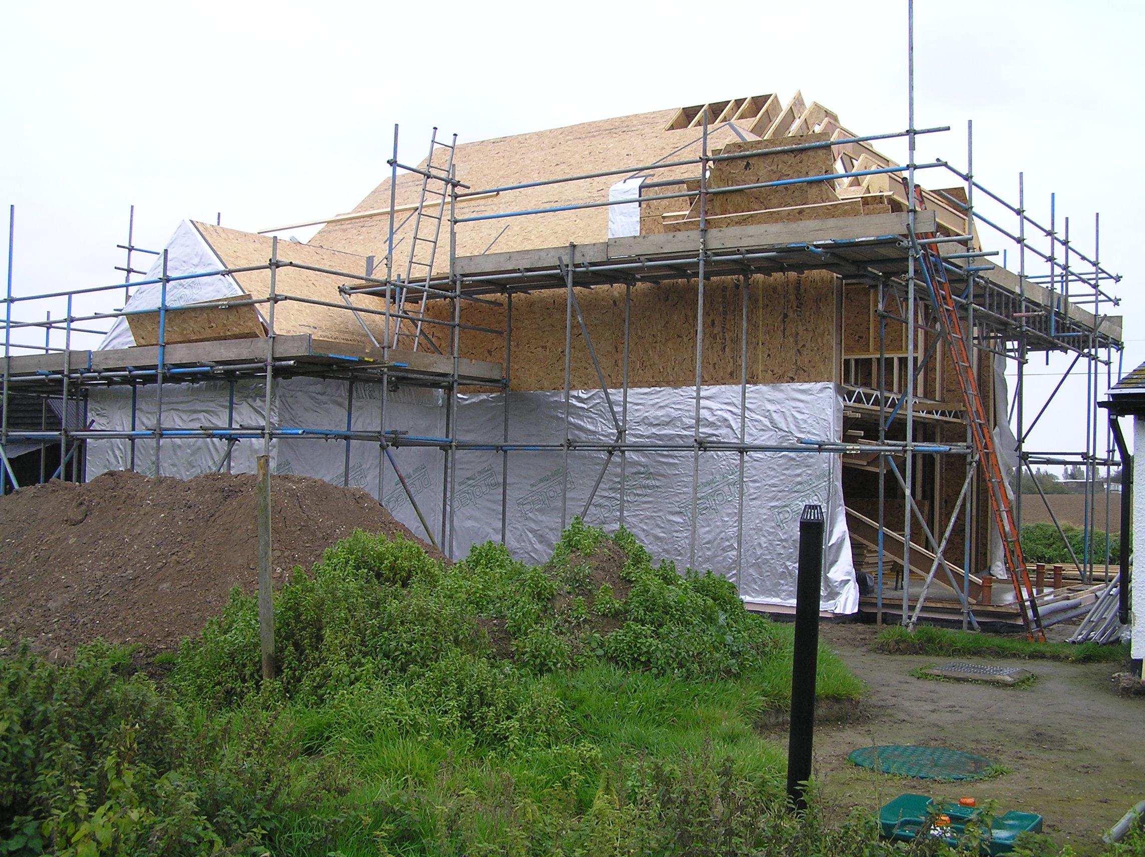

Triassic Posted September 12, 2018 Posted September 12, 2018 (edited) I’m ringing round for quotes for the scaffolding for my TF new build. I’ve tried to read up on scaffolding and any traps or scams I need to be aware of? This got me wondering is there a checklist anywhere? Ive just measured around the outside perimeter and it’s 81m, that sounds like I’ll need a lot of scafffolding! Edited September 12, 2018 by Triassic

Gary G Posted September 12, 2018 Posted September 12, 2018 Scaffolding for my timber frame build came in at £5000- 2400sq ft 4 bed detached with detached garage- Bedfordshire. Quotes varied hugely!

Triassic Posted September 13, 2018 Author Posted September 13, 2018 I’ve had the first of the local scaffolding companies visit the site to take photos and measure up. Apparently the build willneed a complicated scaffold as the house is L shaped and has a number of different roof heights. I'm expecting this quote to be high.
Gone West Posted September 13, 2018 Posted September 13, 2018 3 hours ago, Triassic said: Apparently the build willneed a complicated scaffold as the house is L shaped and has a number of different roof heights. Our's was L shaped and had single storey and double storey parts. It takes them only a little longer to go around the L so it shouldn't be too high a quote.
Tyke2 Posted September 13, 2018 Posted September 13, 2018 Corners are really difficult and cost lots. Ask any bricklayer!!
