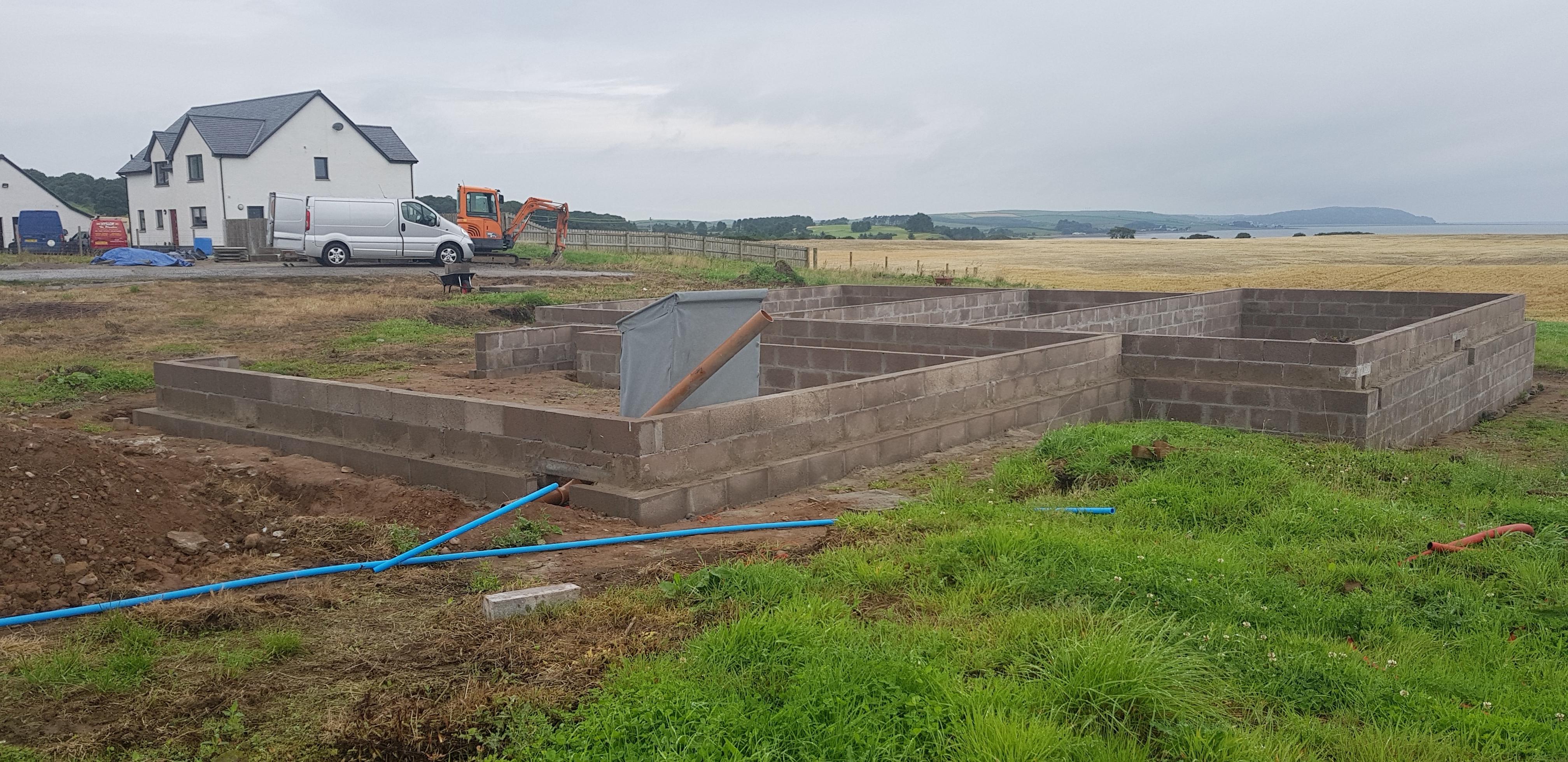

vfrdave Posted August 28, 2018 Posted August 28, 2018 I have got my electric connection in ie the cable has been run and terminated in my Permali box after some harsh words with Morrows on a Friday afternoon. Spoke to electrician this morning about the connection card and he said that he doesnt fill that in until after 2nd fix. Can I therefore not get a site supply in place now to work from until proper connection is done?

ProDave Posted August 28, 2018 Posted August 28, 2018 What is this "connection card" you talk about? Id the supply is lve and a meter is installed, there is nothing stopping the electrician connecting a CU and site supply socket, remembering to use a TT earth, not the TNC-S that is probably supplied. If the DNO want to be a PITA he can issue an EIC for that CU and 1 socket, and issue another EIC leter when the house is complete.

ProDave Posted August 28, 2018 Posted August 28, 2018 48 minutes ago, vfrdave said: One of these http://www.nienetworks.co.uk/documents/connections/nie_connection_card.aspx I already have a generator thankfully, just thought I could have got a connection made in the permali box. is this a spike? Not that easy in rock surely. Okay a different way of doing things over there. You electrician just needs to fill that in. It sounds like he has to install his CU, test it and then submit the form and they will come and connect it. Best he issues an EIC for the install as well.

epsilonGreedy Posted August 28, 2018 Posted August 28, 2018 (edited) English regs might be different but my self builder neighbour has a temp connection housed in something that looks like a large postbox on stilts. The box is near the site boundary hedge similar to the temp builders water supply standpipe and inside there is a small consumer unit with a couple of RCDs. From this box he has a shallow conduit and mains cable running 15m to his static caravan. As my build is further advanced I am taking another approach. I am digging a mains supply conduit trench right up to the utility room foundation next to where the meter will be sited in the wall. My builder's electric supply will be in a temp housing next to the utility room but there will be enough spare supply cable left to route the supply cable into the long term meter box once the house has a roof on. Edited August 28, 2018 by epsilonGreedy
ProDave Posted August 28, 2018 Posted August 28, 2018 50 minutes ago, Ed Davies said: Why's this not like having a house with a couple of outside sockets? Just a rather small house. There are specific rules about caravans and site sockets in the wiring regs that prohibit them being connected to a TNC-S earth. The danger with TNC-S is there is a combined neutral and earth. In the event of a neutral fault (not as uncommon as you might think) the combined neutral and earth can rise to near L potential. That is BAD news if you are standing on the ground and reach out and touch the earthed metal door handle. 1
