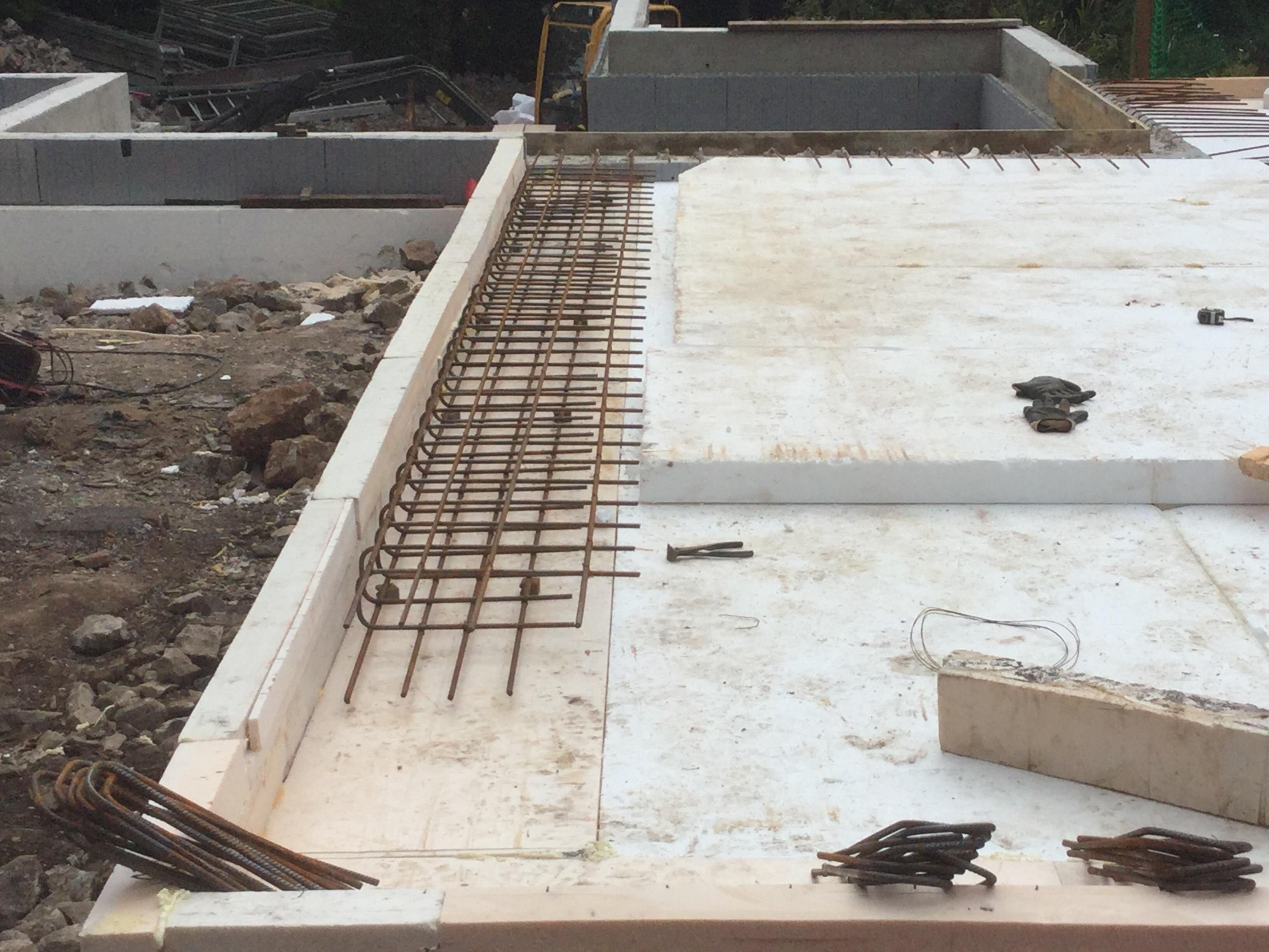

Triassic Posted August 7, 2018 Posted August 7, 2018 (edited) 1 hour ago, Alexphd1 said: Our took slightly longer than 4 days but was a DIY effort (got in a company to pour the concrete). I’m one of those DIY insulated raft installers, like @Alexphd1, I got a local guy in to help pour the concrete. This is is what I’m doing this morning, tying the steel work ready for the next concrete pour. Edited August 7, 2018 by Triassic 2
Alexphd1 Posted August 7, 2018 Posted August 7, 2018 @Triassic That picture looks very similar to our next build. 3 sided icf basement with bigger raft footprint area on 1st floor. 1

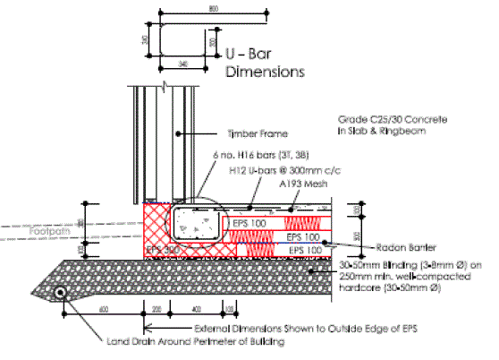

jack Posted August 7, 2018 Posted August 7, 2018 Bear in mind that there's a big difference between a timber frame and a brick/block with cavity on a raft. Brick and blockwork adds a lot of weight, so the slab needs to be engineered accordingly. Do you have a construction type (eg, timber frame, ICF, blockwork, etc) in mind yet? Here's a section through the raft we have (which is the same as Jeremy's):

deuce22 Posted August 7, 2018 Author Posted August 7, 2018 I have always used a double block construction when building extensions and the 2 new builds I've done, so I don't have experience in other types of construction. A friend built his with a 6x2 frame, covered with 100mm fibre board and then cladding. I am really interested in this because it takes away a large amount of work for bricklayers (which is something I don't do). I'd be able to do all of that myself with a labourer. I just don't know if it would be approved by planning because the SE said the planners still prefer traditional builds. Jack. I'm assuming that your construction is similar to a traditional build with a cavity between walls, but timber used instead of brick/block. How does it work at the bottom where you'd normally have a cavity tray for moisture, either building up inside the cavity or coming through the outer leaf? Thanks.
jack Posted August 7, 2018 Posted August 7, 2018 The equivalent of the brick/ block "cavity" is actually the ventilated space between the outer stud and the cladding or render board.
deuce22 Posted August 7, 2018 Author Posted August 7, 2018 The cladding or render board has to be fitted to something though, so surely there's not just a complete gap between the cladding and the outer stud? How does the cladding get fitted, so it is not bridging to the outer stud?
jack Posted August 7, 2018 Posted August 7, 2018 Vertical battens, which fix through the outer board (of the outer stud) and into the outer stud.
