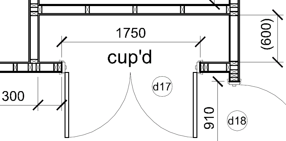

jack Posted July 29, 2018 Posted July 29, 2018 Morning all Taking a break from balconies due to the weather, and looking at getting some other jobs done. We have a linen press on our upstairs landing that presently has no internal shelving. It's quite big, so there's lots of shelving needed: I have a rough idea of what the layout looks like - we need some smaller shelves for linen, some bigger ones for boxes, and one tall area for a vacuum cleaner. I'm interested in how best to construct these shelves. I was thinking about using battens on the walls to support the outer edges of the shelves, but given how wide this is, I'll need at least one central support as well. I was therefore thinking something like a central post (bottom of the "p" in "cup'd above", with horizontals going back to the rear wall. Is there an easier way? I'd also like to use slats rather than solid shelves. Any suggestions for what sort of wood and where to buy? Oak or another hardwood would be nice, but given how much I need that could be an expensive exercise for something that's largely out of sight. Obviously where sheets and towels are involved, the wood will need to be non-staining. Lacquer will help with that, but again, any particular suggestions for particular finishes? Thanks as always.

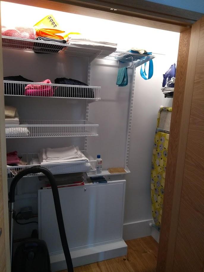

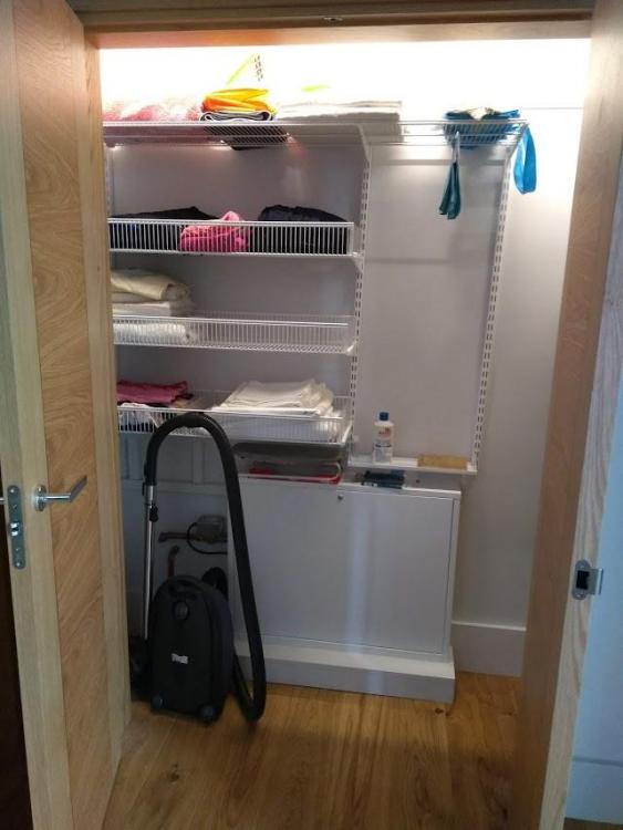

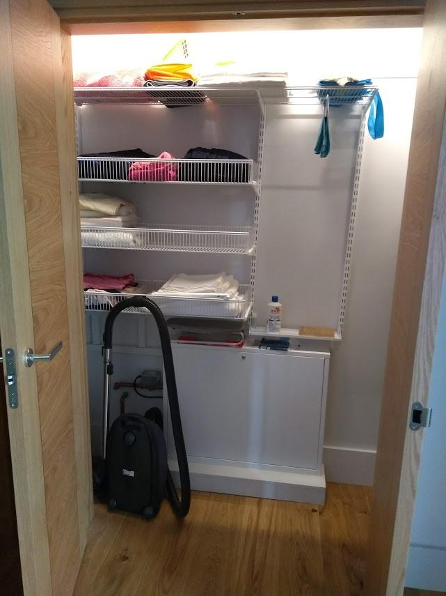

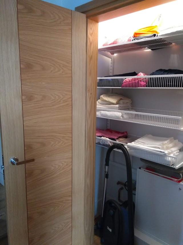

jack Posted August 6, 2018 Author Posted August 6, 2018 Thanks all. Did a bit of research and went with the Elfa system in the end (thanks @HerbJ). A major factor was time - much as I'd love to have built this as a project, realistically, there's a lot of other more important stuff that needs doing, and work is completely flat out at the moment. In the end, convenience trumped everything else. It arrived on Friday, and was installed in no time. Not cheap, but clearly well made and should last a long time. I also like the fact that it'll be easy to reconfigure as needed. I'm so happy that I'll be acquiring some more to do the wardrobe in the guest room. As a bonus, I can install it now and we can use it for storage, despite the fact the the wardrobe hasn't actually been built yet!
