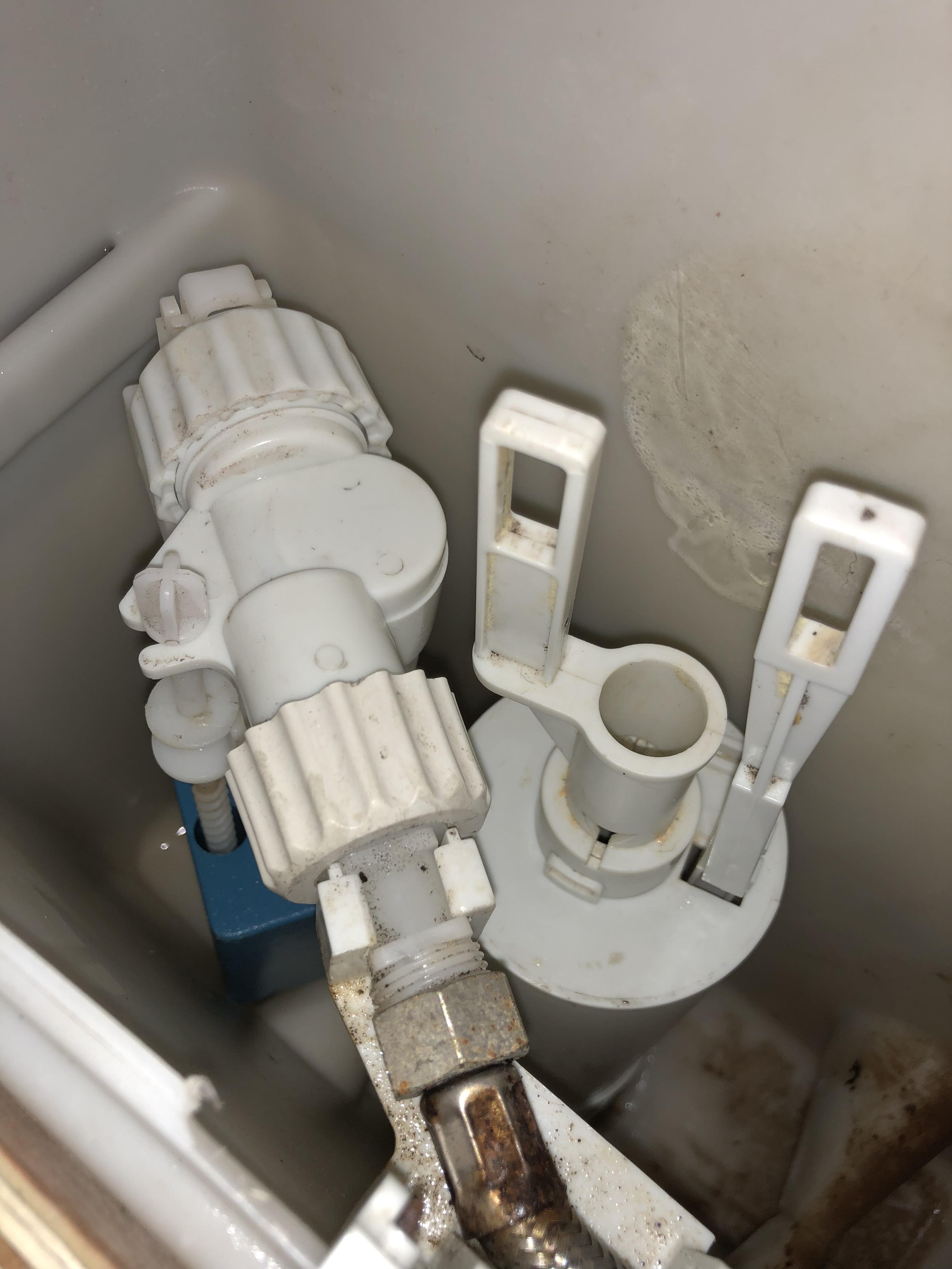

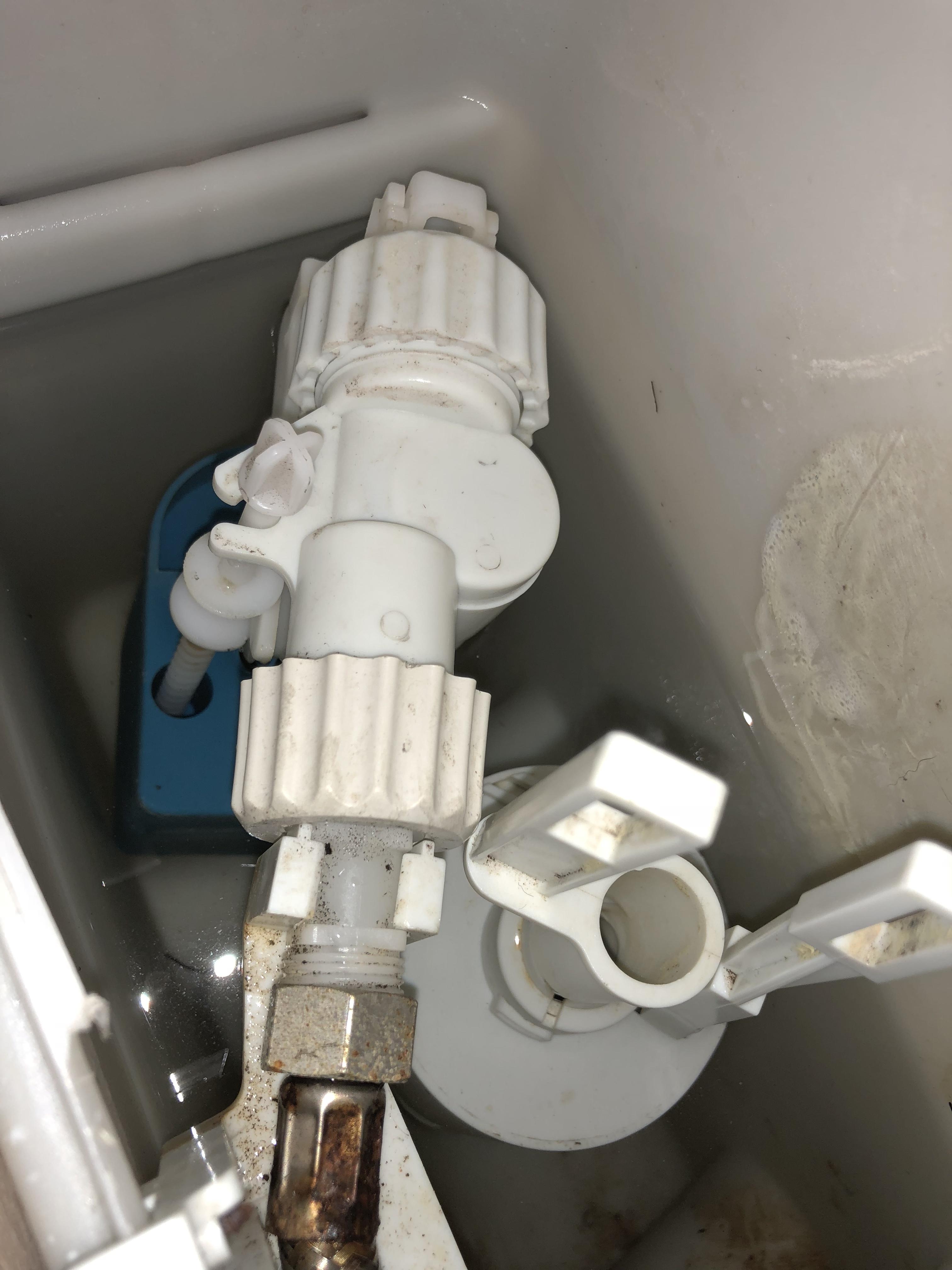

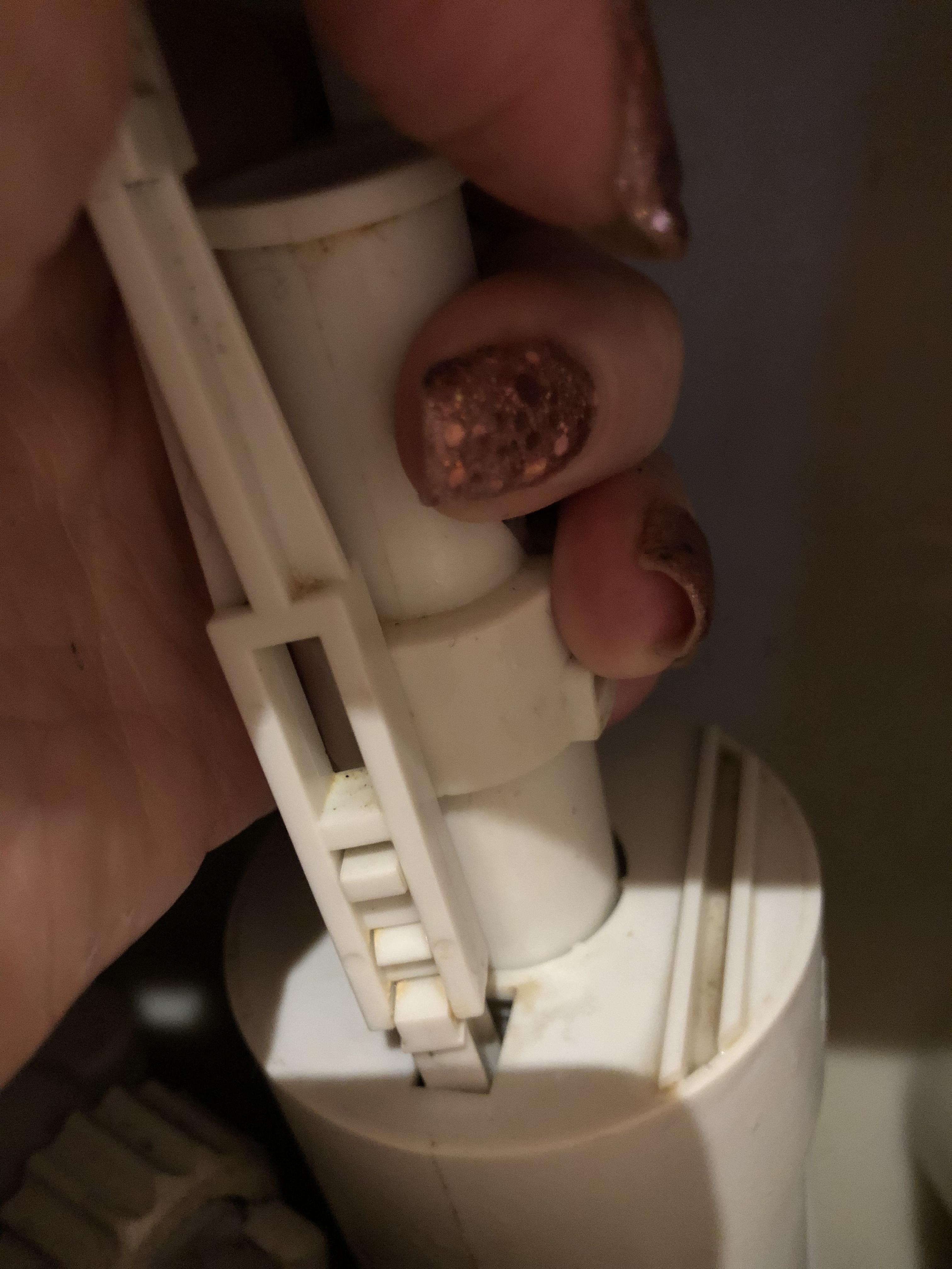

newhome Posted July 20, 2018 Author Posted July 20, 2018 So the small bit definitely unclips I reckon as there are slots in it, but I need to unclip the larger bit first. Any ideas how? If the German guy in the Gerberit video says it’s easy to unclip one more time ?. Yeah easy for you to say mate! ?

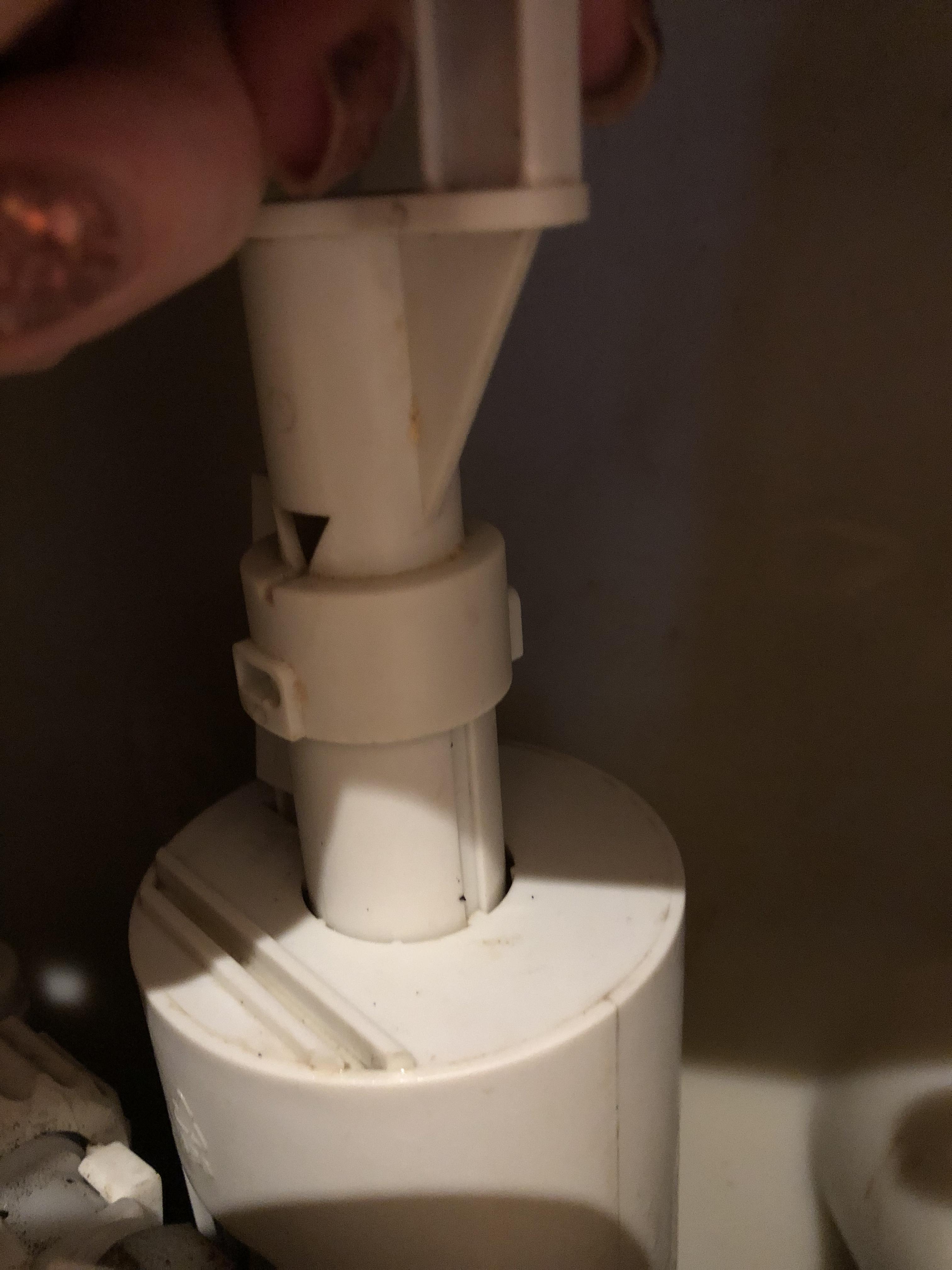

newhome Posted July 20, 2018 Author Posted July 20, 2018 (edited) Well plumbing’s off the list if I ever fancy a career change ?. Maybe that bit only comes out if you remove the other bit first? Can’t see how you have enough room in there to turn the thing without either it unclipping somehow or the other bit being removed. Edited July 20, 2018 by newhome

PeterW Posted July 20, 2018 Posted July 20, 2018 38 minutes ago, newhome said: Well plumbing’s off the list if I ever fancy a career change ?. Maybe that bit only comes out if you remove the other bit first? Can’t see how you have enough room in there to turn the thing without either it unclipping somehow or the other bit being removed. Can you let it fill and take that photo again..? Just don’t drop the phone in the cistern.....

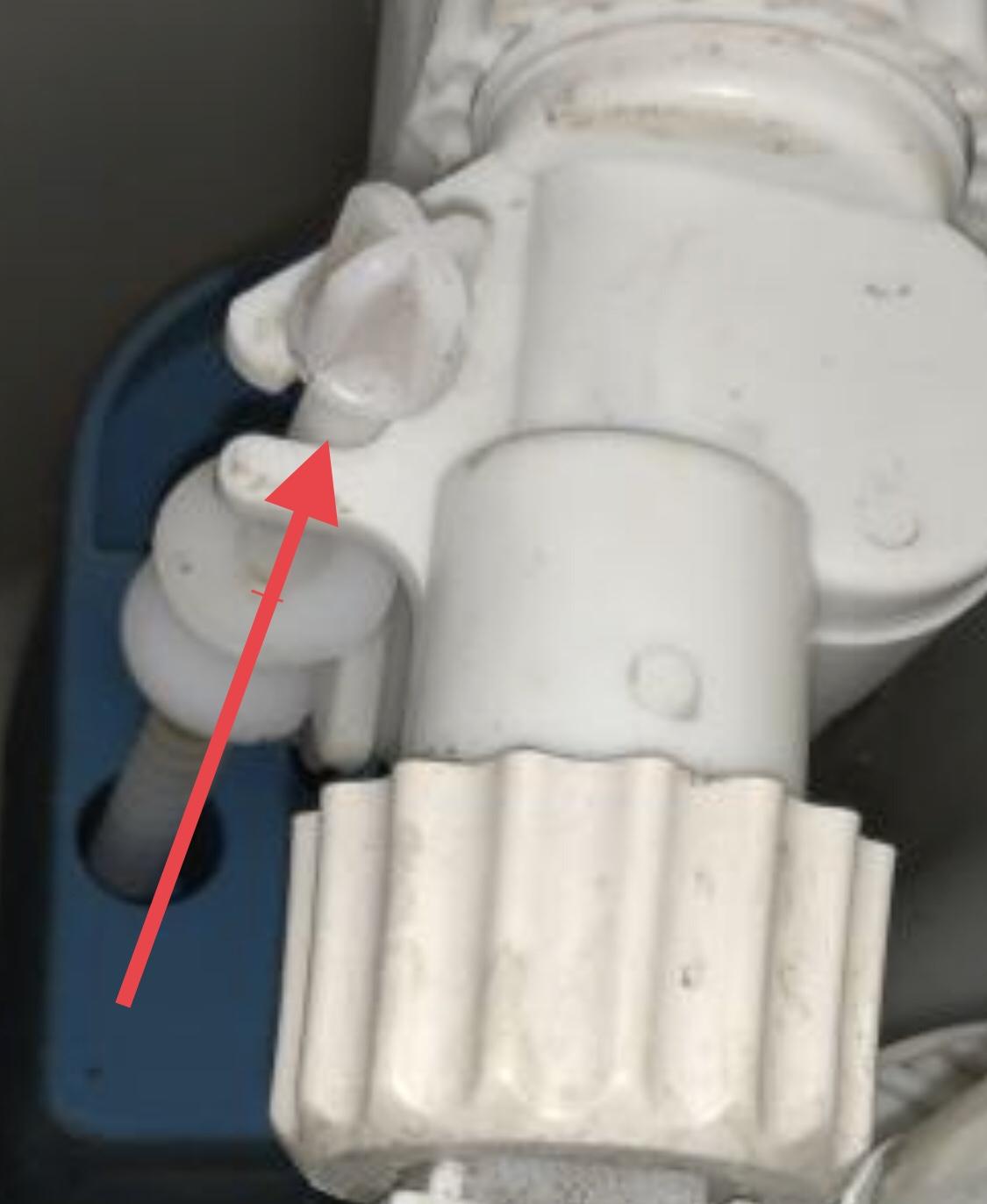

PeterW Posted July 20, 2018 Posted July 20, 2018 I think the water level is too high and it’s going though the hole at the front. Can you drop the blue float down a bit more ..?
newhome Posted July 20, 2018 Author Posted July 20, 2018 3 minutes ago, PeterW said: I think the water level is too high and it’s going though the hole at the front. Can you drop the blue float down a bit more ..? So I twist this bit higher or lower? Will it come out if it unscrews too much? I had to turn the water off as it showed no sign of stopping but don’t forget that the flush thing is now loose in there since I unscrewed it.

PeterW Posted July 20, 2018 Posted July 20, 2018 Screw the big valve back in... turn the arrowed thing so the blue float goes down. And no, won’t come off 1
