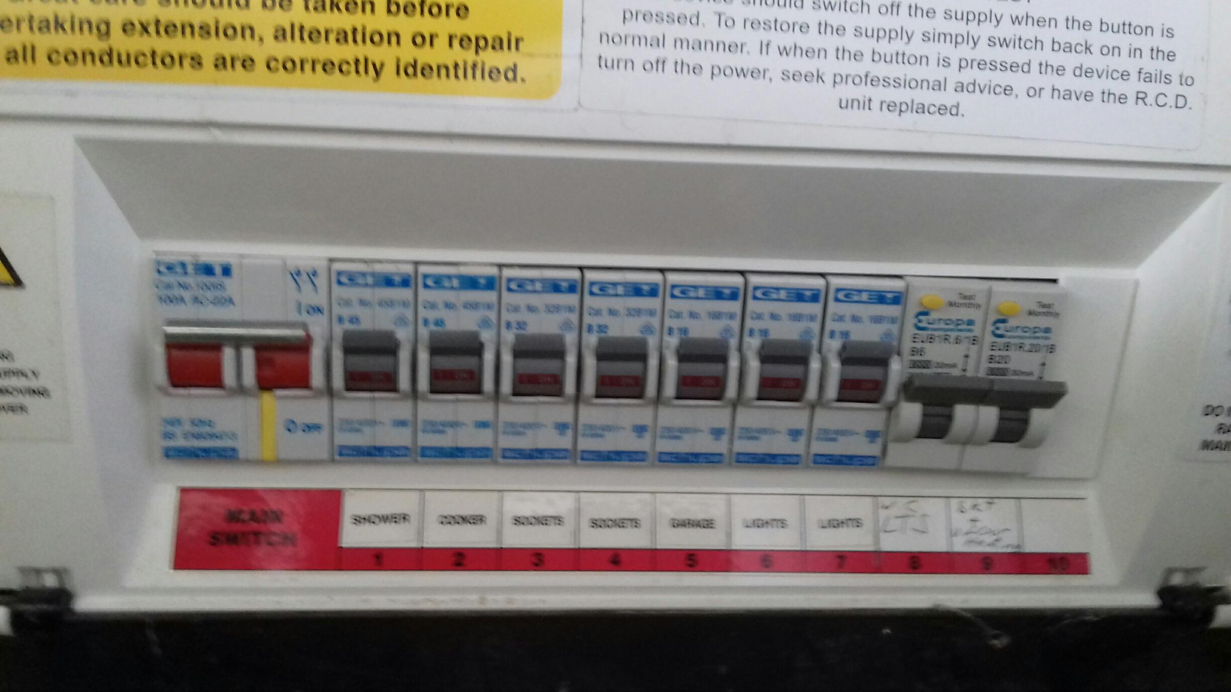

Hecateh Posted July 18, 2018 Share Posted July 18, 2018 Where is this RCD supposed to be. I can't see anything with a red button. The board was fitted in 2000 and has a note on it (as described by @JSHarris) about checking the RCD but there is nothing between the meter and it or between it and where the cable disappears Link to comment Share on other sites More sharing options...
Jeremy Harris Posted July 18, 2018 Author Share Posted July 18, 2018 2 minutes ago, Hecateh said: Where is this RCD supposed to be. I can't see anything with a red button. The board was fitted in 2000 and has a note on it (as described by @JSHarris) about checking the RCD but there is nothing between the meter and it or between it and where the cable disappears Should be in the CU itself, look for a double width module(s) with a button marked "push to test" or similar. When you push it the RCD should trip and turn off the power to anything fed from it. Some newer CUs will have two RCDs, one for each half of the system, so if one trips on a fault the other half of the house still has power. Link to comment Share on other sites More sharing options...
Hecateh Posted July 18, 2018 Share Posted July 18, 2018 Found it, sort of, I was looking for red for some reason and it's yellow There are 2 but one covers the bathroom lights and one covers the underfloor heating. Nothing else is protected. Link to comment Share on other sites More sharing options...
Jeremy Harris Posted July 18, 2018 Author Share Posted July 18, 2018 That's a pre-17th Ed of the regs CU that's had two RCBOs fitted for the additional circuits on the right, by the look of things. Looks like the wiring has been modified post-installation and probably post-2008, when the 17th ed of the regs was introduced, as that introduced the requirement for RCD protection. The abbreviations are: RCD Residual Current Device - a device that detects if the current flowing in the line and neutral are out of balance, indicating that a fault current may be flowing to earth, and which switches off the circuit when this happens. In practice this means that if there is a fault where part of appliance becomes accidentally live, due to a fault, then a very short time after someone gets an electric shock from it (typically 20 to 30ms, or thousandths of a second) the power will be cut so preventing electrocution. RCBO is the same thing but with the addition of a miniature circuit breaker in the same unit, so it will trip both of an earth fault current or a current overload. RCDs are also called GFIs (Ground Fault Interrupters) in some countries - same device, different name. Link to comment Share on other sites More sharing options...
dpmiller Posted July 18, 2018 Share Posted July 18, 2018 (edited) so it's the wee yellow buttons you need to press to test them, yes . Edited July 18, 2018 by dpmiller Link to comment Share on other sites More sharing options...
Onoff Posted July 18, 2018 Share Posted July 18, 2018 @Hecateh, looks like your older board has been modded to add two RCBOs - the B6 and B20 on the far right with the yellow test buttons. From the left you have the red isolator, that's just a switch. The red things are circuit breakers, a modern "fuse" if you like that should trip in the event of an over current or short circuit. The benefit being you can reset once the fault is fixed whereas a fuse would blow or need rewiring. You do not have any RCDs per se in that board. What you have is the two RCBOs, Residual Current Breakers with Overload. These combine the attributes of a circuit breaker with that of an RCD. They're good in that they protect just that circuit. If there's a fault then only that circuit is affected. In a perfect world every circuit would be on it's own RCBO. No excuse not to on a new build tbh. Link to comment Share on other sites More sharing options...
Hecateh Posted July 18, 2018 Share Posted July 18, 2018 Yes the 2 on the right were fitted later, about 2010 if I remember rightly, One is the fan and lighting for the bathroom and the second is the electric UFH in there. The house had a total rewire in 2000 when I moved in because there were still brown bakelite light switches and round pin sockets lol (and only one of them in each room) Link to comment Share on other sites More sharing options...
