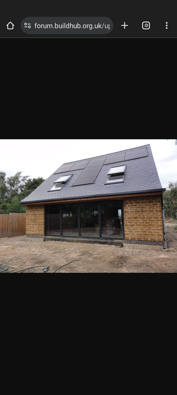

Moira Niedzwiecka Posted July 19, 2018 Share Posted July 19, 2018 @Vijay I used ARP from Leicester. Really helpful. Provided a sample & came out to measure up & spec. They do all different types if you need a different look. It was very expensive but worth it. We used some of the budget we have saved on buying ex display for the interior. @Ed_MK There is a 50mm cavity between the timber frame & the stonework. There is a DPC 150mm above the level of the blue bricks that slopes to form a cavity tray with weep holes where the stonework meets the blues. The external ground level will be up to the top of the first course of blues. Not sure if this is what you asked or if I have explained it very well. Link to comment Share on other sites More sharing options...
Ed_MK Posted July 19, 2018 Author Share Posted July 19, 2018 YES IT DOES THANKS Link to comment Share on other sites More sharing options...
