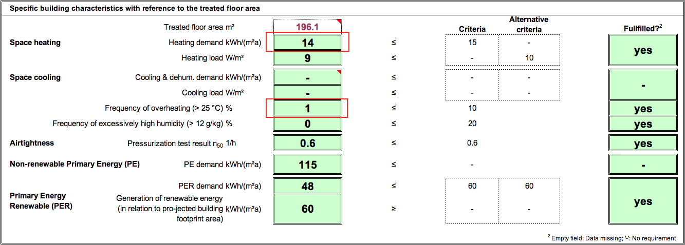

Hi Dreadnaught.
So as not to drift the thread too much from the 'house cooling ideas' I thought I'd message you directly. Are you doing the PHPP yourself and if so, how are you getting on?
My first dealing with PHPP was with an 'expert' who was a complete clown so I bought my own copy of the PHPP and started entering the data myself  - and, if I'm honest, I've been struggling with elements of it.
After a while I went to see another 'expert' who agreed to review my attempt, he was definitely much much better but he'd still missed some school boy errors that I'd made, which I discovered after learning stuff from my meeting with him. Also he was going into minutiae that I hadn't for one moment considered. For example, the timber frame company we will most likely go with use nail plates to join elements of the timber frame, his modelling of this in the PHPP proved that the claimed U value was incorrect (if you factored in the amount of timber in the walls and the metal nail plates), so I've taken that on board in my PHPP but not even started on the roof construction!

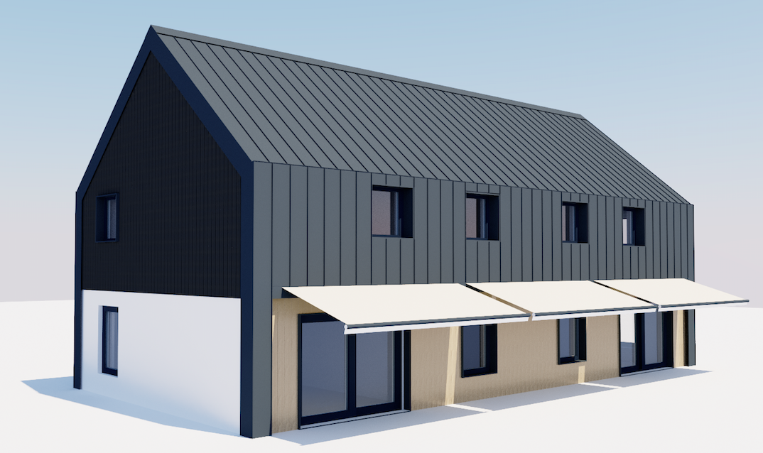

Despite that I've managed to get my overheating down to zero using awnings on the southern elevation of our planned house, but I wonder, have I?  What else have  I missed...

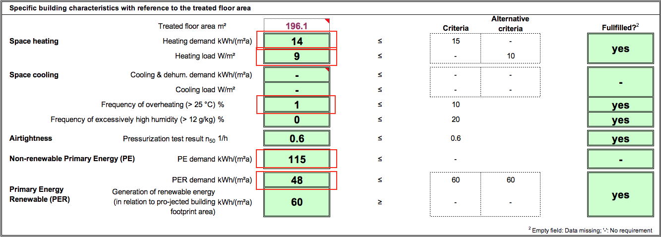

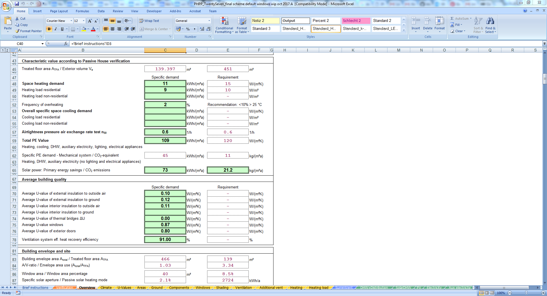

Not sure what you mean by the key parameters but page 1 looks like this:
Have some changes to make as  the foundation now has more concrete and less insulation in a few places and this one is based on generic windows which, when the final choice is entered, push things a bit the wrong way as well but we have a margin and the front and rear elevations now have more insulation than this model by 20mm or PIR so that will help a bit in the right direction. Overheating here looks OK but this is very optimistic and I think we will exceed this if we are not careful - putting the ASHP into cooling mode also pushes things the wrong way. PHPP is a balancing act where you trade off things all over the place to reach an optimal setup - like finding the, or a reasonable, maxima in a multidimension regression (type) exercise.

Posted
From the numbers, that looks like a very nice balanced build, @MikeSharp01. What is the form factor? I am guessing close to 2.5.

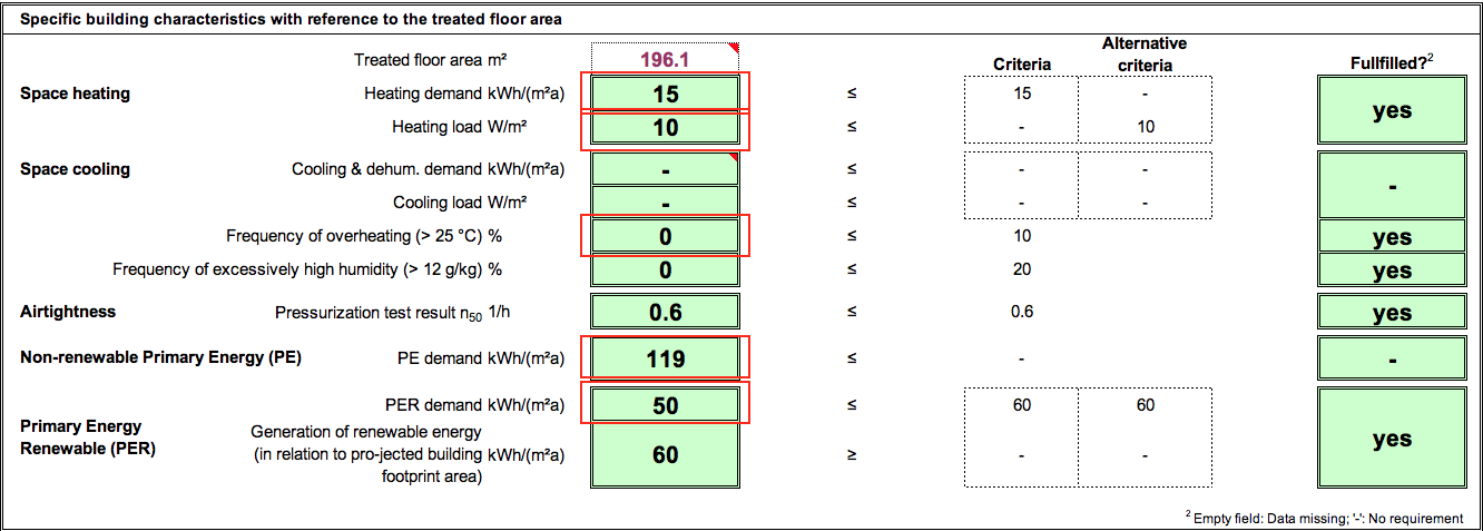

The thing is Mike, mine looked like that (without any shading) but I'd made a mistake in the data, which wasn't spotted by my second PHPP expert (and his credentials put him right up there - expert that is), and when I corrected my error it was 10% 'frequency of overheating'.
I'd always planned on shading for the SE and SW elevations because I reckoned it would need that by just 'eyeballing' it. After fixing my error and putting the shading back in I'm down to 0% overheating.
I think.
That's what my PHPP says at the moment anyway.

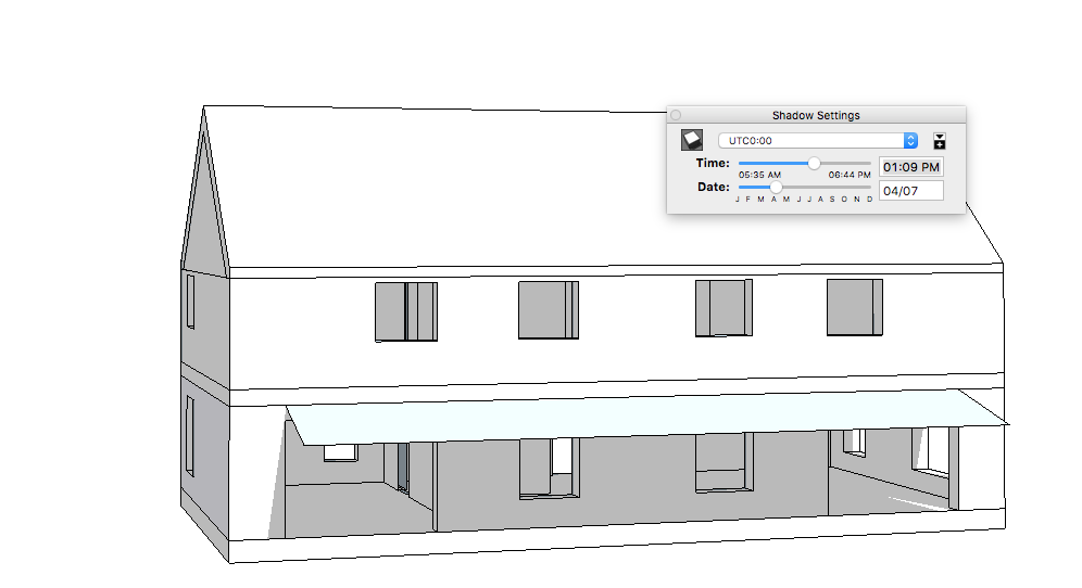

I've loved and loathed messing with the PHPP in equal measure. My geo-located Sketchup model has probably guided me more than the PHPP as you can produce the sun/shadows for any time of the year/day and it really reinforces that gut feeling.
It's around 190m2 and may look something like this.

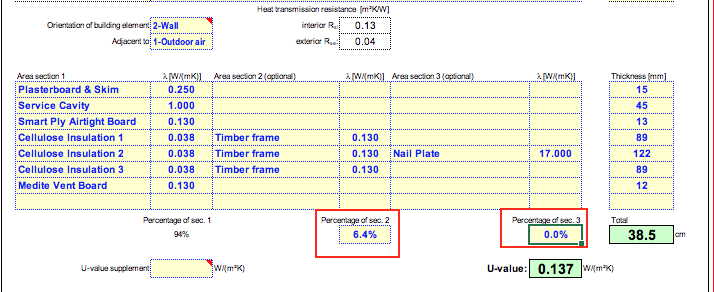

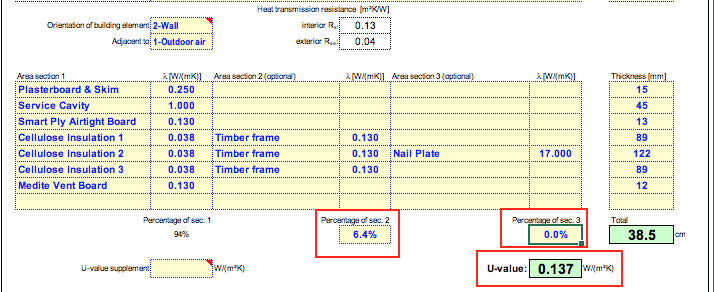

Posted

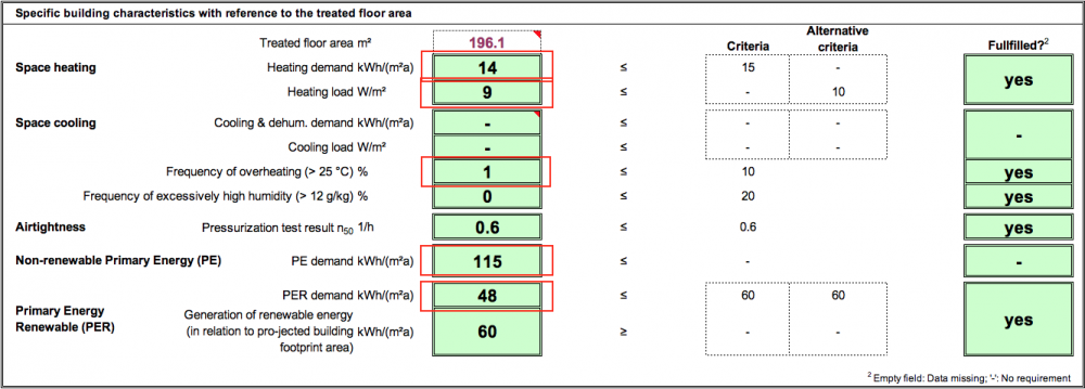

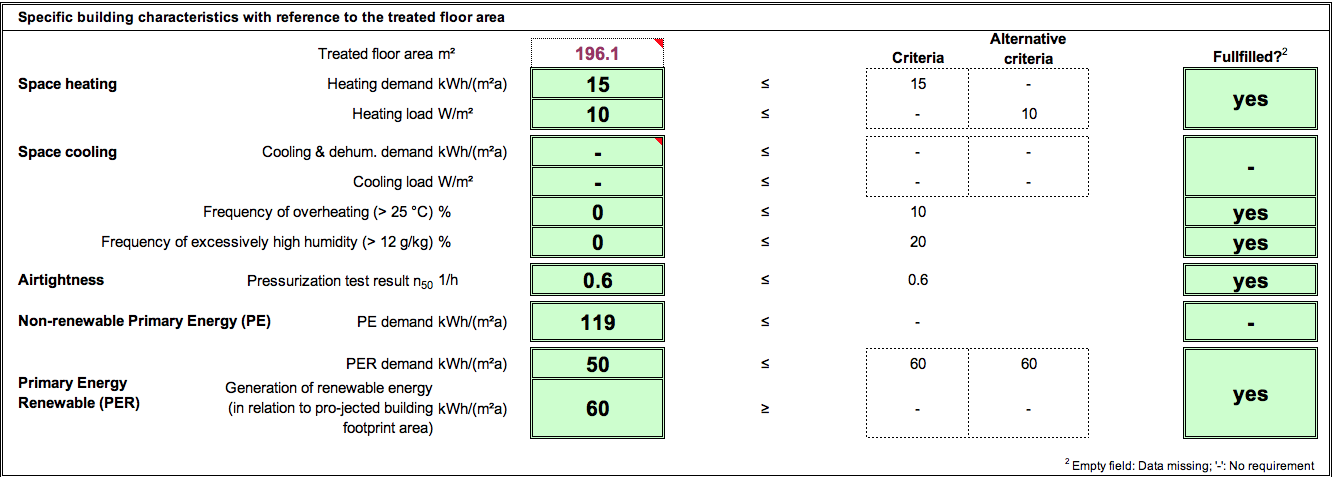

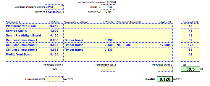

We're planning to use the same timber frame as @JSHarris (and many others) and if I enter the wall construction into PHPP with a U value of 0.12 I get this:
493651017_ScreenShot2018-07-12at08_43_20.png.a509435cb864e6ce55be3994b96b712a.png1184696303_ScreenShot2018-07-12at08_38_20.thumb.png.c40ad31e5884b199ad6c94ad9bda3740.png
If I then add the % of timber frame (6.4%) and nail plates (0.016%) in the wall (as explained to me by a PHPP expert) it changes the U value a fair amount and pretty much everything else on the verification page:
107687439_ScreenShot2018-07-12at08_37_53.thumb.png.0ad550ea5ef66aa76cfd29f9e65a86ca.png
The difference between those 2 verification screen shots is purely down to the 6.4% timber frame in the wall construction and the 0.016% of metal nail plates, I find it quite amazing the changes that produces and, as I said earlier, I've not even started on modelling the roof construction into it's component parts.
Has anyone else modelled a timber frame wall construction in such fine detail?
Is this going over the top or a useful exercise?
Posted
I modelled our cellulose filled twin wall from first principles and ended up with an overall U value of 0.121974 W/m².  That included allowing for the joining studs and nail plates, plus the service void air gap, plasterboard, outer board, cladding etc.

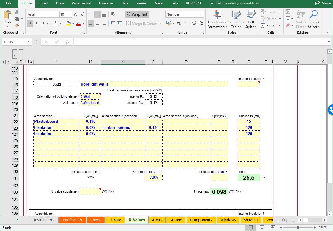

I bought PHPP and have used it quiet a bit but never went as far as getting a house certified. I've also never took any course but read the manual a few times in detail. The person in our office who took the course a number of years ago hasn't a clue and never uses it.They wouldn't claim to be able to use it either.
PHPP is a lot of work and it takes a lot of time to input everything. It's really interesting to see little things you modify change the final results. I've also downloaded Therm and modeled the thermal bridges at floor and wall junctions, eaves, etc and incorporated them. The more time and effort you put in the more accurate the output.
I always model the timber supports or nail plates wherever they are. It makes a massive difference always. This screenshot is off the sun tunnells from the rooflights to the ceiling.

Posted
Expand
@JSHarris I've no doubt that is accurate, and much different to the figure I've achieved in my PHPP. Can you see any glaring errors in the data I've put in to my spread sheet that has resulted in my U value of 0.137?
Posted
Our build up uses different materials, but I allowed for the exact number of noggin/nailplates between each of the two timber frames, the 89 x 38mm timber frame elements and the number of them in total, the OSB outer skin, the Durelis inner skin/VCL, the 45mm service void, 12.5mm plasterboard, 3mm plaster skim and externally the 50mm x 25mm cladding battens, air gap and the larch cladding.
I then worked out the average U value for the whole area of the external walls.  Things to watch out for are the exact number of noggins/nailplates per unit area and the fact that the nailplates have a lot of voids (more voids than metal) so cannot be modelled as if they were solid plates.  Somewhere I have an AutoCad drawing of a nailplate that I used to work out the effective CSA, as it's a fair bit less than the apparent CSA.
