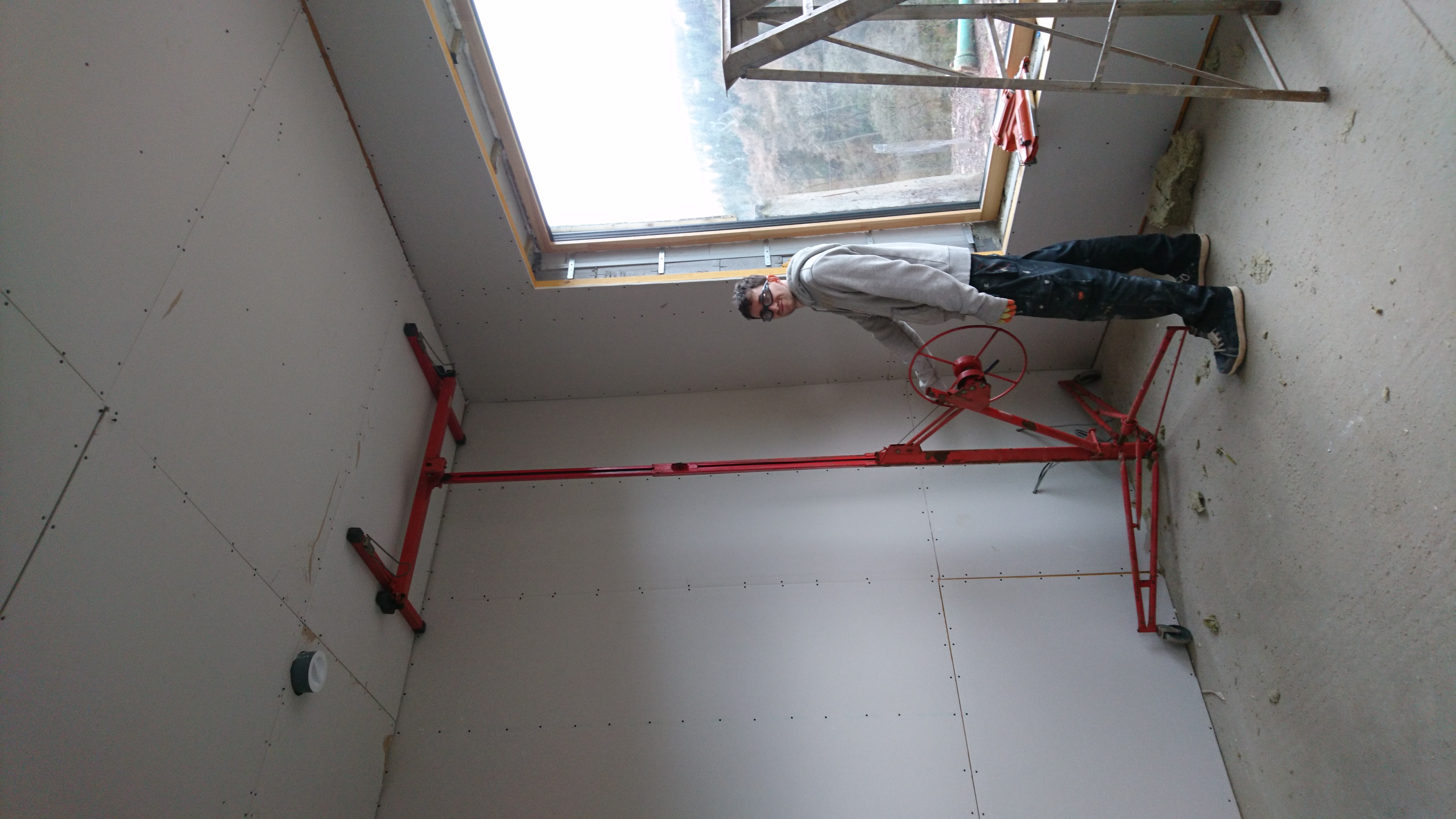

1 hour ago, Ferdinand said:
Perhaps £100 give or take for a board lifter. Available everywhere.
The one I borrowed can only be used vertically. Is yours the deluxe model?
  • Haha 2
