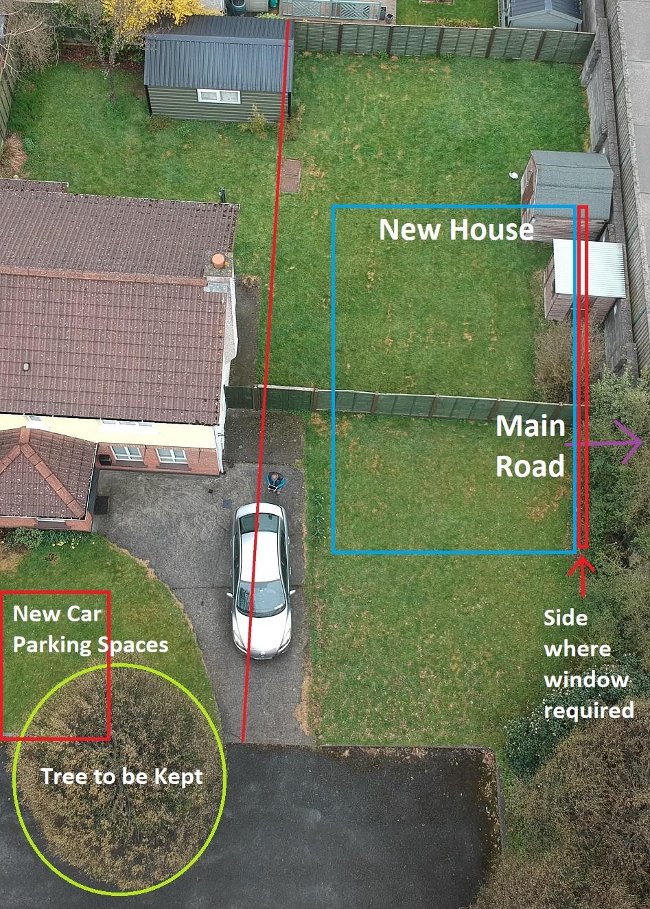

Hi,
I just got planning permission but there are two conditions I'm concerned about:
  • Revised plans indicating windows facing a main road in the interest of promoting passive surveillance
  • The existing tree to the front of the site shall be retained and protected, both above and below ground, from damage during construction works
The first relates to a decision I made to NOT have windows on one side of the house as at the weekend it's frequented at odd hours with late night revellers, late night buses letting people off and a nightclub up the road. All the bus stops on this road are now plexiglass instead of glass for years due to vandalism. My worry is of course my new house would be the closest of any house on that road and attractive to a stone being thrown or two. They say windows plural - I could put on in a glazed atrium for the living room / vaulted ceiling, would love to in fact but it will be too high up to see out of. Plus the existing house has NO windows on this side either! The bedroom would provide a window you could look out of but it would increase the traffic noise. Nothing may never happen but there's a pedestrian opening opposite into another housing estate and a pedestrian crossing beside that and groups of youths often congregate there. The cost of replacing a window cartridge and access to it after the build is done and scaffolding is down will be tricky.
The second relates to trees put down by the builder in the estate 20 years ago. They grow up and out (don't know the variety) and are often cut down after 20-30 years and replanted according to a local tree surgeon. The risk is I've to put in two new parking spots in the front garden of the old house nearby and the root system may be disturbed causing damage / loss of the tree. I don't see how I can protect against that without raising the level of the new parking spaces? Roots are 600mm below the surface I'm told and the parking spaces are right by the tree which is over 6 meters high. I can reinstate a mature tree if all fails but not sure the planners would be accept that.
Interested in thoughts if you'd had to have similar discussions with your planners and how to tackle these issues in a sensitive & appropriate way.
Thanks.
Edited by mike2016
added photo

Thanks - the tree protection was different to what I thought. I'm thinking about the roots which will be under the ground where the new car parking spaces are to go, the planners are more likely talking about the Heras protection quoted here. Good distinction to understand, Thanks!
I think the fact that the old house has no windows is a good case to point out along with some other things.....

Well, there's another house opposite a little further down the road with damage to their side window recently so I'm going to speak to them and see what happened. It might strengthen my case as their gable window is 7 meters from the wall, mine will be only 1. I'll have CCTV as a mater of course for my own protection but hoodies abound and it won't repair the damage. I can get bulletproof glass if I'm forced this way to at least limit the risk of damage but it will be interesting to see how this pans out.
The tree, well, I've to access underground services and put in two car parking spaces, if the root system gets damage and the tree becomes a hazard I'll have to take professional advice about site safety and do what's necessary.
Funny though - I'd love to keep the tree and I'd love a glass atrium window but the realities weigh against this......
