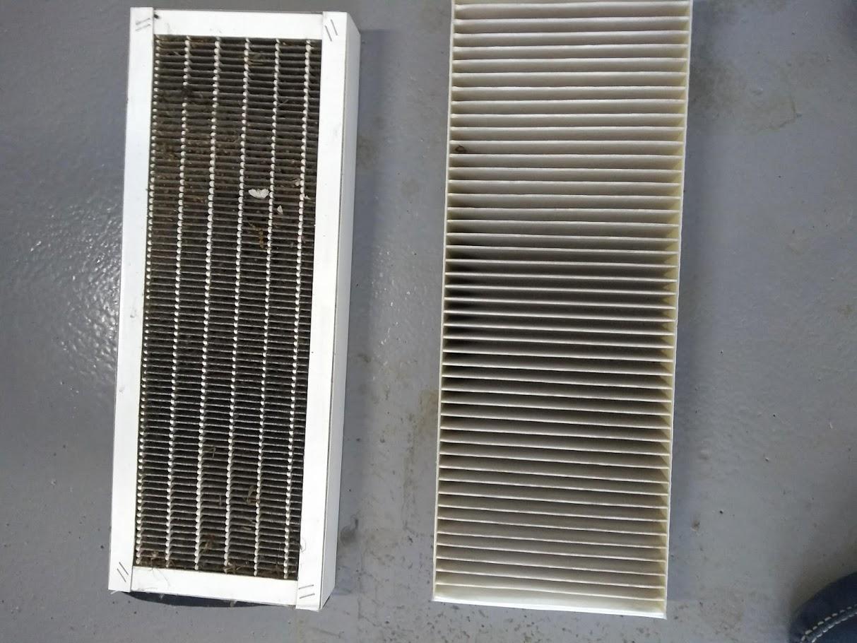

Jeremy Harris Posted July 2, 2018 Share Posted July 2, 2018 Well worth doing. I've been changing the intake filter every six months, but have noticed today (as it's very hot again) that the house cooled down very quickly after I'd changed the filter (our MVHR has a built-in air-to-air heat pump, so in hot weather it pumps cold air into the house like an air con system). Looking at the filter I took out it's very clogged indeed after just six months of use, so I'm guessing that it probably needs changing more frequently. As these filters are expensive, even when bought in quantity from a cheaper supplier (I use Jasum Envirocare) I'm seriously investigating getting a re-usable metal frame made up so I can use much cheaper washable foam filters. Right now I'm sitting here designing a metal or plastic frame to fit the MVHR that can take a reticulated foam filter, as you can buy large sheets of that sort of filter foam relatively cheaply and it's easy to wash clean. Link to comment Share on other sites More sharing options...

Gone West Posted July 2, 2018 Share Posted July 2, 2018 4 hours ago, JSHarris said: As these filters are expensive, even when bought in quantity from a cheaper supplier (I use Jasum Envirocare) I'm seriously investigating getting a re-usable metal frame made up so I can use much cheaper washable foam filters. Right now I'm sitting here designing a metal or plastic frame to fit the MVHR that can take a reticulated foam filter, as you can buy large sheets of that sort of filter foam relatively cheaply and it's easy to wash clean. I tried Jasum Envirocare but the salesman was hopeless. He quoted a price for five sets of filters including VAT and then went back on it saying it was excluding VAT. The new price ended up virtually the same as Total Home Environment, so I bought them there. I've contacted a lot of places but couldn't find anywhere significantly cheaper. I am also thinking about getting a metal frame and fitting my own filter medium. Link to comment Share on other sites More sharing options...
HerbJ Posted July 2, 2018 Share Posted July 2, 2018 I have used Tops Filters www.topswtwfilters.nl . They are in the Netherlands but their service is pretty good. I have been changing inlet filters every 100 days but the extract filter stays relatively clean and doesn't need changing for a year or more . I use a F7 filter in the inlet and G4 in the extract. The inlet filters look exactly the same after 100 days as the photo posted by @JSHarris Link to comment Share on other sites More sharing options...

HerbJ Posted August 15, 2018 Share Posted August 15, 2018 I changed my MVHR inlet filter, which is a G7 pollen filter, today after 100 days. I didn't change the extract filter , which is an F4 filter, and has been installed for about 9 months or so. - but it getting a little dirty - main reason, I didn't have a spare F4 filter to make the change...... See picture of inlet (LHS) and extract filter (RHS) The inlet filter is the dirtiest condition that I have seen it after 100 days. It may be because we normally only run the MVHR at the lowest setting but with the very hot temperature in the past 2/3 months we have been running at the higher setting, continuously to get some minimal cooling effect, especially at night. So, if any of you have been doing something similar, it may be worth checking the condition of your inlet filter! Link to comment Share on other sites More sharing options...
lizzie Posted August 15, 2018 Share Posted August 15, 2018 I am using G7 and changing every 30 days in this hot weather. I have a hay field next to me and it is just dust. Think thats why mine are getting so bad. I am changing the extract less often but still more than yours partly because I have had to have the windows open so much due to the overheating and the place gets full of dust. Its windy here and it blows in. I have room filters on all extract and intake outlets too and they are getting filthy but I wash those! Link to comment Share on other sites More sharing options...
